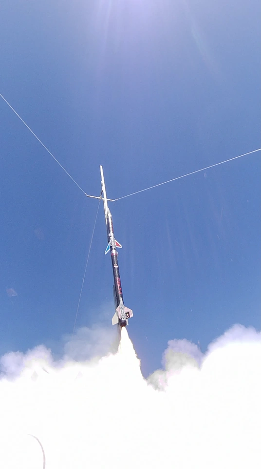

Super stiff tied down rail

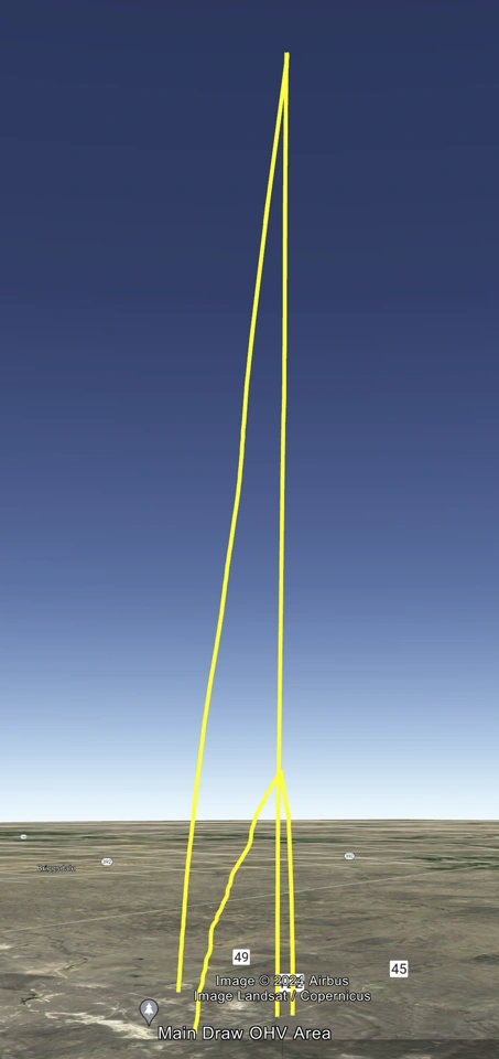

GPS track
Turns out, the launch rail wasn't stiff enough and caused the rocket to tilt over 24 degrees, preventing the computer from firing the upper stage. I borrowed a launch rail from the Utah University rocket team, and the subsequent launch was dead straight with the upper stage only 2 degrees from vertical. The rocket flew to a new personal record of 5km and a near 2000 km/h (Mach 1.63).

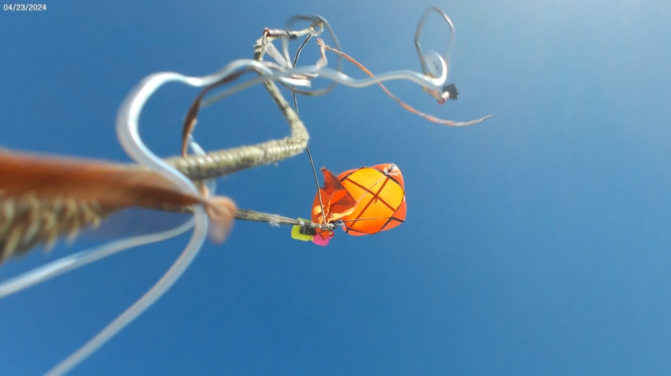

Rocket under drogue parachute

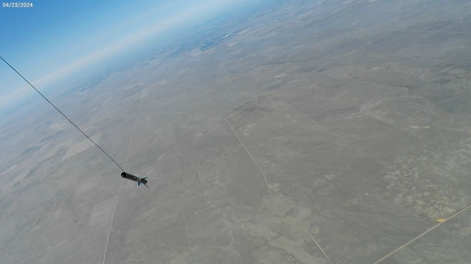

Kadet at 16,300 feet !!!

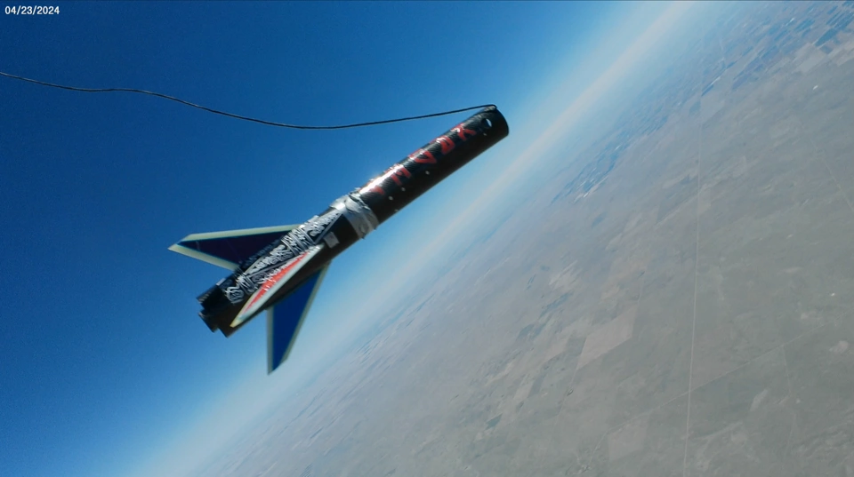

The onboard photo shows the rocket at its maximum altitude! This project is now completed. For the next project 3D_BabyStratos, a new ultra-minimalistic rocket will fly over Mach 2 to 55,000 feet (17km) into the Tropopause, the region of the atmosphere between the lower Tropopause and the Stratosphere.
