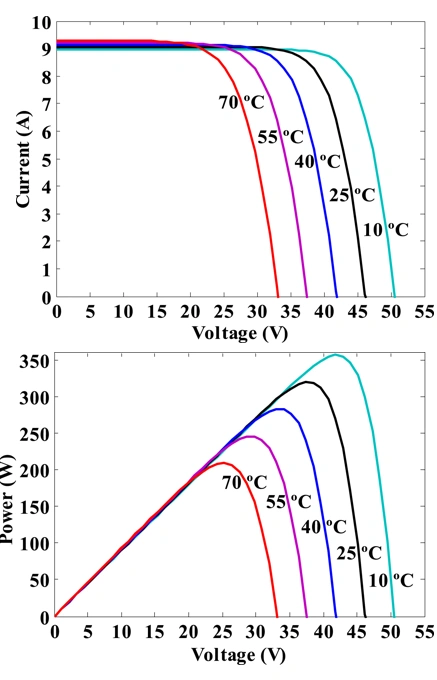

Temperature effect on PV solar module
The temperature demonstrates a significant effect on the output performance curves of PV solar modules when irradiance intensity is kept constant. A minor variation is observed w.r.t 1000 W/m2  when the temperature varies from 10 °C to 70 °C. The voltage shows an increasing trend in I–V performance curve when the atmospheric temperature reduces. Also, the solar cell generates more power, when the atmospheric temperature reduces. Thus solar cell shows an inverse relationship with temperature.
Thus, this work aims to reduce the maximum temperature of the solar panel by optimizing the thermal performance of a passive heatsink using optimization algorithms.

Irradiance effects on PV solar module
The effect on solar PV model I–V* and P–V α characteristics curves are depicted in the figure by varying the intensity of irradiance from 200 W/m2 to 1000 W/m2 at a constant temperature of 25 °C. It is observed that the current remains constant with rising voltage up to 30 V after which it decreases. Moreover, the current increases while increasing the irradiance intensity. This demonstrates that irradiance has a substantial effect on short-circuit current, at the same time open circuit voltage is quite low. The maximum power evidence exists on power performance curves. The generation of power by solar PV model is increased by increasing the intensity of solar irradiance.

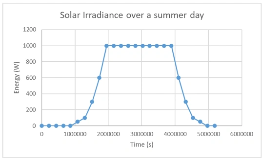

A.The solar irradiance on a solar panel can be depicted be the following curve:
3.Film Coefficient is 5W/m2
4.Acceptable surface temperature upper limit is 330-350 K.

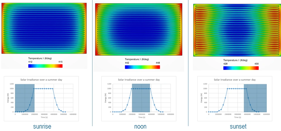

Results of Transient transfer
It can be observed that the temperatures exceed the optimal temperature limit i.e. 330 K when subjected to time variable heat flux. Thus optimizing the shape and geometry of the heat sink is quintessential for the optimal cooling of the Solar panel, thus ensuring highest efficiency

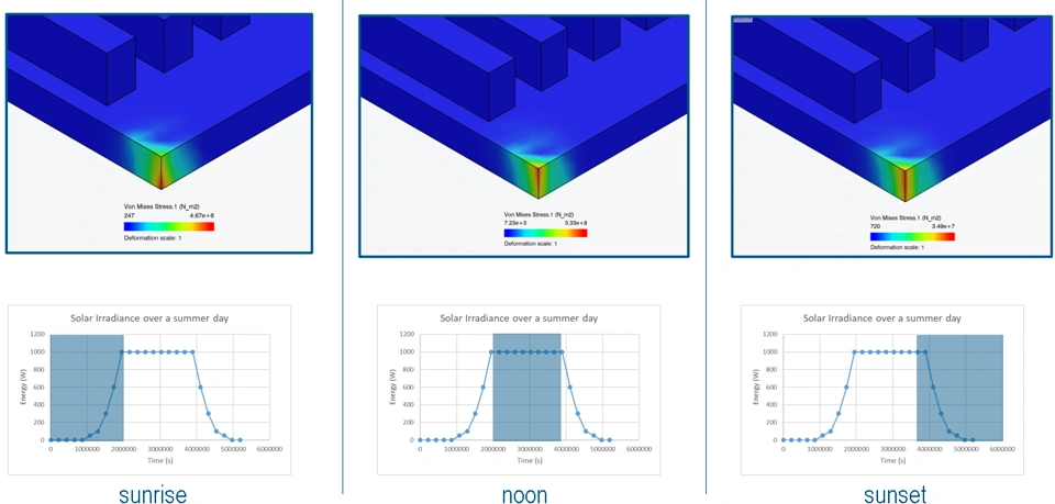

Results of Von Mises stresses due to Transient Heat Transfer

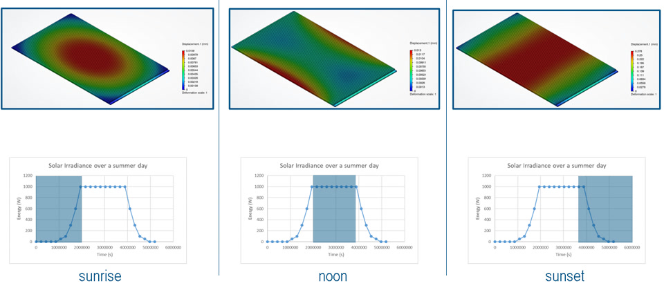

Results of displacement due to Transient Heat Transfer

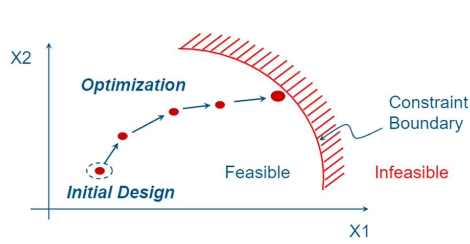

The optimization technique used in this study is MISQP
• MISQP - Mixed Integer Sequential Quadratic Programming
• Branch and Bound Integer search Problem and Design Space:
• Well-suited for highly non-linear design spaces
• Well-suited for   problems with integer and Boolean variables
• Well-suited for long-running simulations Gradient-based
• Exploits the local area around the initial design point
• Uses branch-and-bound for integer variables
• Rapidly finds a local optimum design
• Handles inequality and equality constraints directly
This method builds a quadratic approximation to the Lagrange function and linear approximations to all output constraints at each iteration, starting with the identity matrix for the Hessian of the Lagrangian, and gradually updating it using the BFGS (Broydon-Fletcher-Goldfarb-Shanno) method. On each iteration, a quadratic programming problem is solved to find an improved design, until the final convergence to the optimum design.

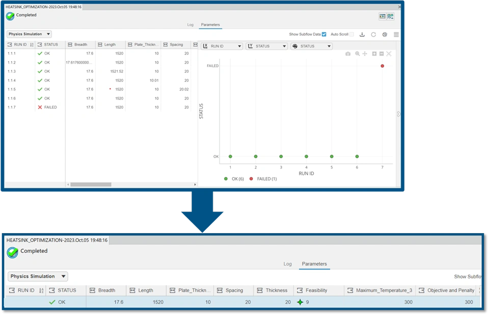

It can be observed that the optimization study using the MISQP algorithm minimizes the objective function to get the maximum temperature to come down to 300K.

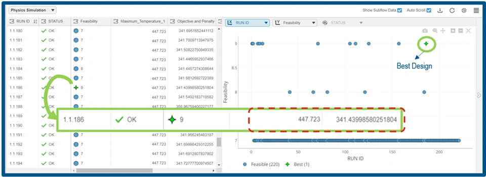

Multi-Objective Shape Synthesis of passive heatsink using archive-based micro-genetic algorithm
  • The objective of this optimization study is to lower the maximum temperature of the solar panel while also decreasing the amount of material needed for the manufacturing of the heatsink.
  • Therefore the parameter “thickness” has also been added as an objective to be minimized with the previous objective, Max. Temperature.

It can be observed that shape synthesis using AMGA ran for 220 iterations and the 186th iteration came out to minimize the objective function of the temperature to be 341.439K with the thickness of the heatsink increased to 13.69mm.
