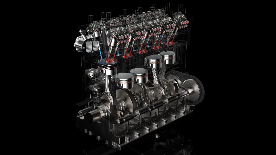

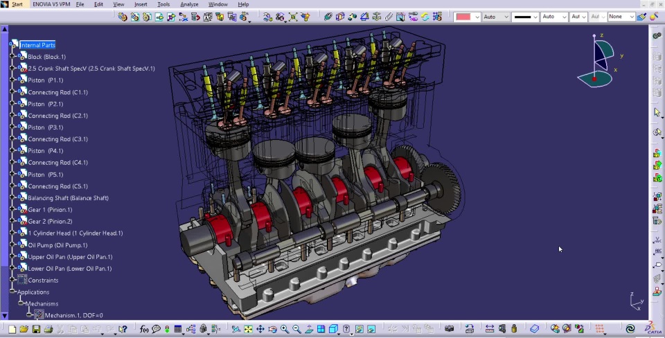

2.5 CLTT
This name refers primarily to the fact that it is an internal combustion engine with a capacity of 2500cc [2.5] which has 5 cylinders arranged in line, but the evolution of this engine is the gas distribution system, the classic system is completely replaced with a CAMLESS gas distribution system [CL]. Finally [TT] symbolizes the new supercharging system of this internal combustion engine which consists of two turbochargers mounted in parallel but at the same time independent on each gallery of a single cylinder.

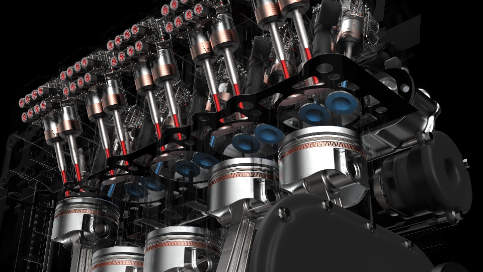

What is CAMLESS?
A camless or free-valve piston engine is an engine that has poppet valves operated by means of electromagnetic, hydraulic, or pneumatic actuators instead of conventional cams. Actuators can be used to both open and close valves, or to open valves closed by springs or other means.
Our CAMLESS system
Consists of an Electro Hydro-Pneumatic actuator which is individually mounted on each intake or exhaust valve of the internal combustion engine allowing the operation of the valve opening-closing time, valve timing and valve lift (full valve control) to maximum due to the electronically control via a computer.

This project was design using both CATIA V5 and 3DExperience platform.
