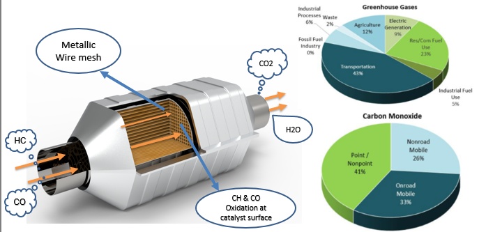

Considering the pollution from automobile sources our project majorly focuses to prepare Tio2 based catalytic converter to reduce emission of CO and HC and also the design of metallic monolith .

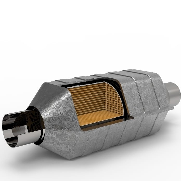

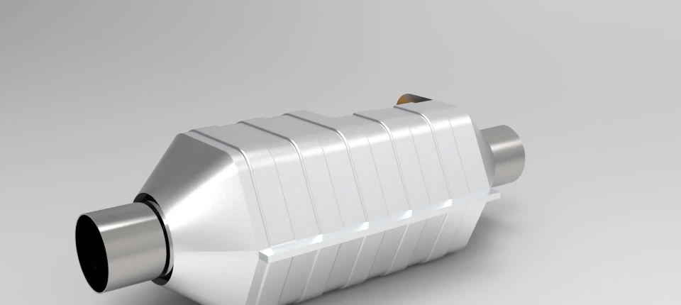

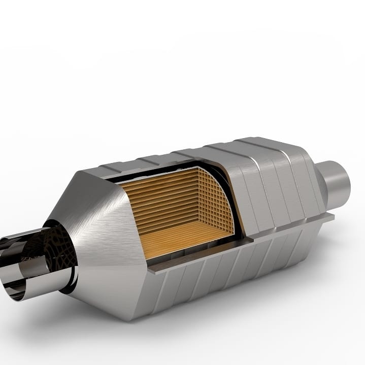

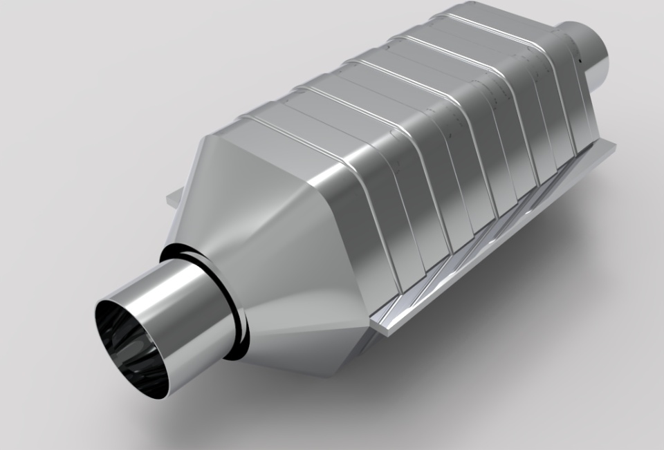

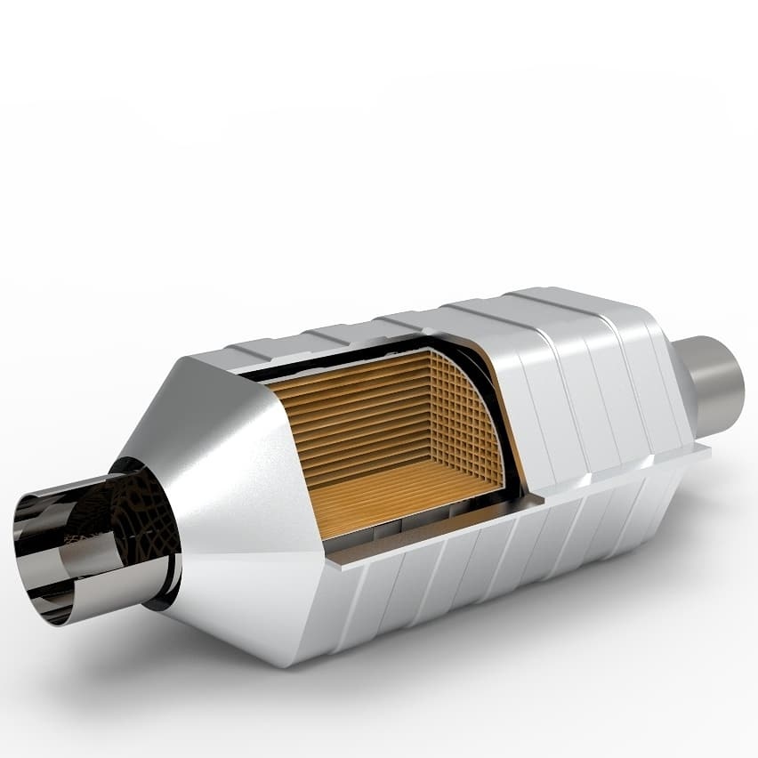

For design consideration and calculations an Engine - 19L232 -0054G1 model with 305 cc displacement , horse power -10 hp and factory set RPM of 3800 was taken . Calculations for shell dimensions , volume flow rate and catalyst volume was done which came out to be 220mm , 29.20mm^3/hr and 0.00176m^3 respectively .
CFD Analysis is done to determine optimum cone angle (45 degrees here, inner substrate cylinder
) for uniform pressure distribution and reducing back pressure and less consumption of fuel.
Chemical slurry preparations will be done using molar concentrations of Na2SiO3 , TiO2 and Na2S2O5.
After the slurry is prepared it will be coated on the wire mesh and then undergo drying and calcination to be evenly coated on the wire mesh . After the wire mesh is dried it will be placed in cylindrical substrate and the outer casing will be placed , outer casing has been given small rectangular groove for preventing excessive heating and maintaining optimum working temperature .
