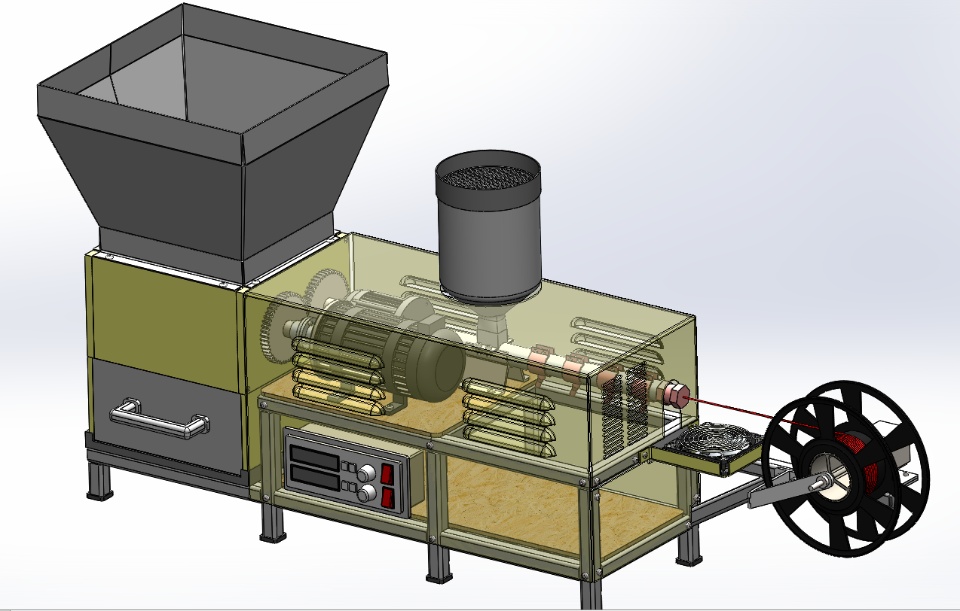

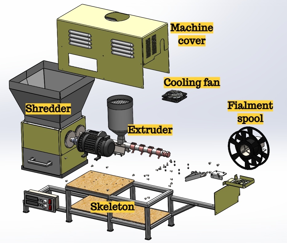

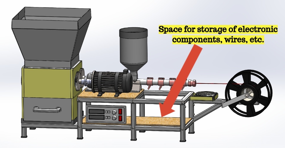

Now, moving on to the design of the machine, it has 3 main subassemblies.
1. Shredder
2. Extruder
3. Filament spool winder

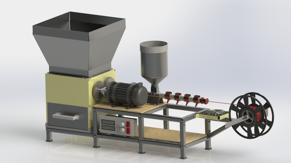

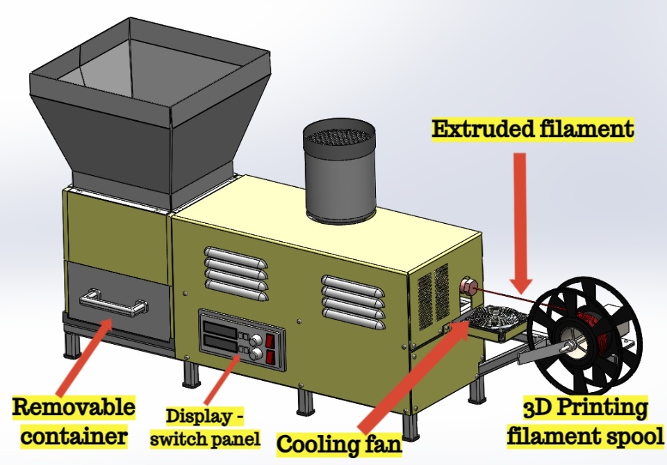

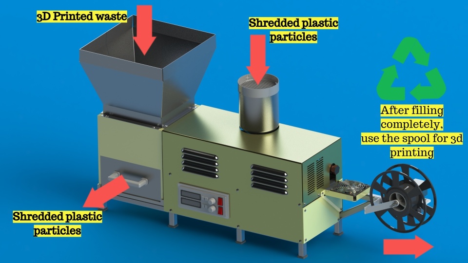

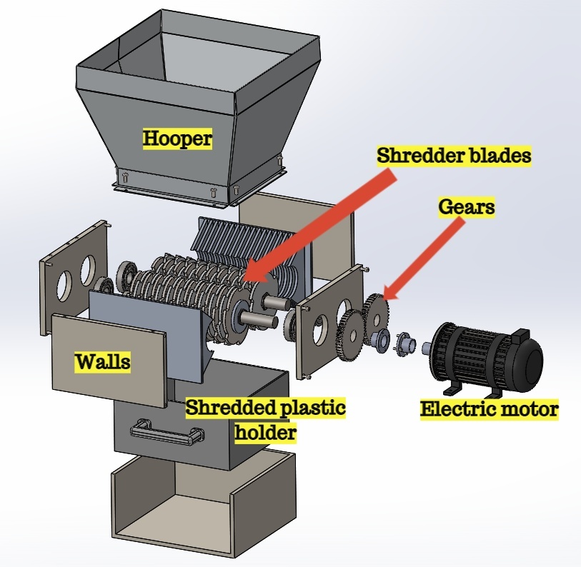

The shredder is basically used to shred the 3d printed waste and make fine granules out of it. We have to put the 3d printed waste into the shredder Hooper (big Hooper) on the machine. The shredded material will be collected into the removable collector placed below the shredder. This removable container is designed in such a way, that it can be removed, and the shredded material can be again put into the shredder, in case we do not get fine and uniform particles after shredding. Oftentimes, the material does not get shredded perfectly the first time. So, we can re-shred the material, until we get a fine set of particles.

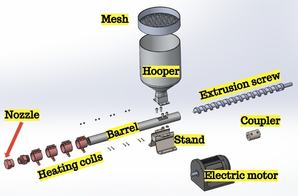

Now, we will put those granules into the extruder Hooper present on the machine. This extruder is the smaller one with a cylindrical shape. It has a mesh above it, to allow only fine particles less than 3*3mm in size. This will make it easier to melt the particles, as bigger particles do not easily melt and this can hamper the quality of the extrusion. After that, the extrusion process will start, and the filament will start to melt by the heat from heating coils present outside the barrel. The extrusion screw, with the help of an electric motor attached to it, will push the filament forward with applying pressure. At the end of the barrel, the extrusion will come out from the nozzle. The nozzle has a hole of 1.75mm diameter, which is the standard diameter of the 3d printing filaments.
The extrusion will then be cooled down with the help of the cooling fan, and finally, the filament will be wound on a filament spool used for 3d printing, by constantly rotating the spool with a stepper motor.
This process will go on slowly for some time, and when the spool becomes full, take it out and use it for 3d printing!

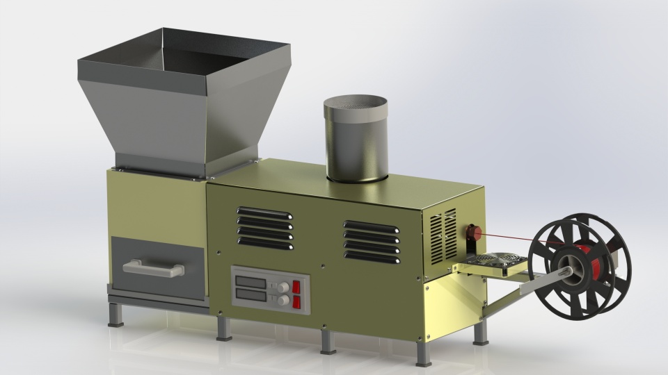

The sheet metal covering of the machine is designed in such a way, that it will be easy to remove it from the top and reassemble it. Proper air circulation for cooling of the inner components is provided on the covering, by designing vents.
The bottom portion of the skeleton of the machine will be utilized to store all the electric components, display, and switchboard, wires, etc. All of this portion will be covered by the outer sheet metal covering.
The spool can be easily removed and replaced by just fitting it on a spool holder, which will then wind up the spool.
With the help of the display and switchboard, we will have control of various settings in the machine. The displays will display the temperature of the extruder and the extrusion speed. We can adjust the temp, extrusion speed, the winding rate of the filament with the help of knobs and switches. There are also 2 power switches, for the shredder and the extruder assembly power supply.
Lastly, this design of the 3D printing waste recycling machine had applications of various designing types like weldments for the designing of the skeleton, sheet metal for designing of the machine cover, and the cooling fan holder, part designing for a number of components, etc. The animations, simulations, and Photoview 360 rendered images were also used for making this project. This project design was made, utilizing most of the functionalities that Solidworks provide.
