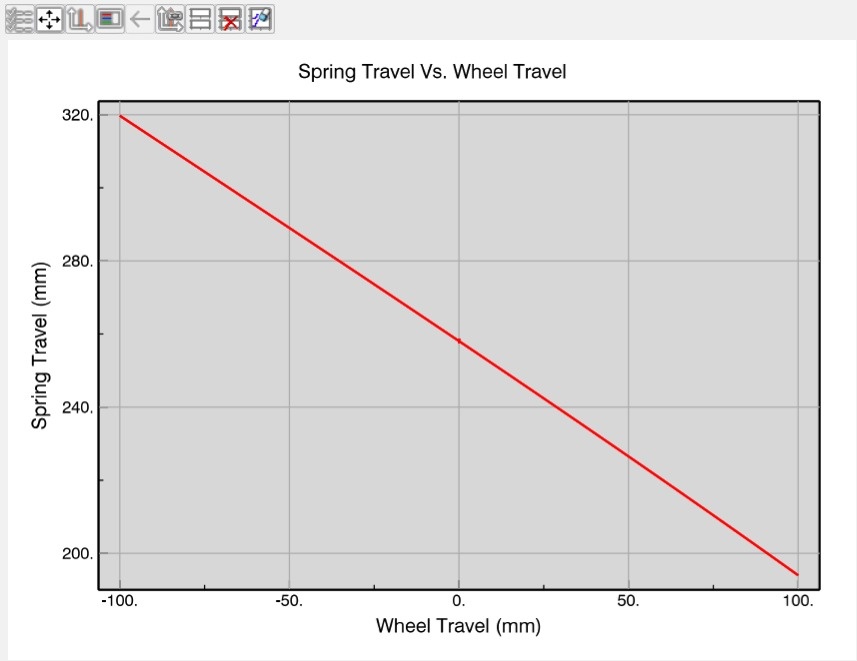

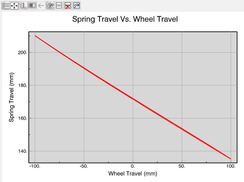

The above readings were taken using Bump/Droop Model in Dymola Behavior Modelling app. The mathematical calculations were verified by the results obtain from Dymola Behavior Modelling app. The graph obtains between Spring Travel Vs. Wheel Travel for both front and rear suspensions are shown below:
Graph 1 Front Spring Travel Vs. Wheel Travel
Graph 2 Rear Spring Travel Vs. Wheel Travel

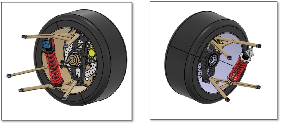

Figure 1&2: Front and Rear Suspension Assembly
The above figures 1 and 2 shows CAD Modelling of front and rear suspension assembly along with spring and damper assembly which was created in CATIA Part Design app and Assembly Design app.
