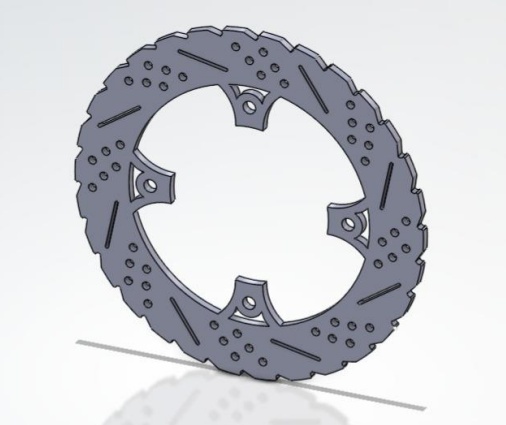

We chose to design a drilled and slotted type of brake rotor as dust, gas, moisture, and heat can all escape from brake rotors with holes and slots more easily, ensuring that the brake pads make good contact with the rotors. Extra security and durability are provided by the combination of a brake rotor with a slotted surface that maintains cleanliness and a drilled brake rotor that operates cooler.
The brake disc rotor is designed in SolidWorks software with a drilled and slotted structure with an outer diameter of 220 mm and an inner diameter of 151.78 mm.
Fig. 1 Brake Disc

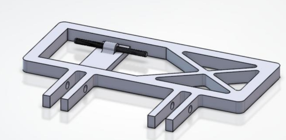

The brake pedal and pedal box are also designed in the SolidWorks software.
Fig. 2 Brake Pedal
Fig. 3 Pedal Box
