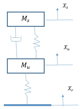

The quarter car suspension model is a simplified representation used in automotive engineering to analyze vehicle suspension systems. It's called "quarter" because it considers only a quarter of the vehicle's suspension system. It divides the vehicle into four components: the sprung mass (vehicle body and occupants), the unsprung mass (wheels and part of the suspension), a spring (representing suspension stiffness), and a damper (representing shock absorption). This model helps engineers study how the suspension responds to road inputs, enabling optimization of ride comfort, vehicle stability, and handling.
Fig 1. Quarter Car Suspension model

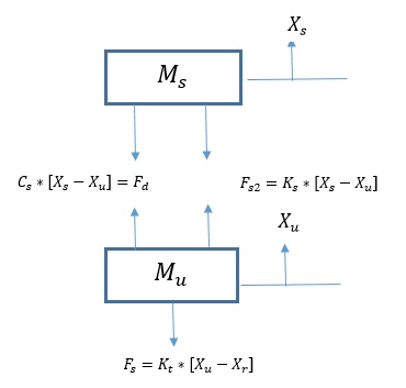

 Fig. 2. Free Body Diagram of Quarter Car Suspension Model
In the Free Body Diagram of Suspension Model force by Spring is, force by Damper is and tire stiffness force is denoted by . By using Newton’s Second Law of Motion all forces are equated and two separate equations are formed for sprung and unsprung mass.
