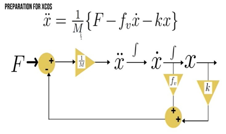

Here, I have developed the model of spring–mass-damper system in the Xcos. Initially we have a mass M which is attached to the spring (k) and damper(fv) and after applying force (F) it makes x displacement. For making the model in Xcos we have to make a transfer function in s-domain. After applying Newton’s Laws of Motion and Laplace Transformation Law we got the final equation as
After transferring the equation in the time domain we got the equation and made a diagrammatic representation of the Transfer function.

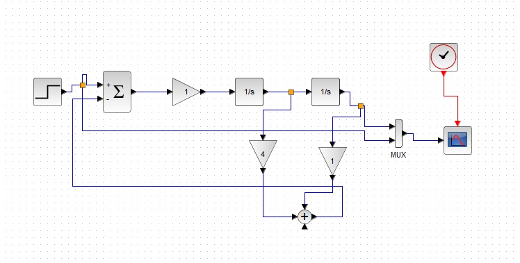

For making this model in the Xcos we have added 2 Integrals, 1 step function for source, 1 sink(CSCOPE) and for display 1 clock blocks, 1 Mux for signal routing such that we can get two signals at a time,3 Gain blocks for 3 constants. After arranging all blocks we made the following model.

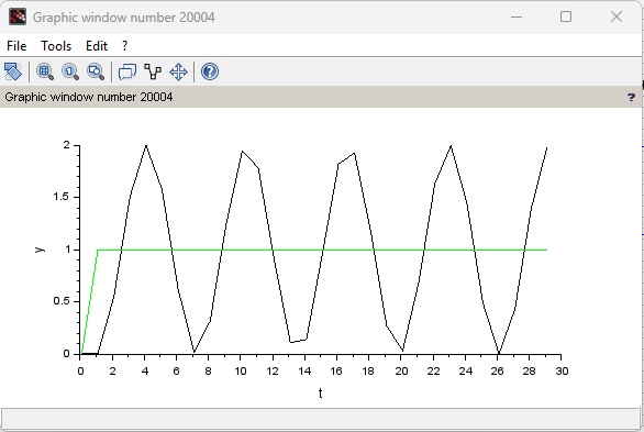

Output 1: Undamped (for Damping Coefficient = 0)

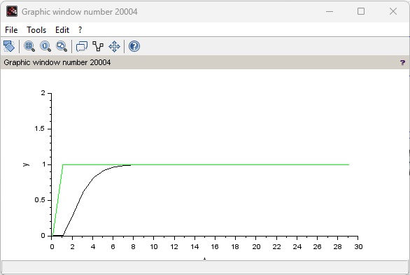

Output 2: Critically damped (for Damping Coefficient = 2)

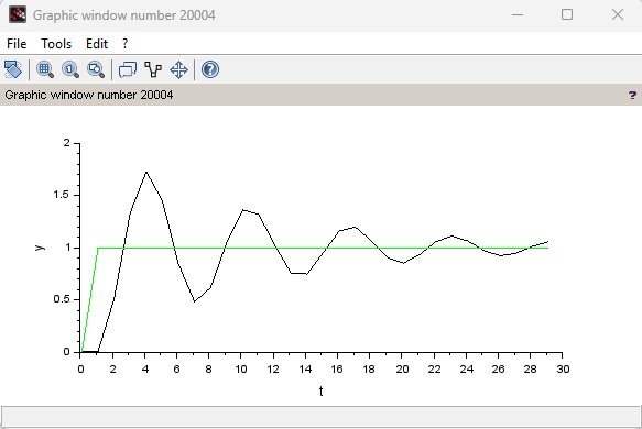

Output 3: Underdamped (for Damping Coefficient = 0.2)

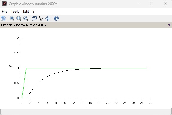

Output 4: Overdamped (for Damping Coefficient = 4)
