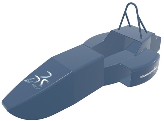

For this project, we are using CATIA Part Design ​​​​​​​ for CAD Modelling, Dymola Behaviour Modelling ​​​​​​​ for mathematical modelling, and the ENOVIA Project Planning  app to schedule the various tasks and allot them to different members of our group. We are supposed to follow all the latest FSAE rules while designing. Following is the image of the Chassis/Body Representation which we are using for reference, to base our designs on.
Chassis

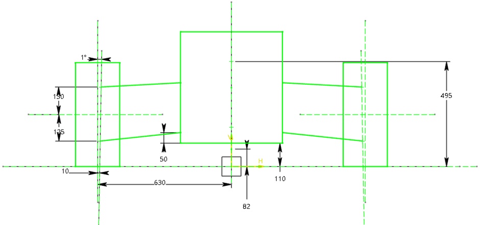

The first step in this design process is to decide the initial geometry for which iterations have to be carried out. To start with, we have to determine some initial hardpoints on the provided chassis. Hardpoints are the locations where suspension connects to the chassis. These are the locations on the chassis of a car that are designed to carry both internal and external loads. Initial hardpoints can be obtained by drawing some basic 2D sketches.
For example, we have made a simple 2D sketch of the front suspension system in CATIA Part Design and from this sketch initial hardpoints are determined. Following is the sketch of the front suspension system.
2D Sketch of Front Suspension System
