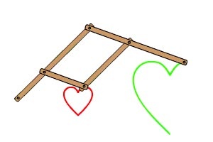

A pantograph is a linkage made up of five links joined together using pin joints to generate revolute pairs. It is linked in a parallelogram-based fashion so that the movement of one point in tracing an image causes identical motions by the second point. A pantograph is used to duplicate the path represented by a particular point at an enlarged or reduced size and as precisely as feasible. If a line drawing is traced by the first point, a pen attached to the other will create an identical, expanded, or smaller replica.
Different types of pantographs are used for other types of duplication in disciplines such as sculpture, minting, engraving, and milling, all based on the same idea. Because of the original device's shape, a pantograph also refers to a type of construction that may compress or extend like an accordion, generating a distinctive rhomboidal pattern. This is found in wall-mounted mirror extension arms, temporary fences, pantographic knives, scissor lifts, and other scissor systems like the pantograph used on electric locomotives and trams.
                                Illustration of the Mechanism

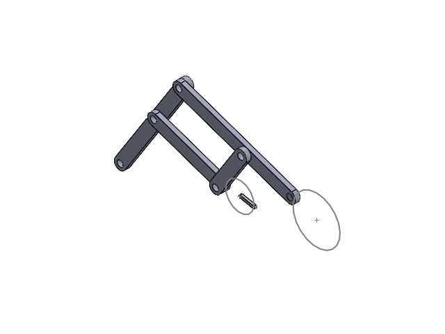

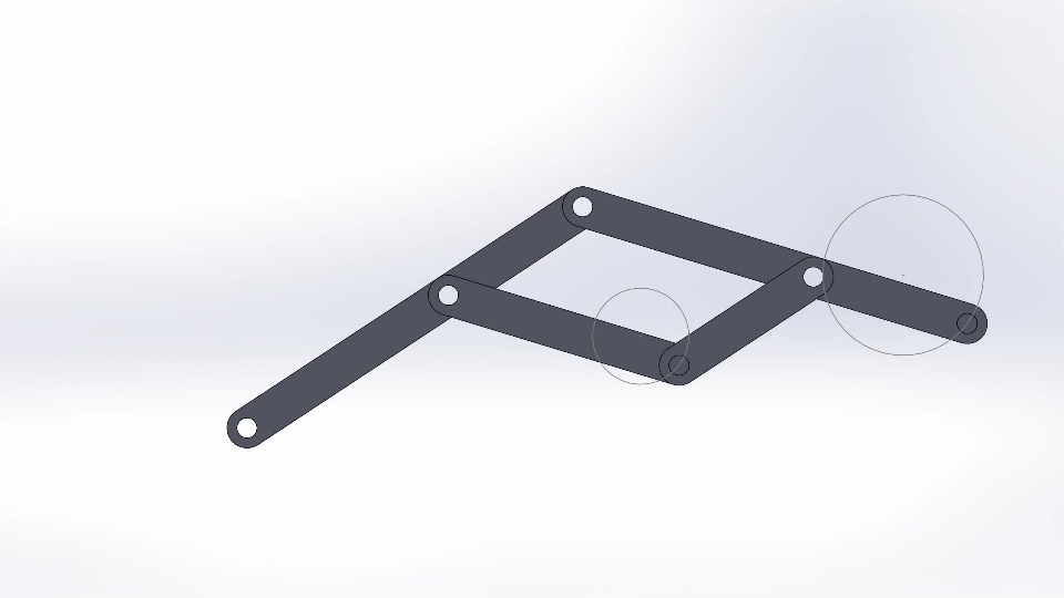

Construction of the Mechanism
The construction is based on the number of links we're implementing. Usually, it requires a minimum of four links to make the mechanism.

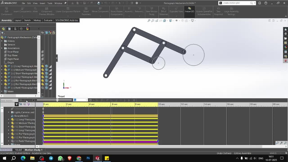

                         Pantograph Mechanism using SOLIDWORKS
