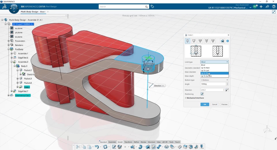

  • A Solid Body is an autonomous entity in which a user can create features, as usual I will say, but without “impacting” other Solid Bodies.
  • Boolean operations are then available in order to operate Solid Bodies between them. Are available in Part Design: Add, Remove, Intersect, Assemble and Union Trim operations.

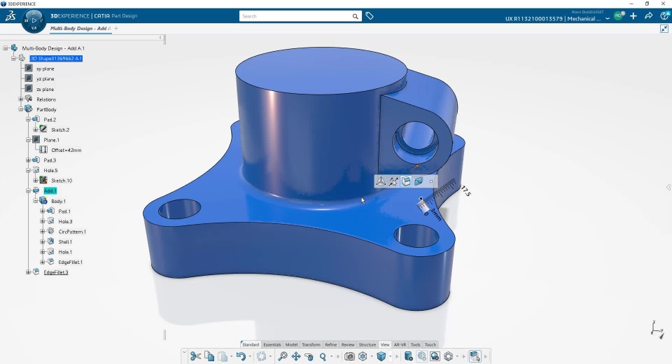

Add
Add the geometry of the selected body to another one

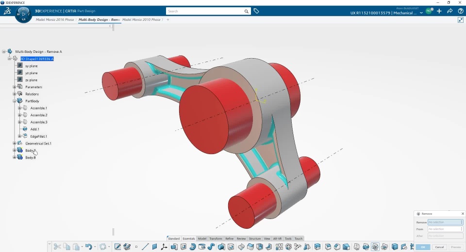

Remove
Remove the geometry of the selected body to another one

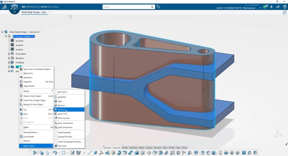

Intersect
Create the intersection of the geometry of the selected body with another one

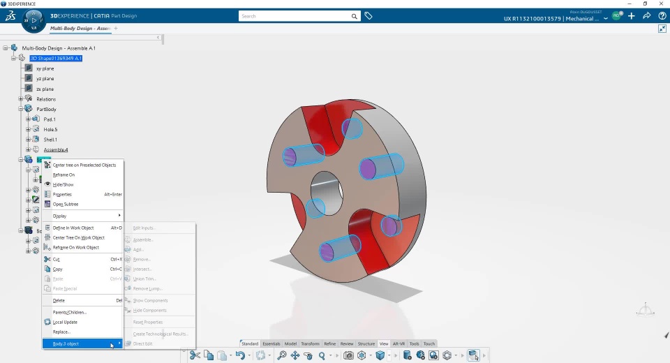

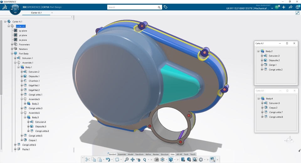

Assemble
Depending on the polarity of the body:
  • Add the geometry of the selected body to another one if the first feature of the selected body is a positive one (such as Pad, Shaft, Rib, etc...)
  • Remove the geometry of the selected body to another one if the first feature of the selected body is a negative one (such as Pocket, Groove, Hole, etc...)

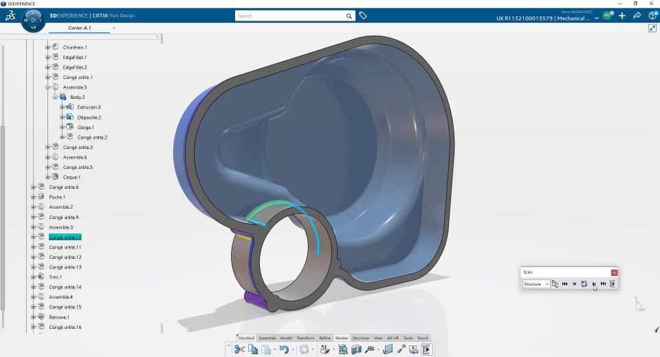

This boolean operation is very useful when, for manufacturing reasons, user wants to create one (or several) body(ies) containing feature which remove material.

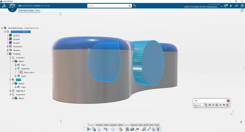

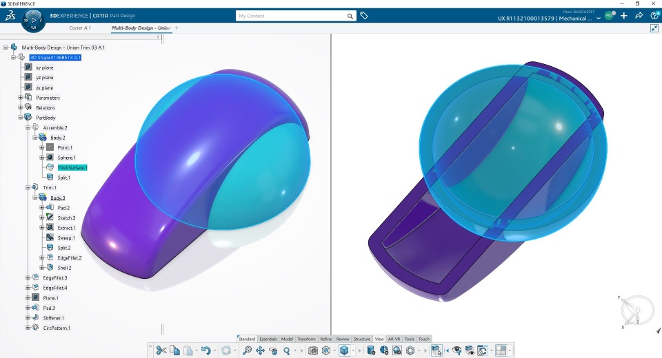

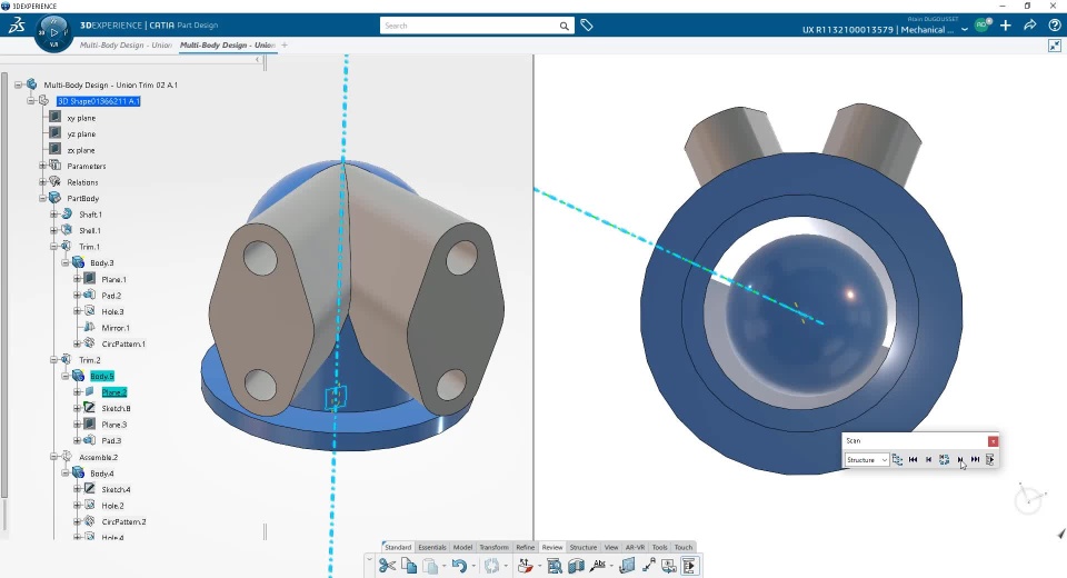

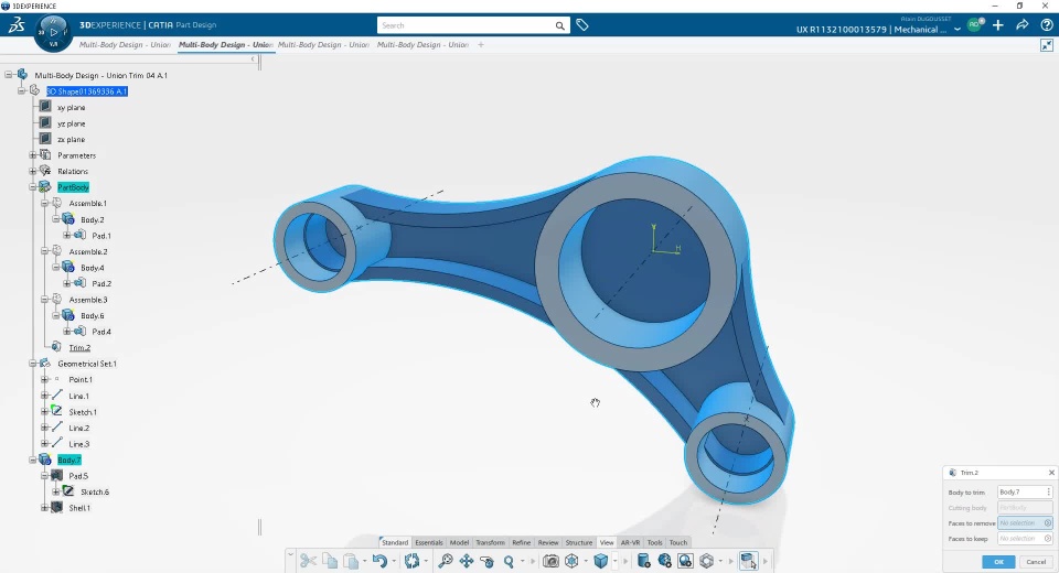

Union Trim
Merge the geometries of Solid Bodies allowing the users to specify which area(s) has(ve) to be kept or removed.
I really like this powerful capability, which allows the user to easily create complex geometries.
