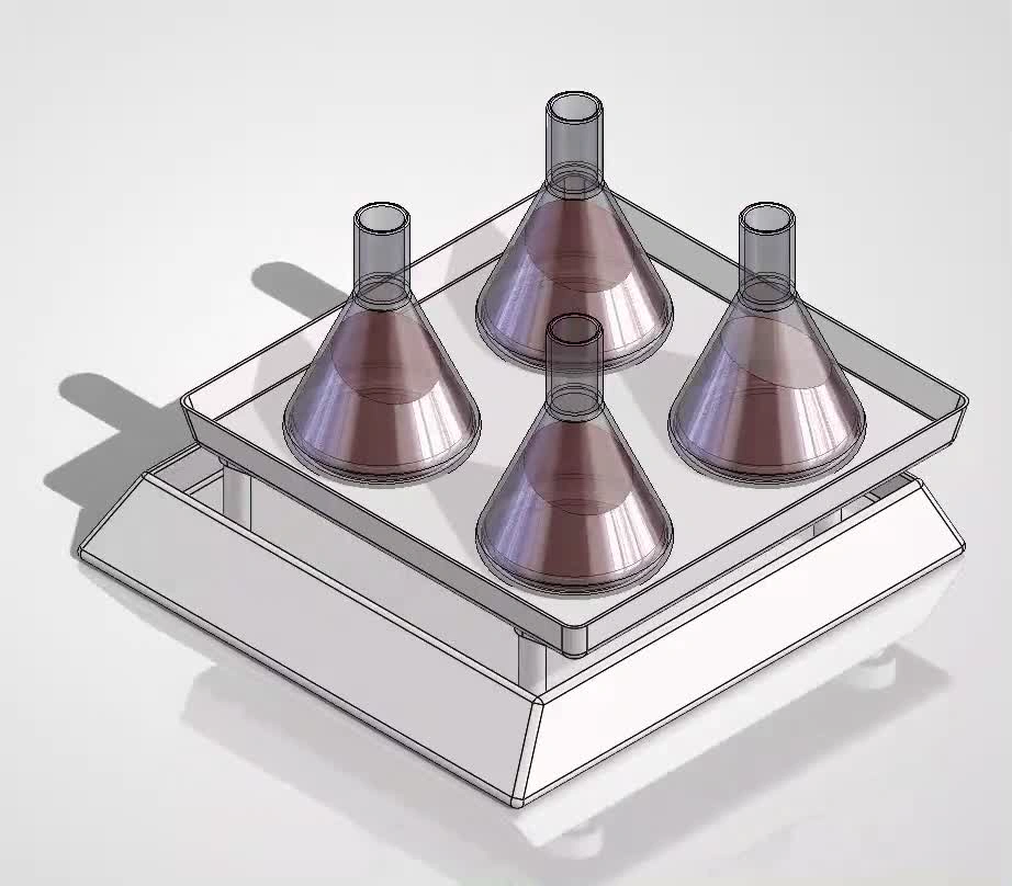

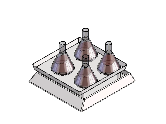

Hello Everyone 👋 , Welcome Back to Motion Monday. Unlike simple rotation, the platform follows a circular orbital path while maintaining a constant orientation. This is achieved by converting rotary input into orbital motion using an eccentric (offset) drive. |
⚙️ Key observations from the motion analysis:
- The platform center traces a fixed-radius circular trajectory
- No self-rotation of the platform ensures stable sample positioning
- Orbit radius and angular speed directly govern mixing intensity
Velocity remains tangential, with continuous direction change across the cycle
This controlled motion enables uniform mixing while minimizing spillage and instability.
