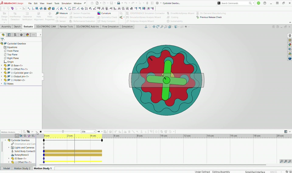

For this study, I modeled and simulated a single-disc cycloidal gearbox in SOLIDWORKS Motion Analysis to understand how the theoretical reduction ratio compares with the actual kinematic response.
🔹 Configuration
• Fixed ring with 11 pins
• Cycloidal disc with 10 lobes
• Single-disc design
• Eccentricity: 15 mm
• Input speed: 60 RPM
• Simulation time: 5 seconds

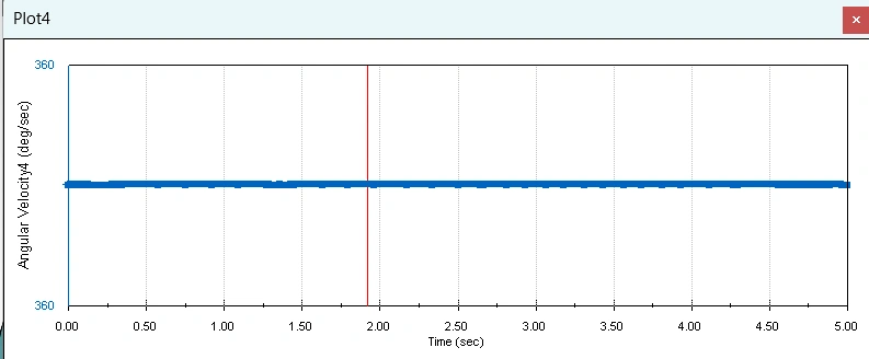

✅ Input angular velocity remained constant at approximately 360 deg/s (60 RPM)

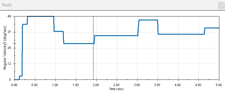

✅ Output angular velocity averaged approximately 35.5 deg/s (5.9 RPM)

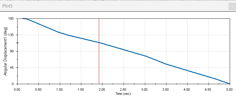

✅ Output displacement reached approximately 180° over the 5-second simulation
The simulated results closely matched the theoretical prediction, validating the gearbox geometry and kinematic behavior.
🔍 Interesting Observation
While the average output speed matched the expected 10:1 reduction ratio, the output velocity was not perfectly constant. Small cyclic fluctuations were observed throughout the motion due to the cycloidal engagement mechanism and changing load transfer between contact points.
This highlights one of the unique characteristics of cycloidal drives: the output motion is generated through a complex orbital movement rather than conventional gear tooth meshing.
