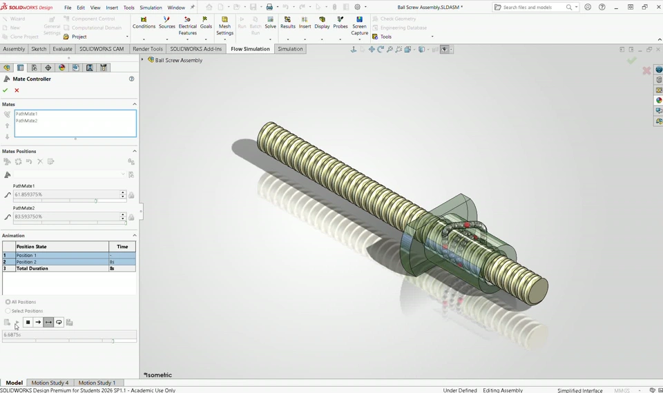

So instead of running a full motion study this time, I used Mate Controllers — which is basically the engineering equivalent of telling your assembly:
“Alright… you start here. Now go there.”

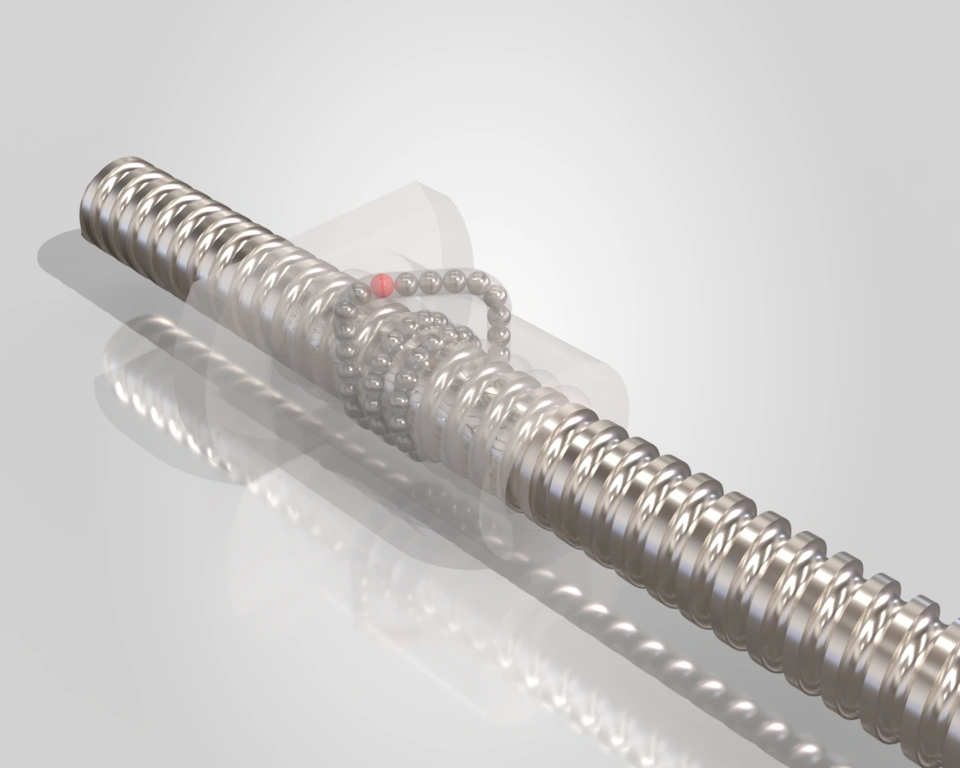

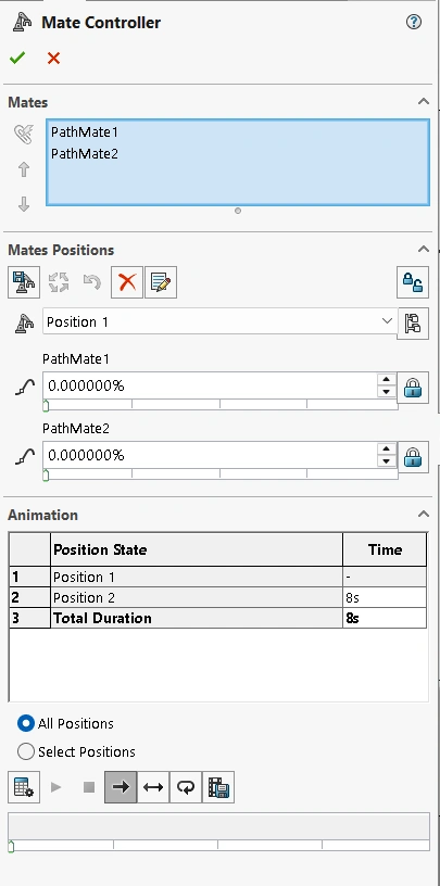

For this experiment, I built a ball screw assembly,
  • A ball screw is a high-efficiency mechanical actuator that translates rotational motion into precise linear motion using recirculating ball bearings between a threaded shaft and a nut.
  • By utilizing rolling ball bearings instead of sliding friction (as found in lead screws), they achieve high mechanical efficiency, often exceeding 90%.
  • These devices are known for their high precision, high load capacity, and durability, making them ideal for robotics, CNC machinery, and automation.
  • The system usually consists of a screw shaft, a nut with a return mechanism, and balls, providing minimal friction and low backlash for repeatable positioning.

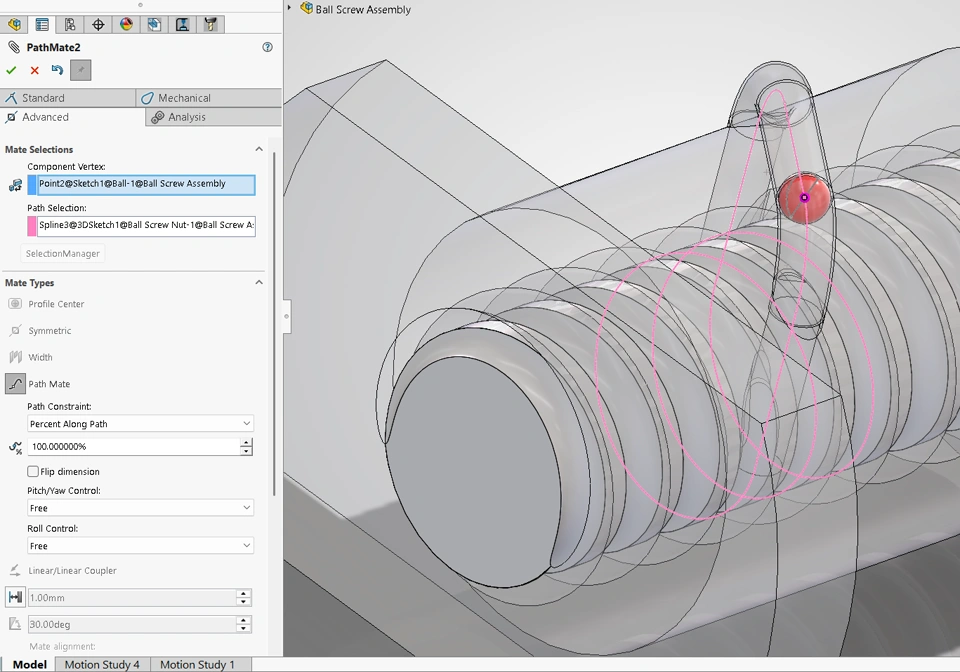

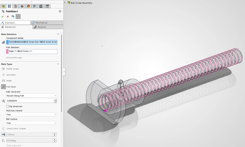

To demonstrate this, I used two path mates:
one controlling the nut moving along the screw, and another controlling the balls moving along their recirculation path.

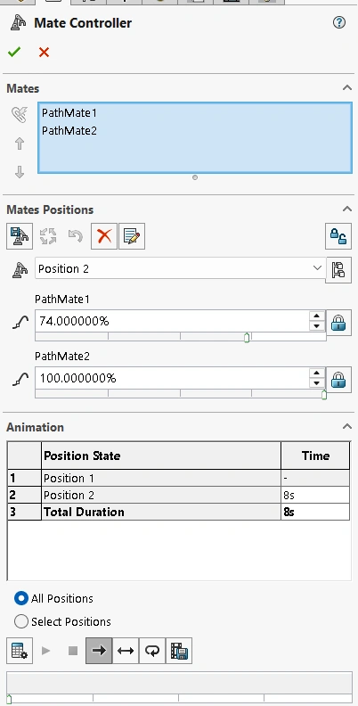

Both of these mates were then controlled using a Mate Controller with two positions.
In the first position, both the nut and balls start at 0% along their paths.

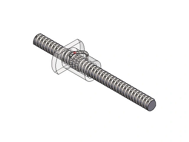

In the second position, the nut moves to 75% along the screw while the balls complete a full loop at 100%, showing how the nut advances while the balls keep circulating inside the mechanism.
Which means the balls are basically doing endless laps inside the nut while the system operates.
It’s a simple setup, but it’s a neat way to visualize how the different motions inside a ball screw mechanism work together — without setting up a full motion simulation.
