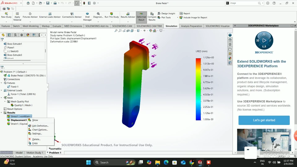

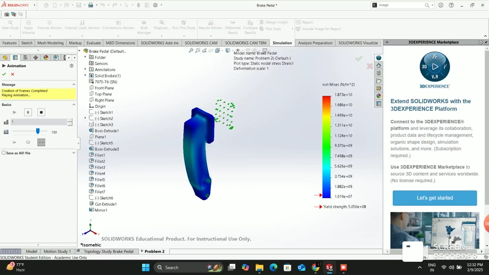

I conducted Finite Element Analysis (FEA) to determine the stress distribution, displacement, and reaction forces under real-world loading conditions. The brake pedal was analyzed for
Static Structural Load of 2000N
Depression of 80mm with a hinge constraint
Von Mises stress and strain evaluation
📊 Key Results:
Maximum Displacement: 81.56 mm
Von Mises Stress: 1.873 × 10¹⁰ N/m² (exceeds yield strength, indicating material failure)
Factor of Safety: <1 (failure condition)
🔹 Solution: To enhance performance, topology optimization was applied!

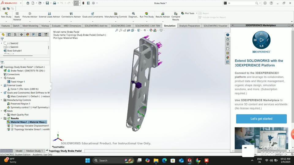

🛠️ Topology Optimization for Weight Reduction
Using SOLIDWORKS Topology Study, we optimized the pedal design by removing non-load-bearing material while ensuring structural stiffness. The goal was to achieve the best stiffness-to-weight ratio while reducing unnecessary mass.
Results:
Mass reduced by 75% – from 0.901398 kg to 0.225350 kg
Best stiffness-to-weight ratio achieved
Stable convergence after 76 iterations
🖥 Optimization Process:
🔹 Applied mass reduction constraint (75%)
🔹 Maintained critical loading and support points
🔹 Analyzed convergence graphs to ensure stability
📈 Convergence Graphs:
🔺 Mass Optimization Graph – Shows gradual mass reduction while stabilizing near 0.225 kg
🔺 Stiffness Optimization Graph – Ensures that stiffness is retained post-material removal

🔹 Optimized Brake Pedal with Material Reduction
