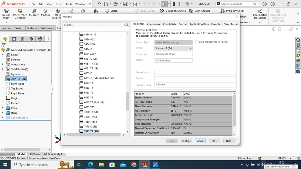

| Material | Aluminum Alloy 7075-T6(SN) |
| Density | 2810 kg/m^3 |
| Yield Stress limit | 5.05e8 N/m^2 |

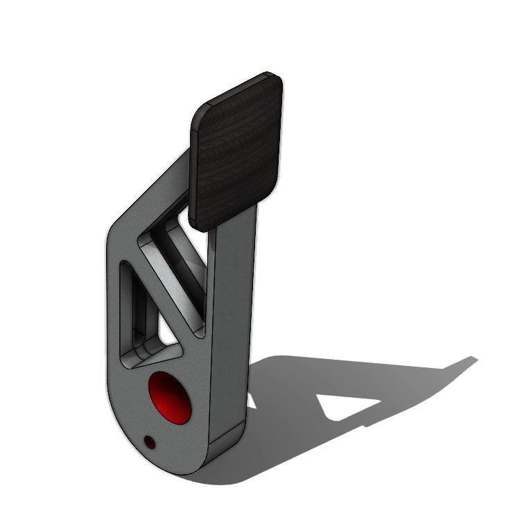

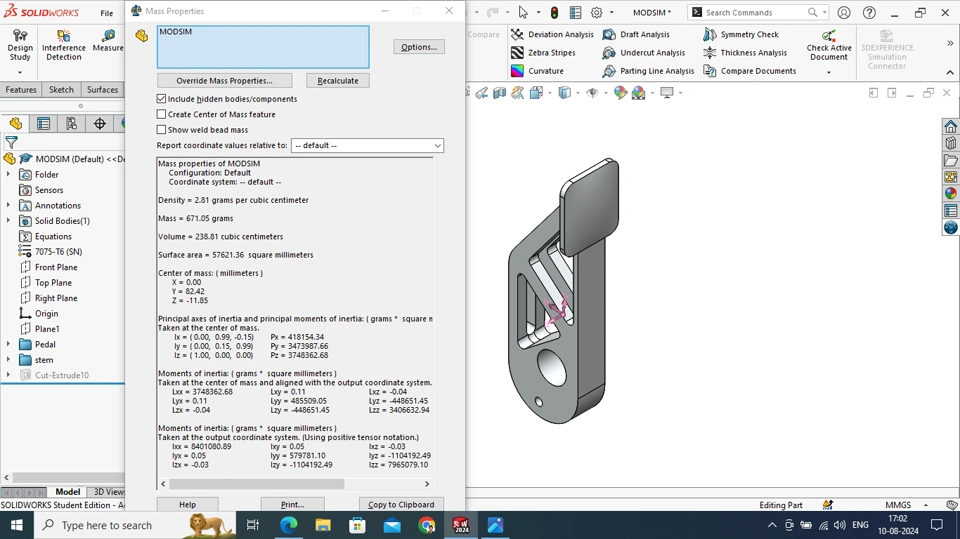

Geometric details: -

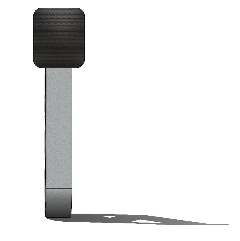

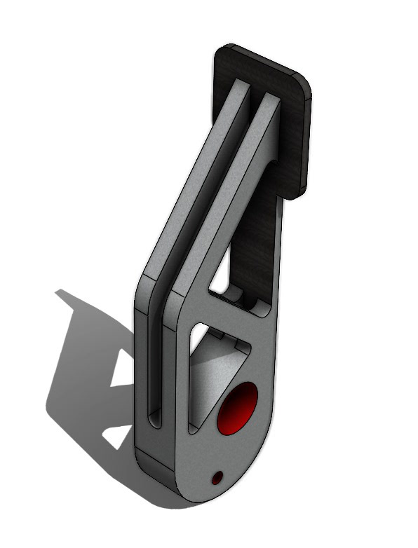

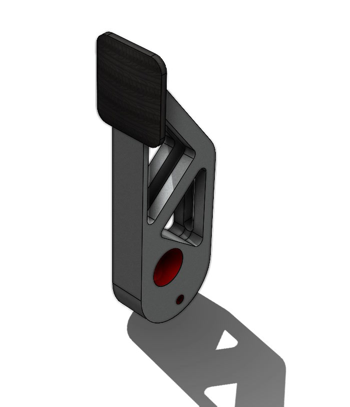

| Volume of the 3D product | 238.81 cc |
| Mass of the part | 671.05 grams |

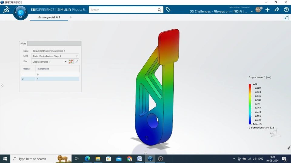

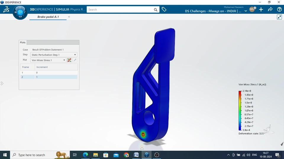

Problem Statement-1 Summary: -
| Maximum Displacement | 0.77959 mm |
| Maximum Von Mises Stress | 2.14279 e+8 N/m2 |
Maximum Von Mises Stress is less than the permissible yield stress of the material.

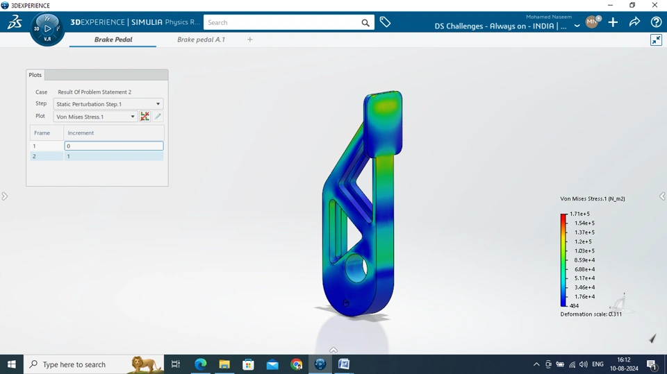

Problem Statement-2 Summary: -
| Applied Displacement | 80 mm |
| Maximum Von Mises Stress | 171290 N/m2 |

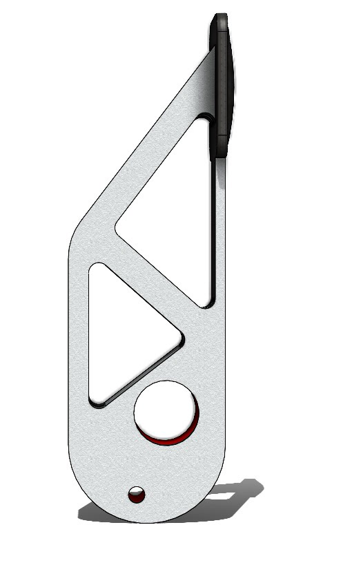

- The 3-D product is optimized to solve both the problem statements with increased stiffness and reduced weight
- The dimensional constrains can be verified from the "Proof video" in which dimensions of the part are shown in xDrawing. The results including stress, displacement, materials used, and mass of the brake pedal can be verified from the generated pdf reports which is also recorded in the video". Proof Video link
