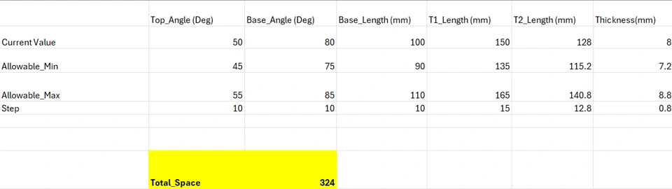

Ranges and steps for different parameters (PDO)

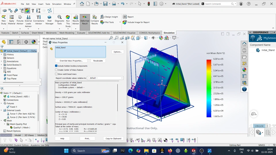

  • INITIAL STAGE:
Designed the original stand and performed the simulations.
Initial Max von mises stress is 0.6301 MPa and mass is 309.37 gm

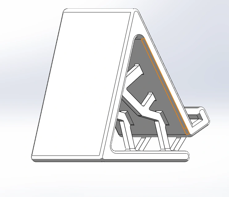

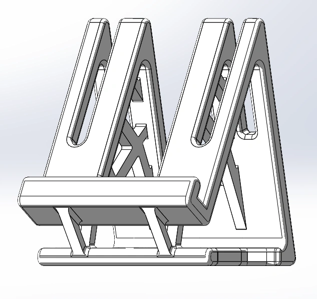

In this stage i have simulated the Parametric Design Optimization(PDO) and topology optimization for a cross section of the stand after PDO.
PDO WITH 6 DIFFERENT PARAMETERS.
TOPOLOGY OPTIMIZATION
Partial_Back_View
Partial_Front_View

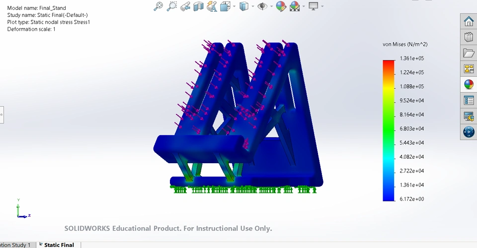

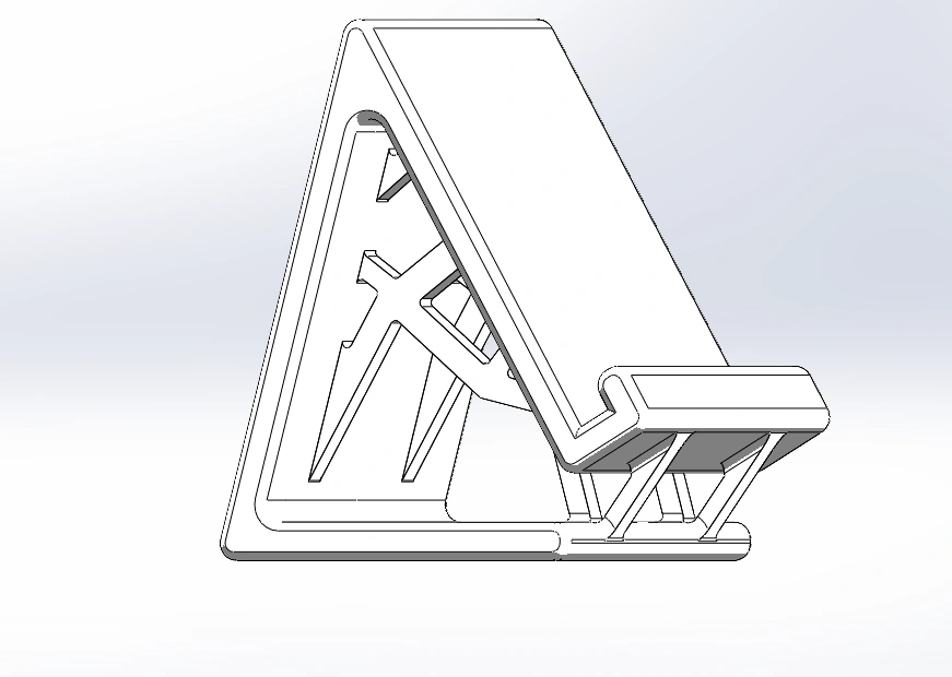

  • FINAL STAGE
In the final stage, I meticulously worked to reduce the mass as much as possible by carefully analyzing the simulations. I strategically removed material from areas where the stresses were minimal and had no significant impact on failure, ensuring an optimal balance between strength and efficiency. This precise approach not only streamlined the design but also enhanced its overall performance.
  • Mass: 217.24 grams.
  • Maximum Stress: 0.136 MPa .
  • Stress Concentration: Reduced significantly due to fillets.
