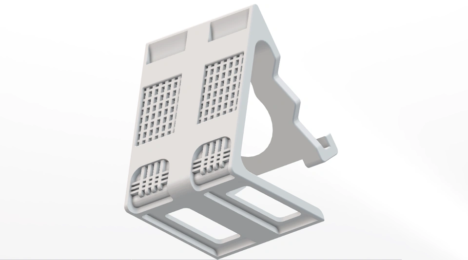

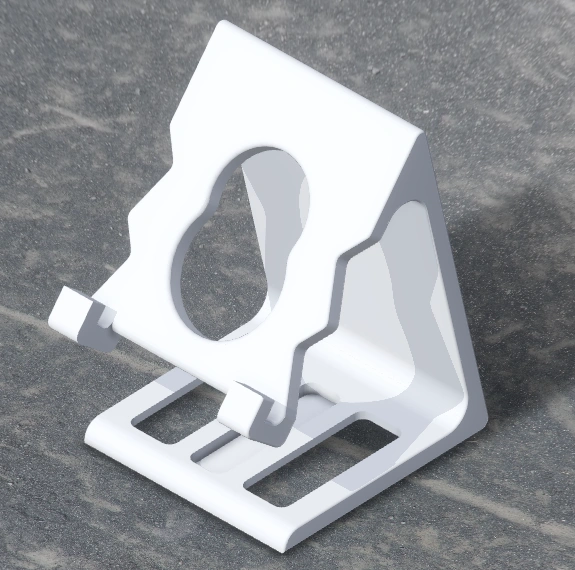

2.1 Design
For the first design to maximize material efficiency, I applied the Shell feature to the back panel, reducing weight without sacrificing strength. This was complemented by strategically positioned reinforcing ribs, each with tailored geometries to optimize load distribution and rigidity. The base of the support follows the same principle, featuring a shell structure with additional ribs for enhanced grip and durability.

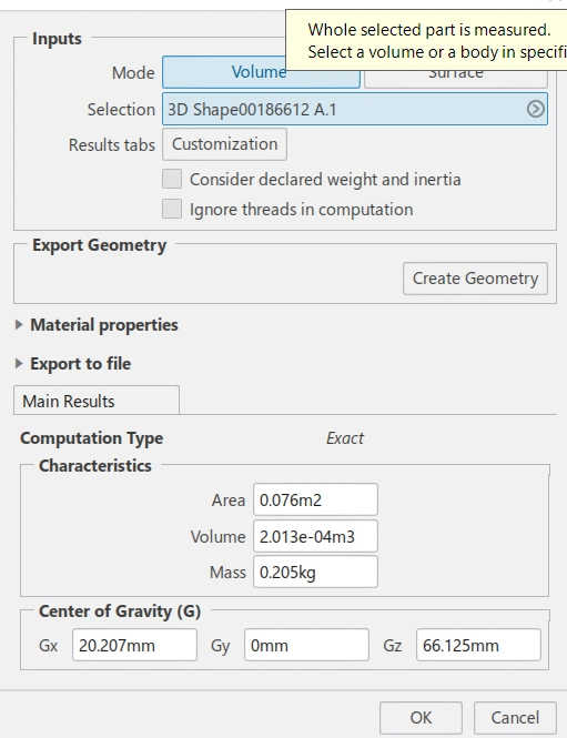

The final design weighs just 205 grams, fulfilling all specified requirements for portability while maintaining exceptional structural integrity. Through simulation-driven refinements and precision engineering, this solution successfully balances lightweight construction with robust performance, addressing the core challenges of the original design brief.

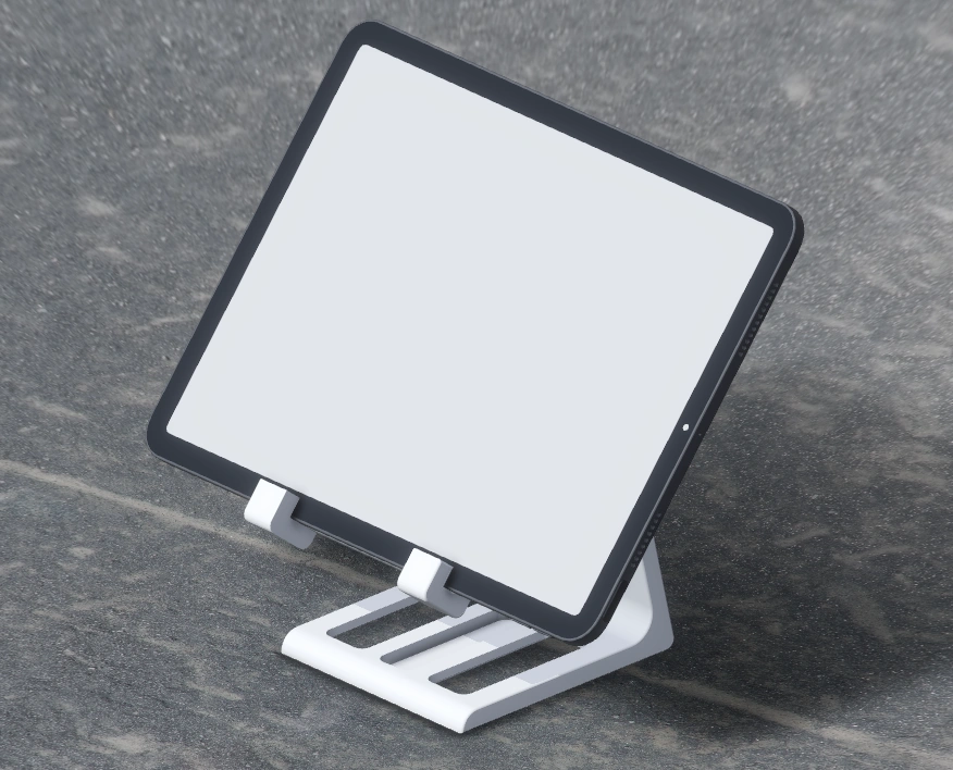

Tablet visualization assembly.
Back Tablet Asssembly
Iso-metric View Tablet Asssembly

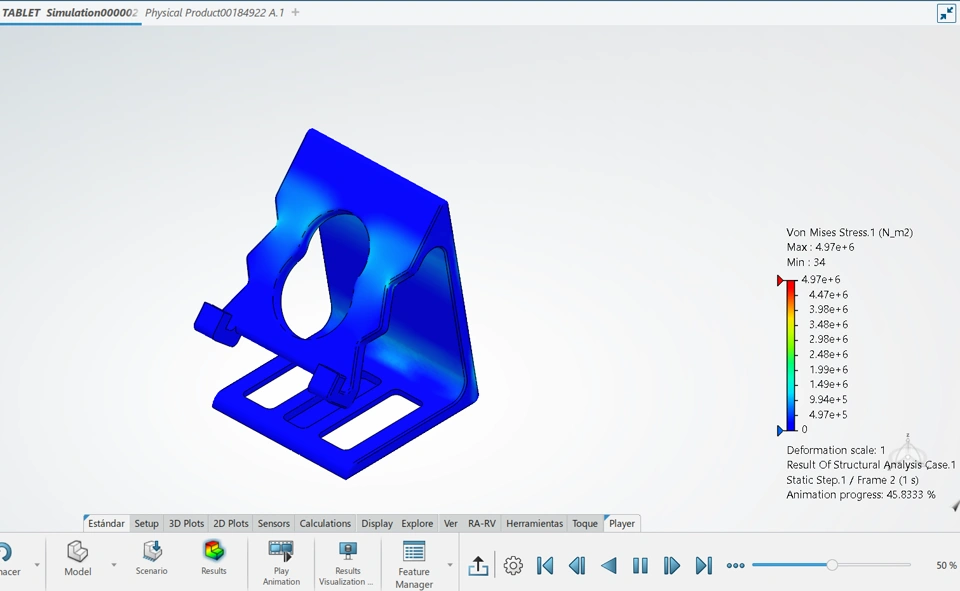

2.2 Simulation of the first design

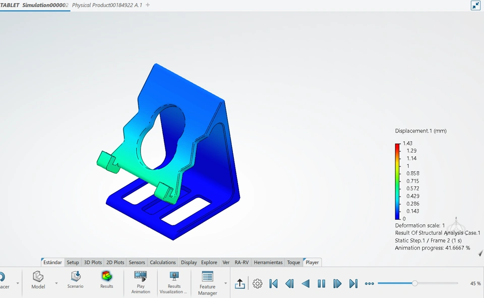

Now from the design, I subjected the tablet support to rigorous testing with two simultaneous forces on the -40N vertical (Z-axis) and -40N lateral (X-axis) loads on its inclined surface  of the Tablet Contact Length, while keeping the base fully constrained. The simulation results were highly encouraging - maximum displacements remained comfortably within acceptable limits, confirming the design's stability under load. for the static setp ive used the normal or generated that is ive appelied in the paltform
The strategically placed reinforcing veins performed exactly as intended, effectively distributing stress and maintaining values safely below the material's yield point. I was particularly pleased with how well the clamped base configuration movements while providing stable support.
Displacement Results
Von Mises Stress Results
In this first simulations of the support design demonstrates excellent structural efficiency with a total mass of 0.205 kg. Under applied loads of -40N in both vertical and lateral directions, the simulation results show a maximum Von Mises stress of 4.97 MPa and peak displacement of 1.43 mm. These values confirm the design's robust performance, with stress levels well within safe limits and minimal deformation. The clamped base configuration combined with strategically placed reinforcing veins effectively distributes loads while maintaining the structure's lightweight characteristics. This optimized solution successfully meets all design objectives, achieving an ideal balance between portability and structural integrity. The parametric approach has proven effective in developing a high-performance support system that satisfies both mechanical and usability requirements.

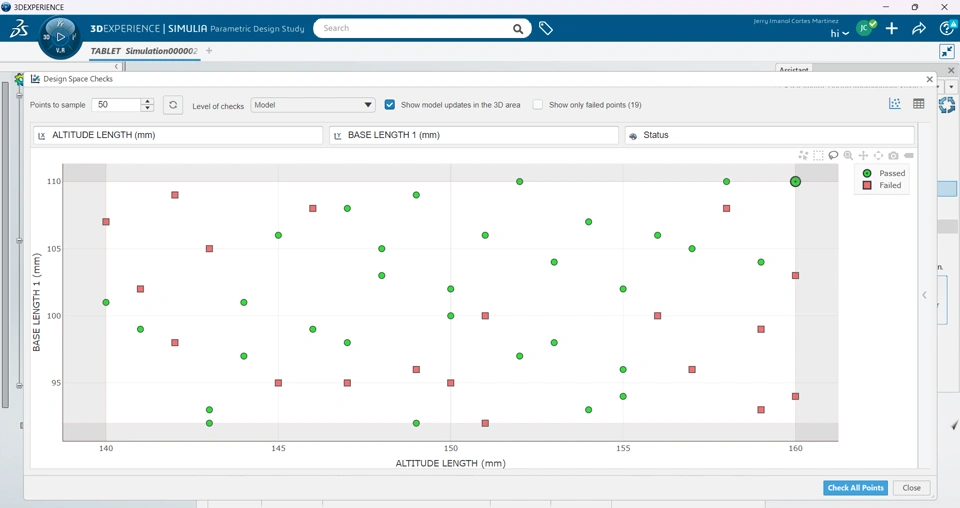

This design optimization study investigated ten key geometric parameters, each varied within ±10% of their baseline values to systematically evaluate performance trade-offs:
  1. Base Length 1: Bottom surface dimension
  2. Altitude Length: Vertical height
  3. Shell Thickness: Internal wall thickness (hollow structure)
  4. Primary Support Thickness: Main rear structural member
  5. Support Spacing: Gap between parallel primary supports
  6. Rib Thickness: Horizontal reinforcing vein dimensions
  7. Rib Spacing: Distance between horizontal veins
  8. Base Rib Spacing: Reinforcement interval on bottom surface
  9. Clamp Thickness: Bottom support reinforcement
  10. Tablet Contact Length: Resting surface dimension
I ran Design Space Checks to test key design variations, analyzing how different configurations affect performance. The study optimized critical parameters like rib geometry and wall thickness to balance strength with manufacturability. Results identified production-ready designs that meet all requirements while maintaining structural integrity. This data-driven approach validated performance before prototyping, reducing development risks.
Design Space Checks
From The simulation process revealed that certain design iterations failed due to incompatible parameter combinations, underscoring the importance of strategic parameter filtering.

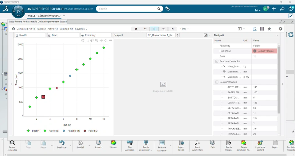

2.4 Simulation of different Parametric
After simulating the Design Space Checks, I selected 12 configurations, to balance computational efficiency with meaningful exploration. This approach prioritized parameter sets with high potential for Pareto-front progression while avoiding redundant or predictably suboptimal combinations a practical compromise given hardware constraints.
Through systematic parametric simulations, the Simulation evaluated configurations to identify the most viable design solution. The outcomes were classified into four distinct categories:
-1 optimal design: Fully compliant with all performance criteria, demonstrating balanced structural integrity, ergonomic handling, and    manufacturability.
-1 feasible design: Met most requirements but required minor refinements to address localized stress concentrations.
-2 failed iterations: Exceeded permissible stress or displacement limits, highlighting critical parameter sensitivities.
-8 Pareto designs: Several of these candidates demonstrated remarkable improvements over the original configuration
In the next video, display the displacement and Von Mises stress values for all 12 simulated designs. Compare the results to help determine the optimal design.
Video of different Designs

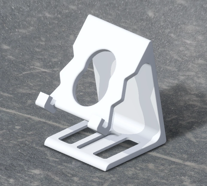

After simulating multiple parameter variations, I selected the optimal design for its superior performance. It showed significant improvements over the initial version in structural efficiency and stress distribution while meeting all requirements. This balanced solution offers better performance and manufacturability. the next image shows the values of the selected greater design
3. Observations
Through parametric optimization, the design achieved measurable improvements in structural performance. Von Mises stress was reduced in critical zones via geometric refinements, enhancing fatigue resistance. Displacement decreased to 1.41 mm (from 1.43 mm), indicating improved stiffness under load. These gains involved a minor trade-off: a 4-gram mass increase (0.205 kg to 0.209 kg) to reinforce high-stress areas—a justified compromise given the enhanced durability and stability. The results demonstrate targeted optimization balancing mass efficiency with mechanical performance. Since it increased the length of the base of 10mm then the previous model normal
First Design Chosen design from the parametric study
Iso-metric view 1st design
Iso-metric view chosen Parametric design
Von mises stress: 4.97e+6 Von mises stress:4.5354+6
Mass: 0.205kgMass: 0.209kg
displacement: 1.44mmdisplacement: 1.41mm
