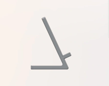

2. METHODOLOGY
The task was conducted using Finite Element Analysis with a computer software. The Mechanical Scenario Creation App was used to conduct a non-linear analysis. This was preceded by modeling various conceptual designs of the tablet stand using the xDesign App on the 3D Experience platform. The conceptual designs of the tablet stand were modelled as a solid for the analysis. A static load of 100N was applied to the tablet contact face, as a static force in the analysis within a time step from 0 to 1s. Figures below show conceptual designs with brief description on the boundary conditions and the mesh types used.

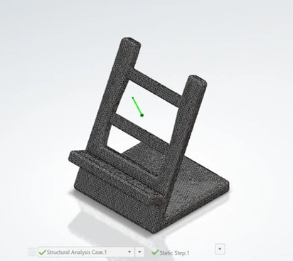

Concept design 1
About Concept design 1
  • Boundary conditions: Bottom plate was clamped and a force of 500 N was applied to the contact face of the stand.
  • Mesh: A Tetrahedron Mesh with quadratic element order was used to improve accuracy. Mesh size was set to 2 mm and absolute sag was set to 1.699mm
  • Result: The maximum Von Mises Stress was
  • Mass: 0.248 kg.
  • Material: ABS.

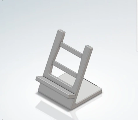

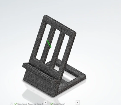

Concept design 2
About Concept Design 2
  • Boundary conditions: Bottom plate was clamped and a force of 10 N was applied to the contact face of the stand.
  • Mesh: A Tetrahedron Mesh with quadratic element order was used to improve accuracy. Mesh size was set to 2mm and absolute sag was set to 1.699mm
  • Mass: 0.183 kg.
  • Material: ABS.

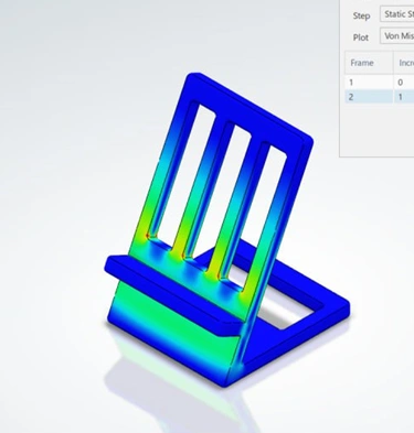

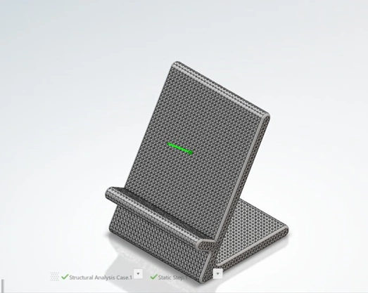

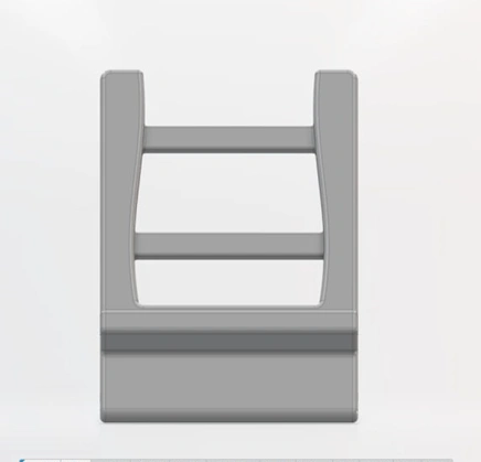

Concept Design 3
 About Concept Design 3
  • Mass: 0.197 kg.

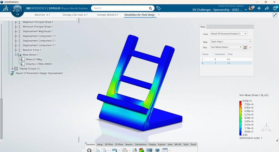

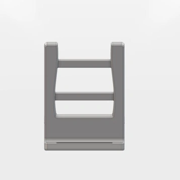

Final Design
About Final Design
  • Boundary conditions: Bottom plate was clamped and a force of 100 N was applied to the contact face of the stand.
  • Mass: 0.194 kg.

Parameters for final design
  • Angle = 65 deg (out of 60 deg 65 deg 70 deg).
  • Thickness = 10 mm (out of a range from 10 mm to 11 mm).
  • Base length = 100 mm.
  • Contact face = 110 mm.

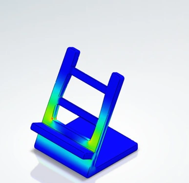

4.RESULT EXPLORATION AND NOVELTY

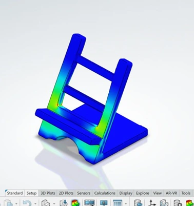

From the above figure, the Von Mises Stress plot indicates a maximum value of when a 100 N force (that is -42.262 N as Fx and -90.631 N as Fz) is applied on the contact face of the stand (which is way below the yield strength of for ABS) and has a mass of 0.194 kg.

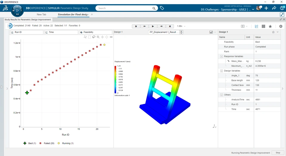

BEST DESIGN FROM THE PARAMETRIC DESIGN STUDY
My parametric design study focused on minimizing the mass of the stand since the Von Mises Stress from the structural analysis was way below the yield strength of the material (ABS).
Design 1(the best design from the parametric design study) was not selected because its mass was greater than the final design making it unsuitable to be chosen.
CRITERIA FOR SELECTING THE FINAL DESIGN.
The main factors that led to the selection of the final design are:
  • Minimum mass value.
  • Maximum Von Mises Stress below the yield strength of the material.
A parametric design study was performed and the design from the study was ignored because it provided an increase in the mass which made the final design a better one.
 CONCLUSION
To conclude, my final design is the best design in my analysis because it shows a maximum stress which is below the yield strength of the material (ABS) and provides a minimal mass value.
