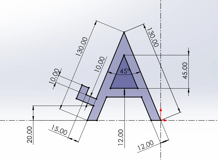

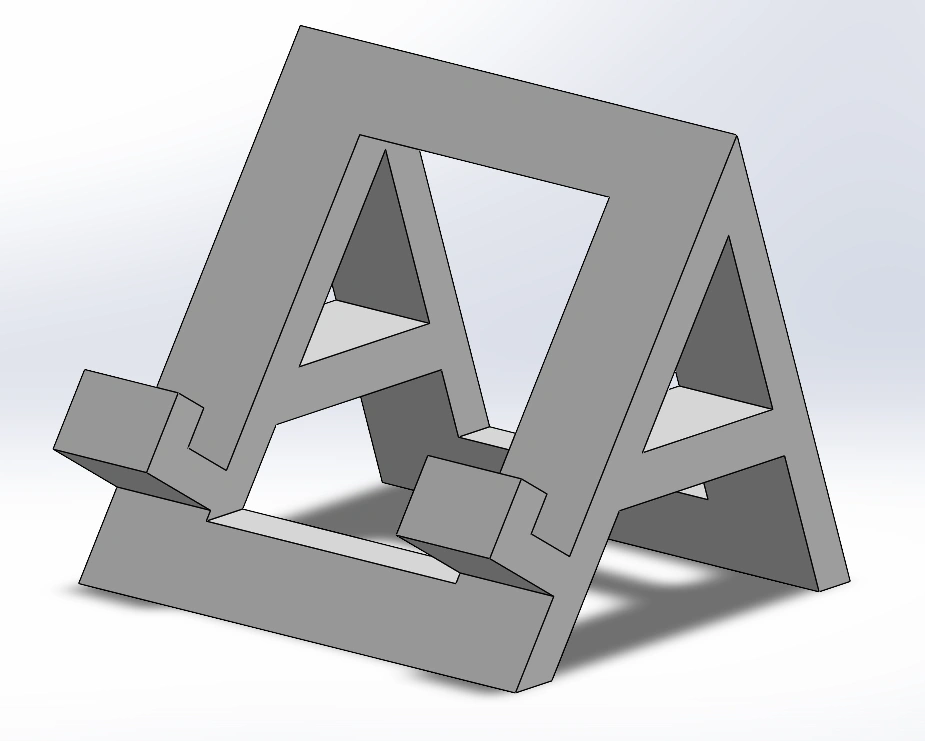

  1. A basic CAD model of the tablet stand was created in SolidWorks, considering ergonomics and stability.

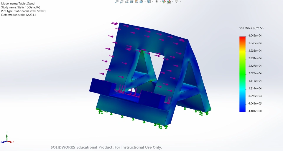

  3. FEA simulations were conducted using four different materials to evaluate stress distribution, deformation, and safety.
  4. The best-performing material was selected based on strength, weight, and efficiency.

  8. A final FEA validation was conducted to confirm the structural integrity of the optimized stand
CAD Model

MaterialModel Weight [kg]Volume [m^3]Stress [N/m^2]Displacement [mm]Strain Cost [Rs.]
ABS 0.370628  0.00036336   3.957 × 10⁴1.335 × 10⁻³1.502 × 10⁻⁵Moderate
PC High Viscosity 0.432399 0.00036336 3.963 × 10⁴1.151 × 10⁻³1.293 × 10⁻⁵High
Acrylic (Medium-high impact)
0.436032 0.00036336 4.039 × 10⁴8.854 × 10⁻⁴9.741 × 10⁻⁶High
PBT General Purpose 0.472368 0.00036336 3.965 × 10⁴1.383 × 10⁻³1.553 × 10⁻⁵Low
PC High Viscosity was chosen because it offers:
  1. Lower displacement (1.151 mm) than ABS and PBT, ensuring better stability.
  2. Lower strain, meaning higher durability under load.
  3. Good impact resistance, making it more reliable for long-term use.
  4. Balanced weight and strength, keeping the stand both sturdy and portable.

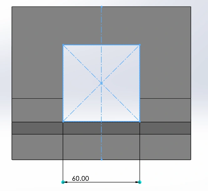

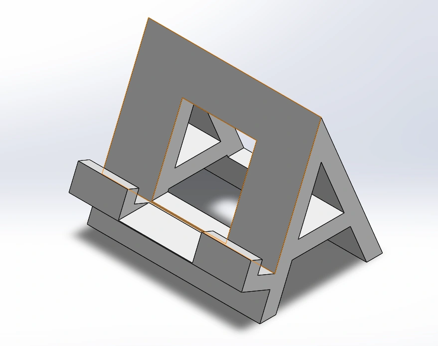

Parameter Constraint or GoalFormatUnitInitial ValueFinal Value
    Calculated
v Length Back mm130120
v Langth Front mm130140
V Angle deg4550
V Thickness mm1210
Cut Dimension mm6080

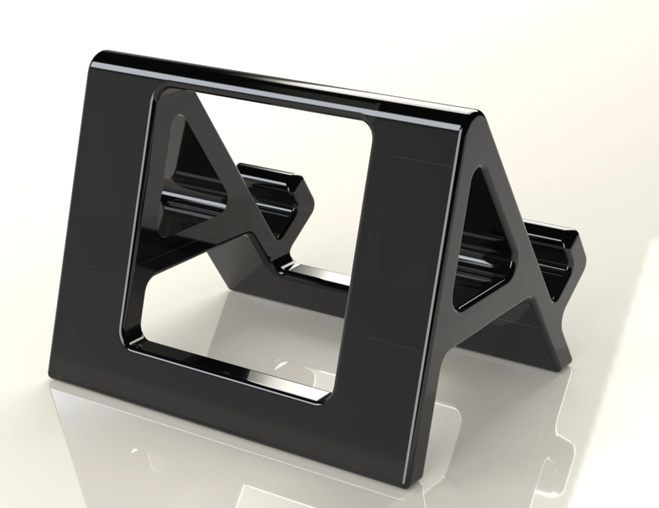

Aesthetic Refinement
Aesthetic refinements (fillets, chamfers) were applied to improve design and reduce stress concentrations.

Optimized Cutouts for Weight Reduction – The triangular and rectangular cutouts reduce material usage, making the design lightweight while maintaining structural integrity.
Enhanced Load Distribution – The A-frame structure provides excellent support and stability, efficiently distributing forces across the stand.
Ergonomic Front Holders – The angled front supports securely hold the tablet, preventing slipping while ensuring ease of access.
Structural Efficiency – The combination of an A-frame design and strategic cutouts provides an ideal balance of strength and weight.
