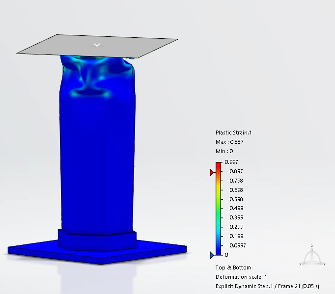

The explicit dynamics method is well-suited for analyzing high-speed dynamic events, but its advantages also extend to the analysis of slower (quasi-static) processes. A good example is sheet metal forming, where contact plays a dominant role in the solution, and local instabilities, such as wrinkling of the sheet.

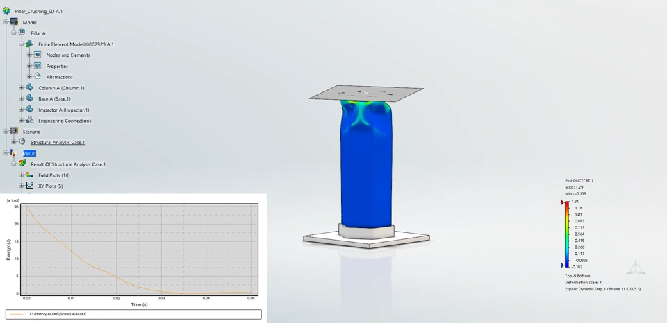

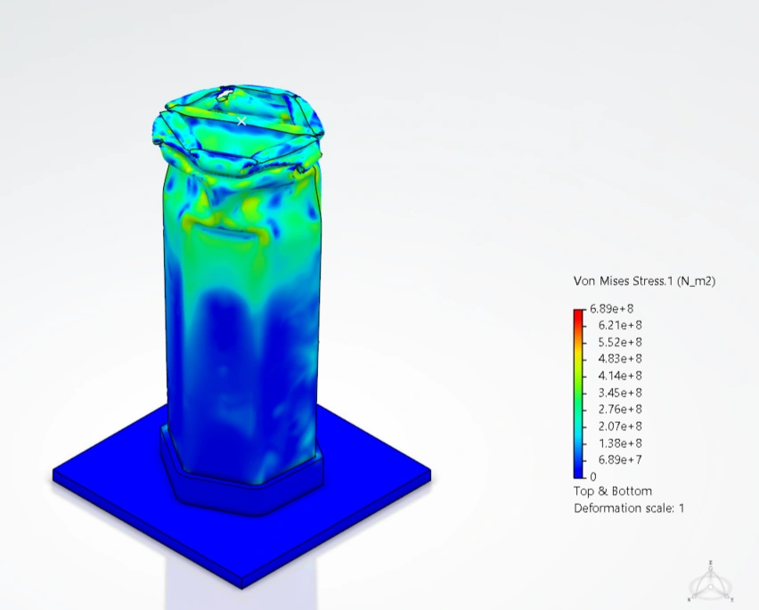

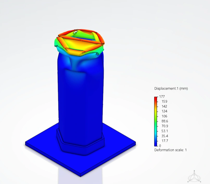

The element output available for a dynamic analysis includes stress; strain; energies; and the values of state, field, and user-defined variables. The nodal output available includes displacements, velocities, accelerations, reaction forces, and coordinates. All of the output variable identifiers are outlined in Explicit Step output variable identifiers.
