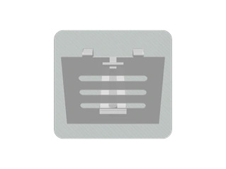

Force Calculations
  • Mass of tablet: 900 g average has taken by comparing various tablets
  • Design load : ≈ 9N
Material Selection
  • Form: Sheet metal is chosen due to ease of fabrication and reduced secondary processing.
  • Comparison: Solid bodies offer higher load-bearing capacity with compact cross-sections and better integration of functional parts like rolling pins.

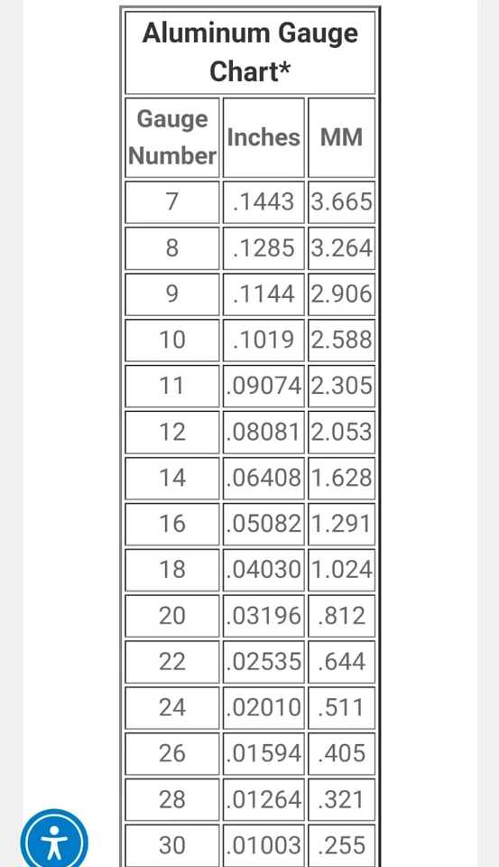

Determination of Sheet Metal Gauge
  • Reference from Gauge Chart:
    • 16-gauge aluminum: 1.29 mm
    • 20-gauge aluminum: 0.81 mm
  • Final Choice:
    • Given the overhanging span and risk of bending, a thicker gauge is required.
    • 9-gauge aluminum (2.9 mm, rounded to 3 mm) is selected for better rigidity and durability.

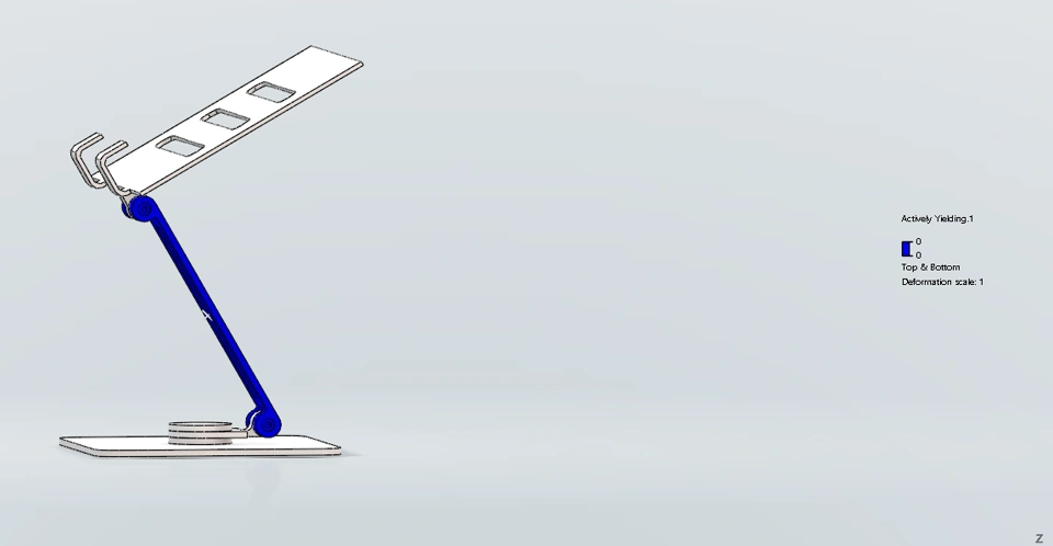

Mesh Selection
  • Shell elements and shell mesh were used due to the sheet metal’s small thickness compared to its length and width.
  • This approach reduces computational time while accurately capturing stress and deformation.

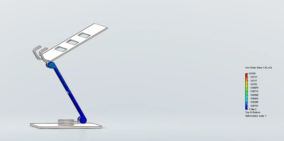

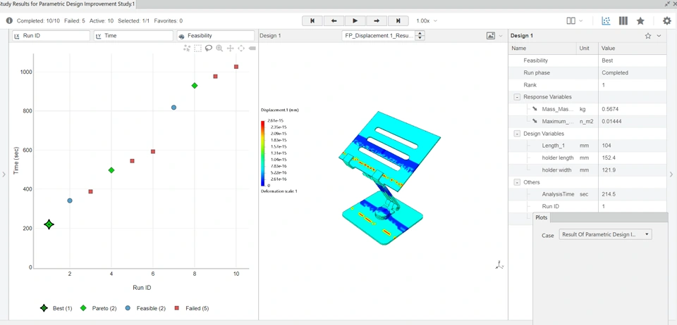

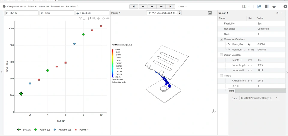

3. Observations
  • FEA results show low stress values (0.00153 MPa) within material limits.
  • The overhanging sections exhibit minimal deformation, confirming the adequacy of 3 mm thickness.
  • The stand effectively distributes static loads without excessive bending.
  • Shell mesh significantly reduced simulation time without compromising accuracy.

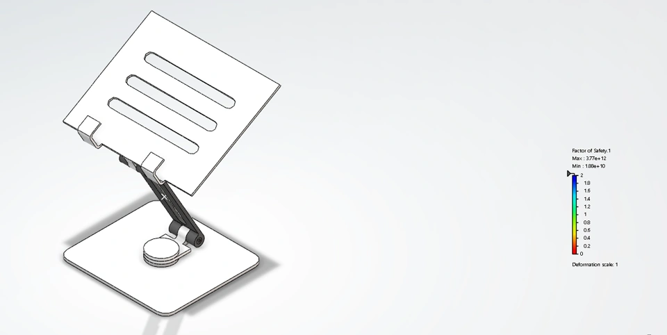

5. Conclusions
  • The chosen 9-gauge aluminum sheet (3 mm) is suitable for the design load while ensuring durability.
  • Stress values are well within limits, ensuring long-term stability.
  • Using shell elements reduced computational time, making the simulation process more efficient.
  • Further optimization can explore reinforcing structural supports or material alternatives for weight reduction.

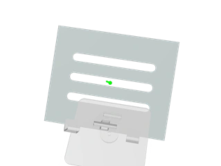

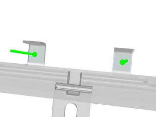

  • Load NameLoad ImageLoad Details
    Force.1
    Value:6.24 N, Force X: = -6.24 N, Force Y: = 0 N, Force Z: = 0 N
    Start Step: Static Step.1
    End Step: Static Step.1
    Force.2
    Value:6.24 N, Force X: = 0 N, Force Y: = 0 N, Force Z: = -6.24 N
  • Restraint NameRestraint ImageRestraint Details
    Clamp.1
    Type:Clamp
