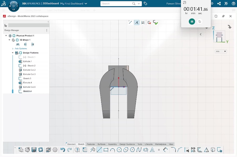

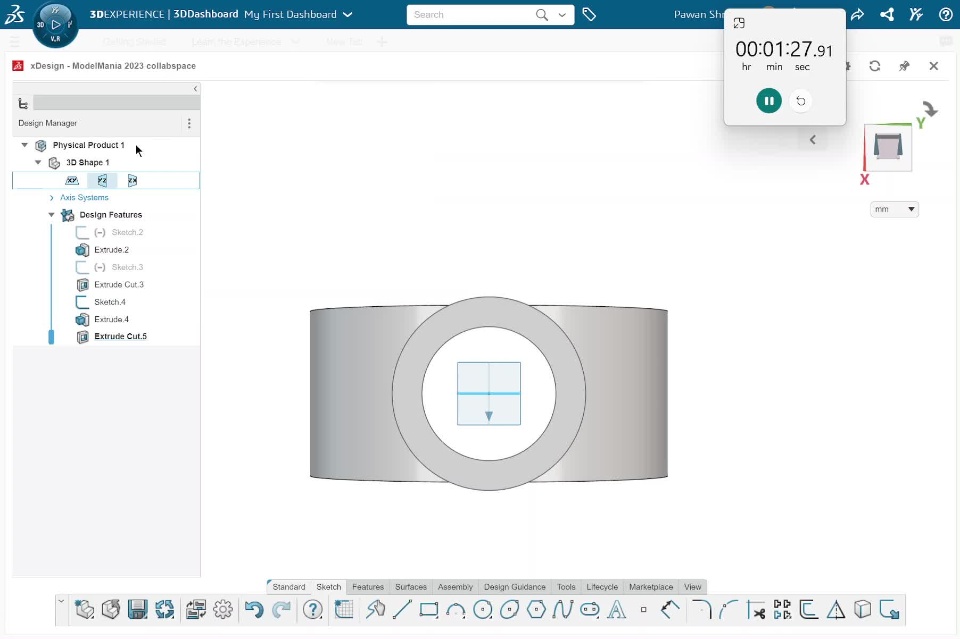

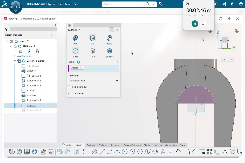

By making notes of the commands sequence, reducing no. of clicks and drags, and finding out the minimal selections for fillet, I reduced my best time to 5 minutes and 18 seconds. But I have never compromised accuracy.

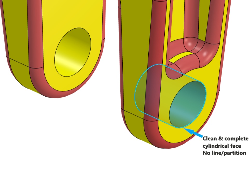

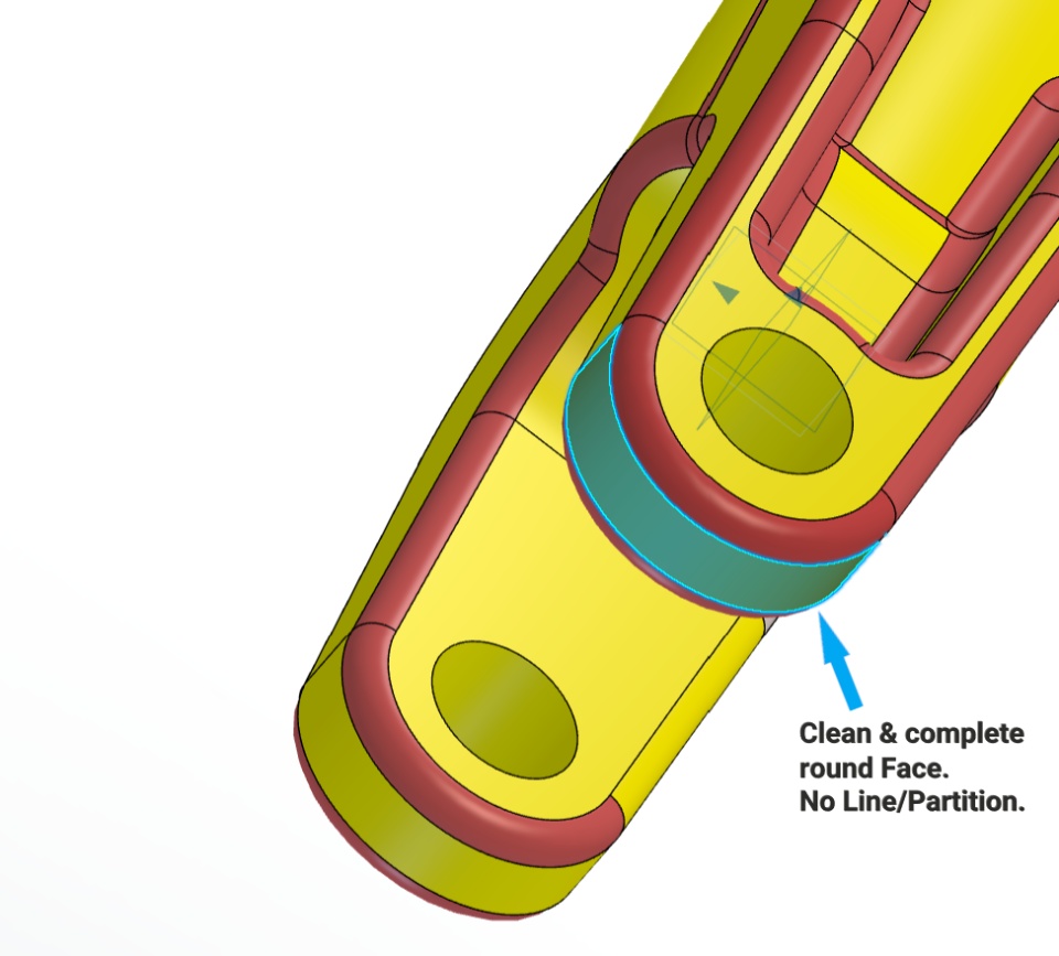

A feature like "Flip Side to Cut" makes 2 faces in one hole (partitions are created instead of one clean cylindrical face) in Xdesign. The solution to that is:
  • Use simple Cut extrude for hole
Yeah, that added one more step and some more clicks and time, but worth it for accuracy.

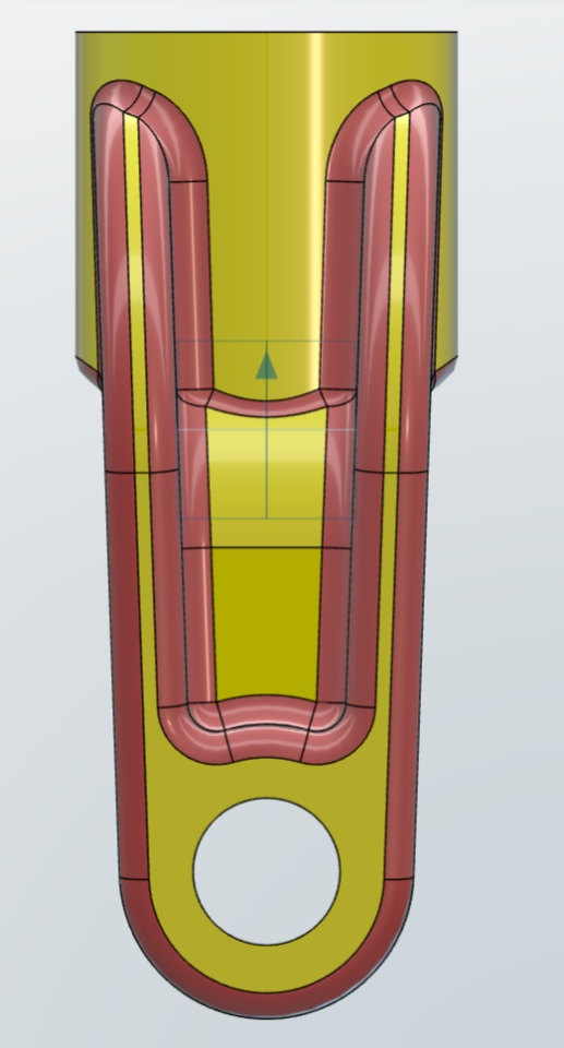

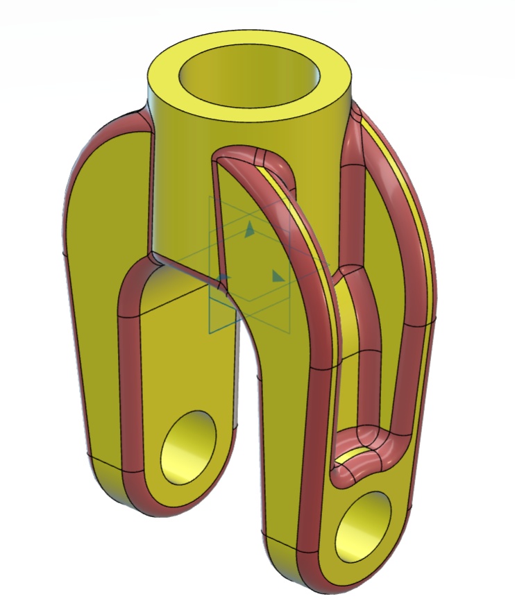

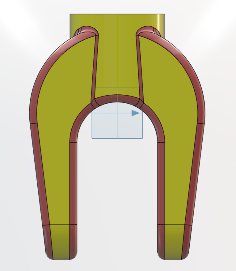

 MATERIAL WAS APPLIED AS MENTIONED IN THE DRAWINGS: <strong>PLAIN CARBON STEEL</strong> These following images are colored to the model, only to show fillet accuracy and comparison to the <strong>Model Mania 2D drawing.</strong>
ORTHOGRAPHIC VIEWS:
FRONT
ISOMETRIC
SIDE
