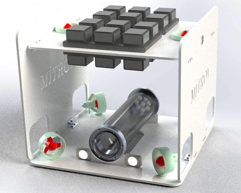

Model 3 Unmanned Underwater Vehicle Prototype
Model 3, building on our earlier prototypes, is designed to remain suspended in water while offering a fully modular assembly.
  • Chassis
    Instead of a 3D-printed frame, the chassis is made from polyethylene sheets, with aluminum plates added for reinforcement where needed.
  • Enclosure Mounting
    The plexiglass housing is aligned using a custom intermediary mounting block and fastened with screws—eliminating the need for external clamps.
  • Buoyancy System
    Low-density foam inserts, cast into molds at the top of the hull, provide balanced buoyancy to keep the vehicle stably suspended.
Feel free to share any feedback or questions!
