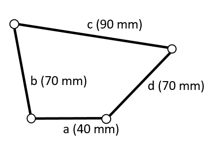

  • A four-link mechanism with four revolute joints is commonly called a four-bar mechanism.
  • Grashof's Law: A four-bar mechanism has at least one revolving link if the sum of the lengths of the largest and the shortest is less than the sum of the other two links.
    • a = Shortest link
    • c = Longest link
    • a+c < b+d
Here,
    a+c = 40+90 = 130
    b+d = 70+70 = 140
    a+c < b+d
    ⇒ At least one of the link can turn 360°

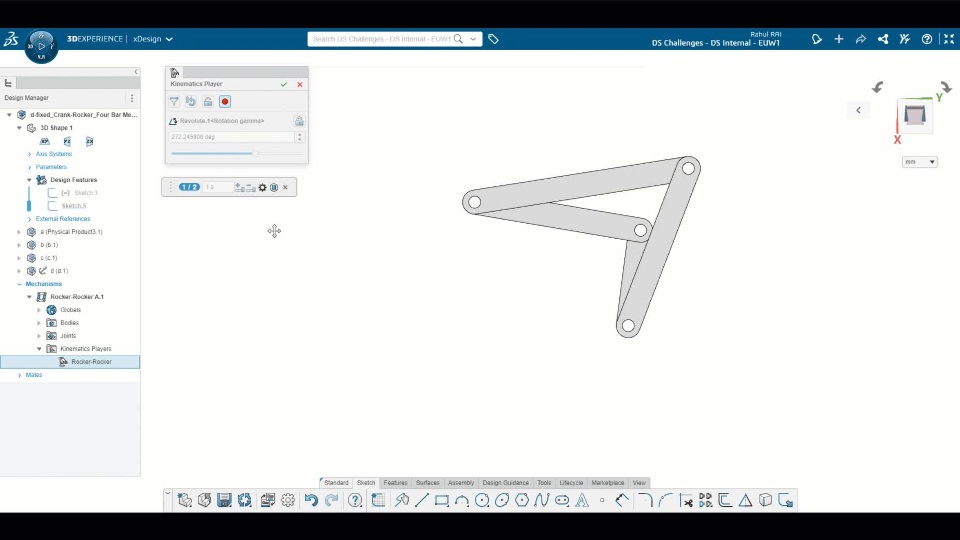

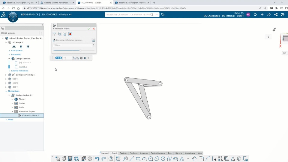

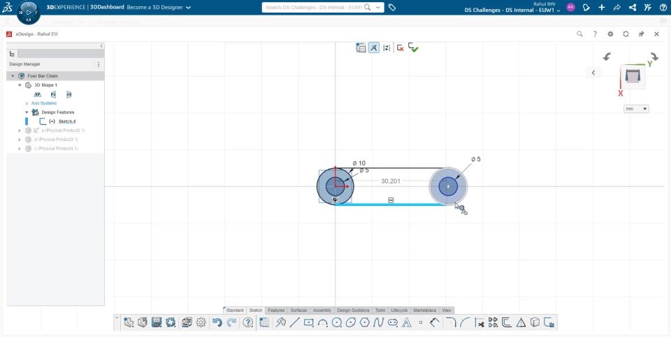

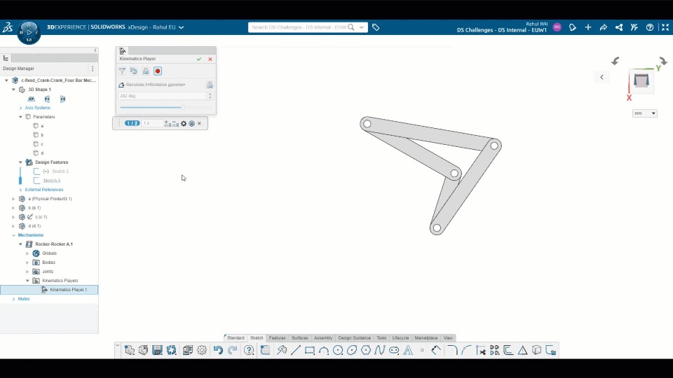

Creating Four-Bar Mechanism on the 3DEXPERIENCE Platform:
Screen recording of the steps to create The Four Bar Mechanism

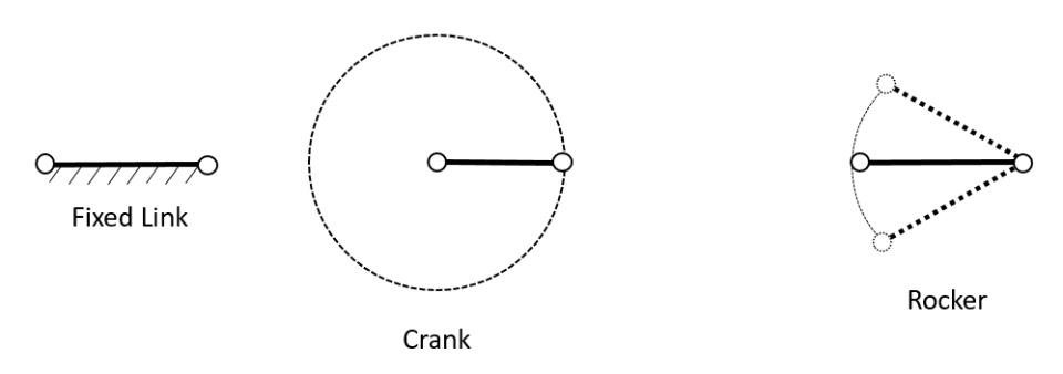

Nomenclature:
  • Fixed Link: The link fixed to ground.
  • Crank: A link which rotates a full circle.
  • Rocker: A link which oscillate.

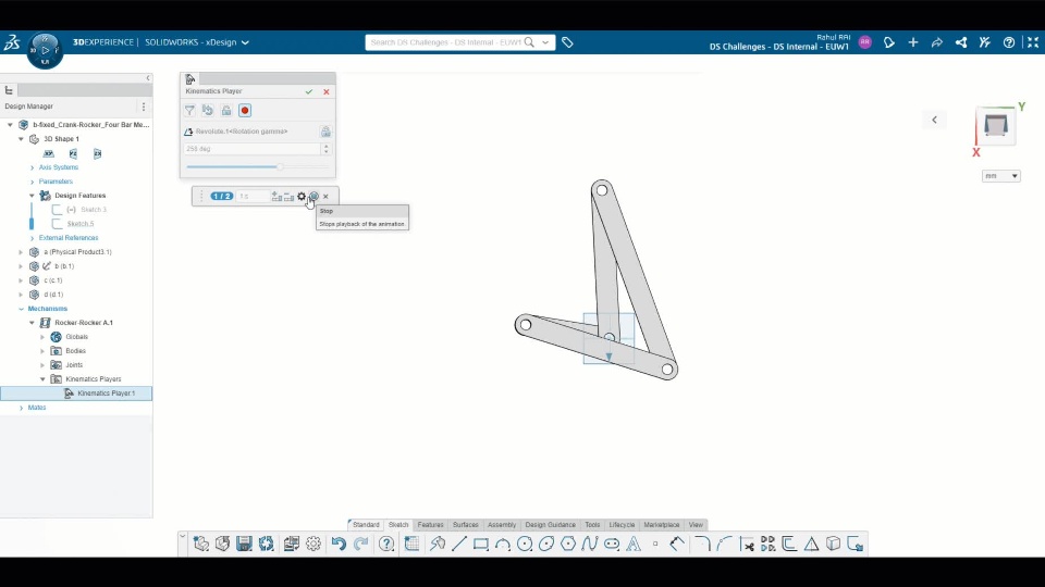

Inversion of Mechanism:
Different mechanism obtained by fixing different links of a chain.
  1. Crank-Crank Mechanism: Shortest-link is fixed
  2. Crank-Rocker Mechanism: One link adjacent to shortest link is fixed
  3. Crank-Rocker Mechanism: Another one link adjacent to shortest link is fixed
  4. Rocker-Rocker Mechanism: Longest link is fixed
Shortest-link is fixed: Crank-Crank Mechanism
Link adjacent to shortest link is fixed: Crank-Rocker Mechanism
Longest link is fixed: Rocker-Rocker Mechanism
