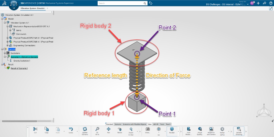

Axial Spring
  • An axial spring is a connection between two points or vertices on two rigid bodies.
  • An axial spring exerts an equal force but opposed on each attached body, along the direction defined by the points or vertices.
  • The force exerted can be:
    • Bidirectional, that is in compression and in extension
    • In compression only (the extension force is null)
    • In extension only (the compression force is null)
  • The axial spring parameters are stiffness, damping, and reference length.
    • By default, the value of the length is equal to the distance between the two points specified at spring creation.
Note: A representation of the axial spring is displayed and animated when:
  • Playing Experience and running kinematic simulation in Mechanical Systems Design app.
  • Running a simulation in Mechanical Systems Experience app.

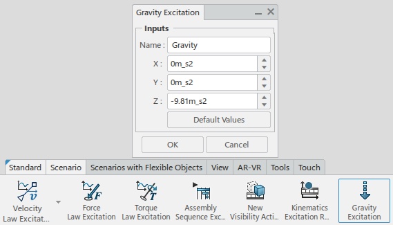

Gravity
You can edit the gravity force applied to a mechanism and accounted for when playing the mechanism.
To edit gravity, you can:
  • turn it on and off
  • reverse its orientation
  • specify a direction according to the mechanism orientation
  • change its value.

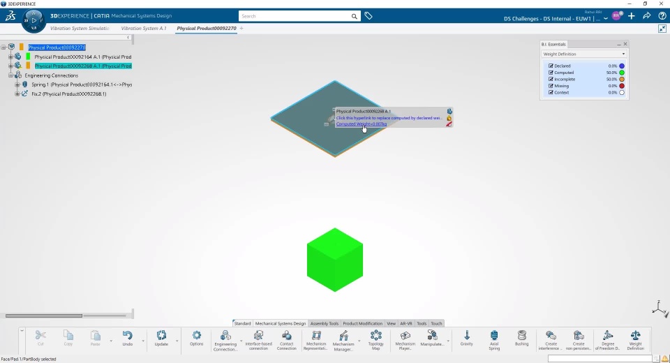

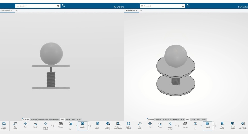

Steps to Simulate a Vibration System
  • Open or create an assembly (at least two rigid bodies)
  • Switch to Mechanical Systems Design App.
You can add an axial spring connection between two components involved in the simulation.
  • From the Mechanical Systems Design section of the action bar, click Axial Spring.
    • The Connection Property dialog box appears.
  • Select the first and second support of the axial spring.
    • Note: The supports must be either a point or a vertex belonging to another component.
  • In the Elasticity tab, select the direction of the force, Fx
  • Select the type of force exerted by the axial spring:
    • Bidirectional
    • Compression only
    • Extension only
  • Select the type of translational stiffness:
    • Select Linear and enter the value of the force over displacement.
    • Select Nonlinear and enter the values of the force over displacement in the table.
  • In the Damping tab, select the force and define the damping value over displacement based on a linear or a nonlinear law.
  • In the Ref. Length tab, indicate the reference length associated with the component.
    • Note: By default, the reference length is calculated from the initial geometry.
  • Click OK.
A spring engineering connection is created under the Engineering Connections node of the active product.
This engineering connection contains the Axial Spring connection definition under the Simulation connections node.
  • Fix one of the part/rigid body
  • Browse and Apply Material
  • Compute Weight
  • Create a Mechanism
  • Switch to Mechanical Systems Experience App.
    • Note: Create a Simulation Object
  • Add Gravity
  • Add Probe

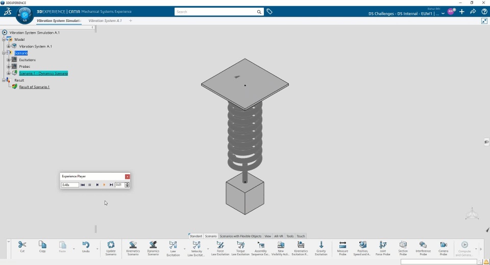

  • Create a Dynamics Scenario
  • Preview the Simulation
  • Compute the Simulation
  • Analyze the Simulation

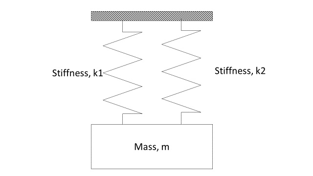

Simulation Challenge:
​​​​​​​​​​​​​​Simulate and prove that,
Equivalent Stiffness of the following system, k = k1+ k2
