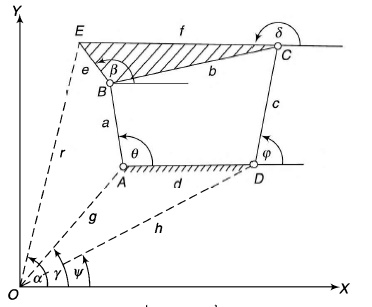

Do you want to create a mechanism that satisfy the required motion?
There are mainly three types of mechanism creation:
Function Generation
When the rotary motion of the input and output links are correlated.
Path Generation
When a point on the coupler of a mechanism is to be along a prescribed path
Motion Generation
When the mechanism is design to guide a rigid body in a prescribed path

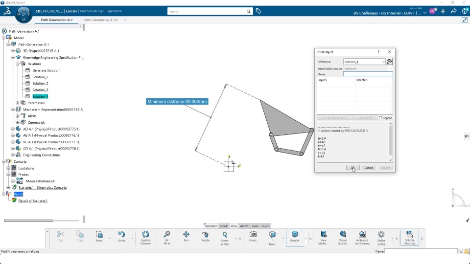

In this post we will see how the 3DEXPERINECE CATIA  Apps can be used for Path generation.
A four-link mechanism ABCD with a coupler point E is shown in the above figure. Three positions of the input link (θ1, θ2, θ3) and the three positions of the coupler point E given by three values of r and α. It is required to find the dimensions of a, c, e and f along with the location of the pivots A and D given by g, γ and ψ respectively, so that the coupler point E generates the specified path with the motion of the input link AB.
For more information please refer Rattan, S. S. (2014). Theory of Machines, Tata McGraw-Hill Education.
Problem statement: Design a four-link mechanism to coordinate three position of the input link with three positions of the coupler point, the data for which is given below:
tb1, θ1 = 110°           r1 = 80mm          al1, α1 = 65°
tb2, θ2 = 77°             r2 = 90mm          al2, α2 = 56°
tb3, θ3 = 50°             r3 = 96mm          al3, α2 = 48°
gamm, γ = 20              si, ψ = 10                  dll, δ = 150
Solution steps are similar to the one shared in the Mechanism Monday: Mechanism Creation🤖 - Part 1​​​​​​​.
The main difference is the following code to generate the solution.
/* Code to generate the solution */
