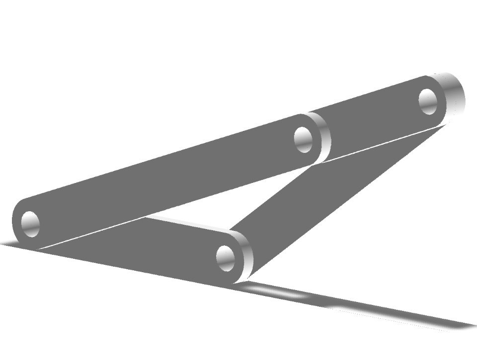

In this post we will see how the 3DEXPERINECE CATIA  Apps can be used for function generation.

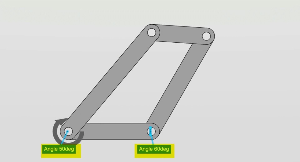

Problem statement: Design a four-bar mechanism to coordinate three position of the input and the output links as follows:
θ1 = 20°          φ1 = 35°
θ2 = 35°          φ2 = 45°
θ3 = 50°          φ3 = 60°

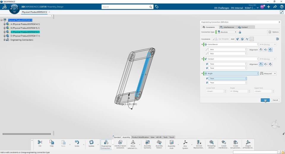

Solution steps:
Function Generation Using 3DEXPERIENCE CATIA
  • Open assembly design
  • Inset a part 3D Part
  • Rename the Part as A
  • Edit the 3D shape
  • Create a binary link
  • Hide Part A
  • Insert three more 3D Parts and rename them as B, C & D respectively
  • Edit 3D Shape of each part and create binary links
  • Create four revolute joints to create the four bar mechanism
  • Switch to Engineering Rules Capture App
  • Create Knowledge Engineering Specification
  • Create a parameter of type real and pin it
  • Similarly create other nine parameters
  • Set parameters according to required three positions of the input and output links
  • Create an Action
  • Enter the code and link parameters
  • Link output A to length of part A
  • Similarly link respective output and length of part
  • Run the Action or update the Physical Product
