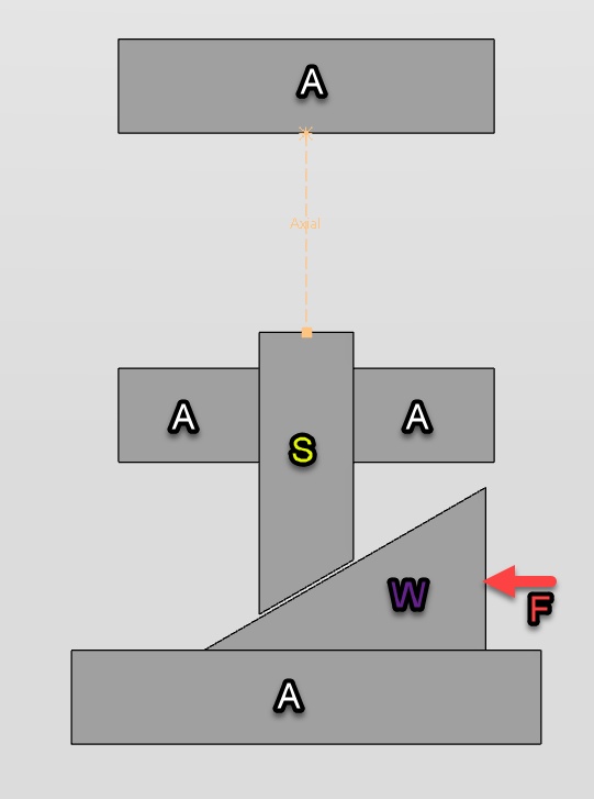

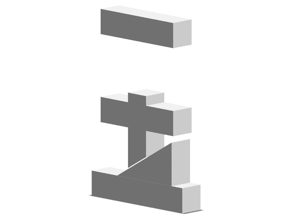

What is a Wedge?
It is a machine to raise load like a screw jack. It consists of three sliding pairs. Frame(A), Wedge(W) and Sliders(S). When a force(F) is applied to the wedge, the slider is raised in the guides raising the load.
Wedge Machine
<em><strong>Mechanical efficiency of the wedge</strong> =</em>
<em><strong>Load raised when friction is considered/Load raised when friction is neglected</strong></em>
​when the force applied is the same
Important parameters:
Wedge Angle = 30°
Coefficient of friction between between Slider(S) and Frame(A) = 0.105
Coefficient of friction between between Slider(S) and Frame(W) = 0.141

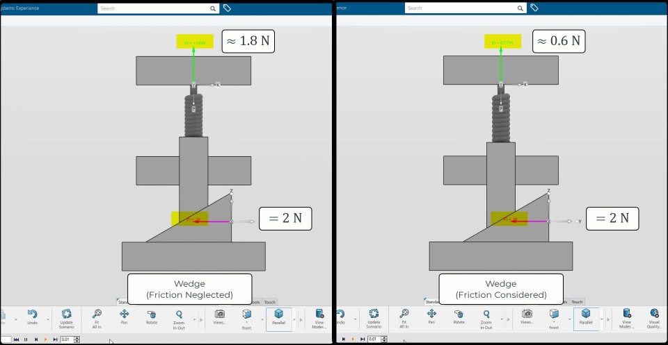

Calculation of Mechanical Efficiency from Simulation data:
Case I: When friction is neglected
Force applied = 2 N
Load raised =  Weight of the wedge + Force on spring
where,
Weight of the wedge = Mass of Wedge * Acceleration due to gravity = 0.167 * 9.81 = 1.64 N
and Force on spring = 1.79 N (From the simulation)
Load raised = 1.64 + 1.79 = 3.43 N
Case II: When friction is considered
Force applied = 2 N
where,
and Force on spring = 0.58 N (From the simulation)
Load raised = 1.64 + .58 = 2.25 N
Mechanical efficiency =
load raised when friction is considered/Load raised when friction is neglected
= 2.25/3.43
= 0.66
