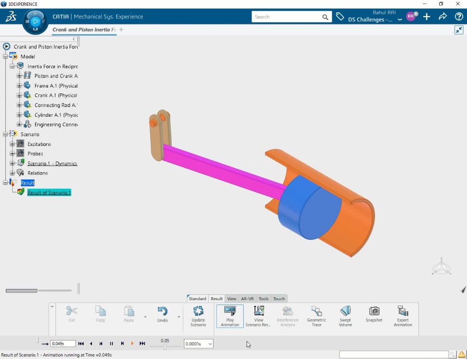

Here we have a simulation to analyze the effects of Inertia forces in Reciprocating Engines.

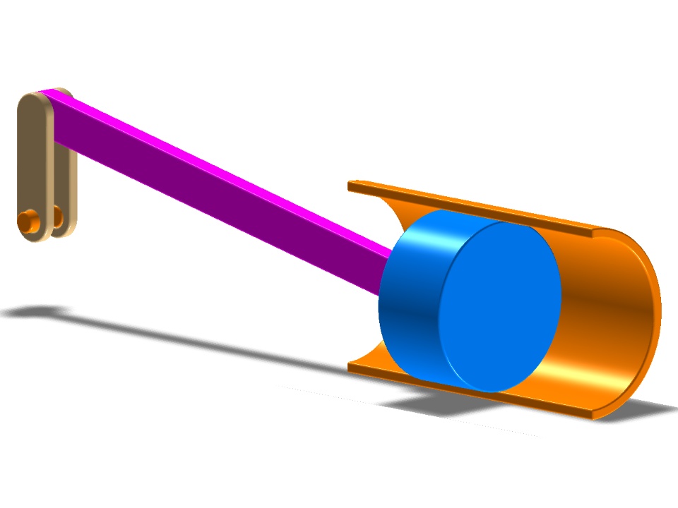

Create Necessary parts for a Simplified Reciprocating Engine.
  • Crank
  • Frame
  • Connecting Rod
  • Piston cylinder
Create Assembly
  • Create a Physical Product
  • Insert the frame, crank, piston and connecting rod, and orient them properly
  • Go to Assembly section of the Action bar and select Engineering Connection
    • Create Fix Engineering Connection to the frame
    • Create a Revolute Engineering Connection between frame and the crank (Add a Controlled Hinge)
    • Create a Revolute Engineering Connection between the crank and the connecting rod
    • Create a Revolute Engineering Connection between the connecting rod and the piston
    • Create a Cylindrical Engineering Connection between the piston and the frame.
Simulation and Analysis
  • Open Mechanical Systems Design App
  • Go to Mechanical Systems Design section of the Action bar.
  • Create a mechanism using Mechanism representation command
    • Test the motion using Mechanism Player
  • Open Mechanical Systems Experience App
    • Note: It will ask to Create a Simulation Object, Click OK
  • Go to Scenario section of the Action bar
  • Create a Law Excitation
    • Select the revolute command of the mechanism as Support
    • Angle Formula: Angle = `Excitations\\Law Excitation.2\\Time` *62.8rad/1sec
  • Create Gravity Excitation
  • Create Joint Force Probe for joints between Frame and Crank, Crank and Connecting rod, Connecting rod and Piston.
  • Create a Dynamics Scenario with
    • Excitation:
      • Law Excitation
      • Gravity Excitation
    • Probe:
      • Joint Force Probes
    • Parameters:
      • Start Time = 0s
      • End Time = 0.1s
      • Step Time = 0.0001s.

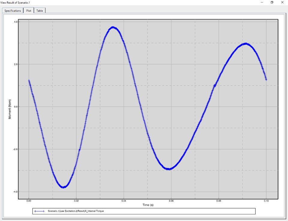

  • Select Compute and Generate Results
  • Select View Scenario Results
  • Select appropriate data and switch to Plot tab to view the graphs.
