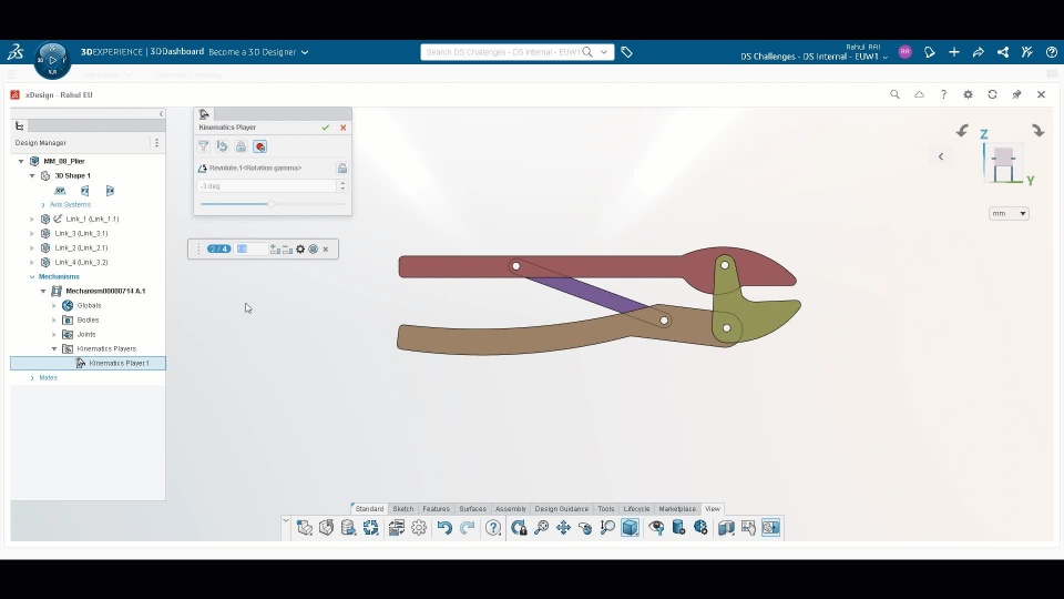

This Monday we have a very simple but powerful mechanism, similar to a plier.
Plier: A tool made of two crossed pieces of metal with handles, that is used for holding things firmly and for cutting wire.
Motion Simulation (xDesign)

Create PartsxDesignPart Design
Create AssemblyxDesignAssembly Design
Create MechanismxDesignMechanical System Design

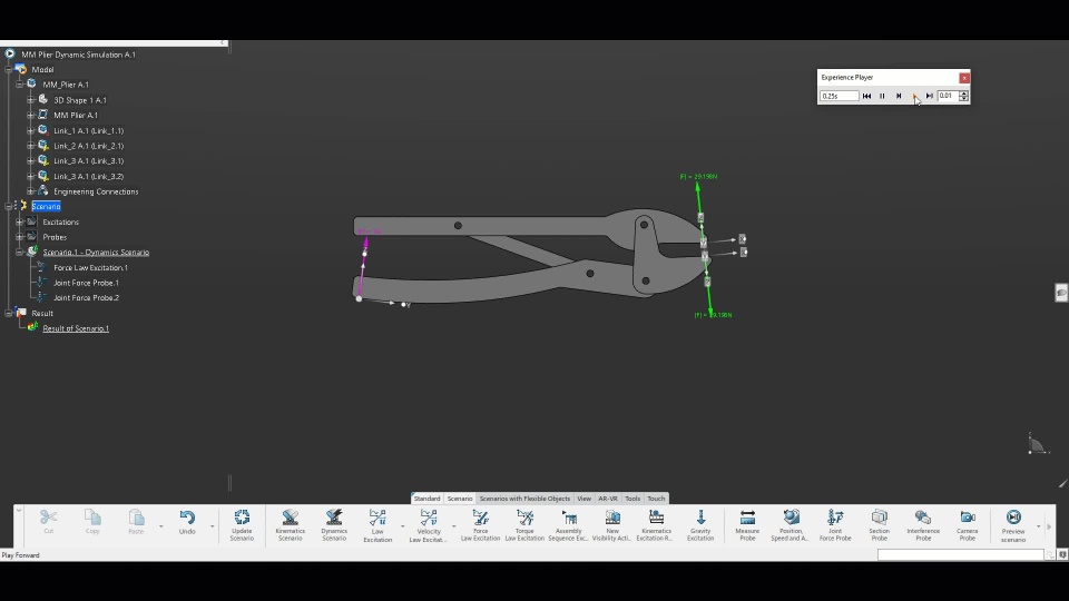

Motion SimulationxDesignMechanical System Design
Add Dynamic Elements
Dynamic Analysis
Mechanical System Experience
Dynamic Analysis (Mechanical Experience Design)

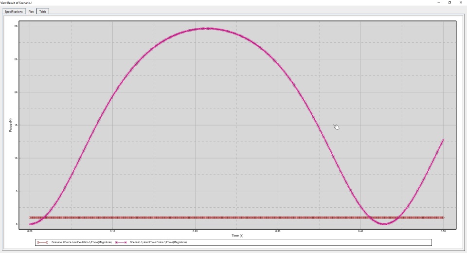

Plot of Applied force and Resisting force with respect to Time
Result:
When 1 N force is applied at the handle, at equilibrium the force applied by the jaw is approximately 30 N.
So, Mechanical advantage = 30/1 = 30
