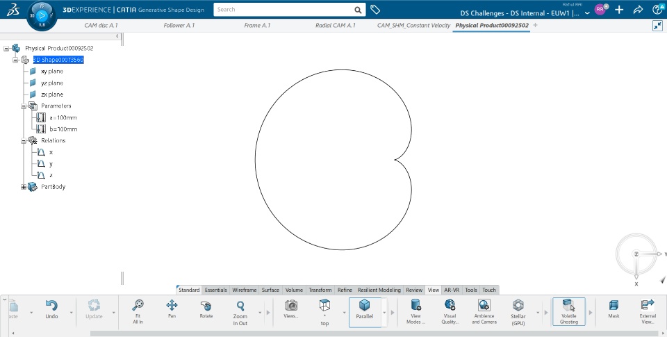

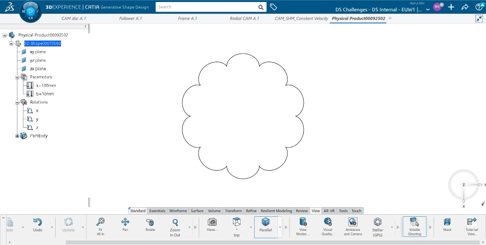

Do you know, you can create Curves from Equation in the 3DEXPERIENCE CATIA.
For example these beautiful Epicycloid curves were created using following parametric equations:
x = (a + b) sin(t) - b sin((a/b + 1) t)
y = (a + b) cos(t) - b cos((a/b + 1) t)
a = b
a = 2 b
a = 10 b

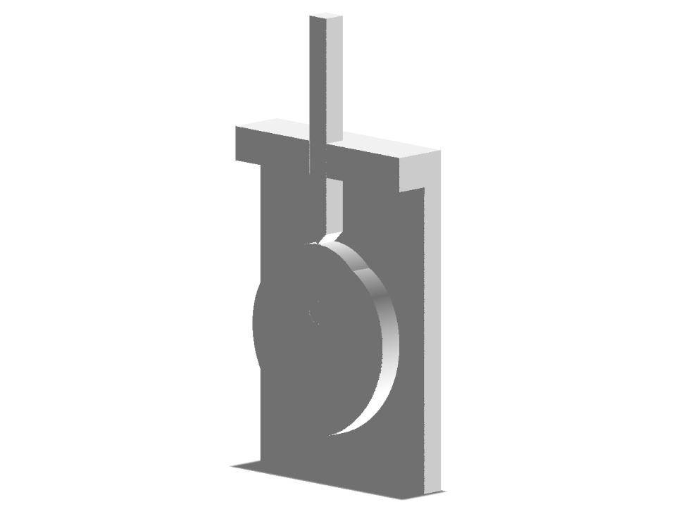

Problem:
Create a 3DXML file to generate radial CAM and follower profile according to the given input:
  • Base circle radius of the disc, r
  • Maximum height of the follower, h
  • Motion of the follower: Simple harmonic motion (SHM) or Constant velocity
also plot displacement, speed and acceleration plot of follower motion.

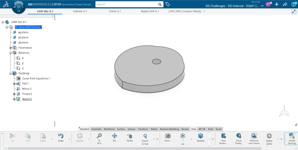

Create CAM

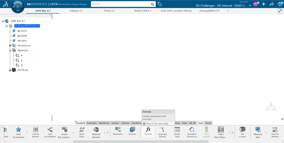

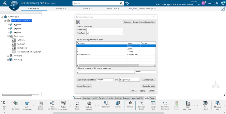

  • Open Part Design App
  • Edit the 3D Shape
  • Go to Tools section of the Action bar
  • Select the Formula command and create following parameters
    • Follower motion, type: String)
    • r, type: Length
    • h, type: Length
    • th, type: Angle
  • In the Tools section, Expand the secondary area of the group of commands by clicking the arrow next to the separator

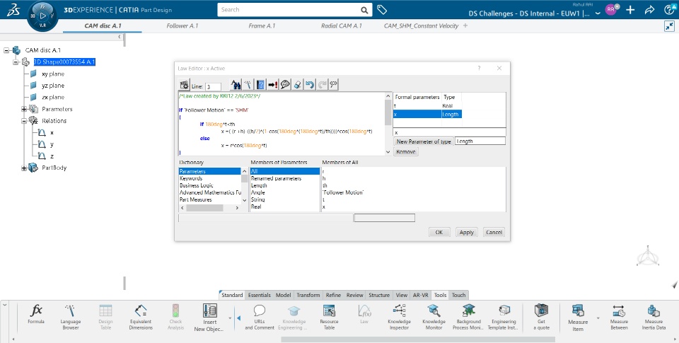

  • Select the Law command to create three laws x, y & z to generate the CAM profile.
    • Note: Create formula parameters of length type and real type, in each law.
Code:
Law: x
if `Follower Motion` == 'SHM'
               if 180deg*t<th
                              x =((r +h)-((h/2)*(1-cos(180deg*(180deg*t)/th))))*cos(180deg*t)
               else
                              x = r*cos(180deg*t)
else
               if 180deg*t<th
                              x =( (r +h)-(h*(180deg*t/th)))*cos(180deg*t)
               else
                              x = r*cos(180deg*t)
Law: y
               if 180deg*t<th
                              y =( (r +h)-((h/2)*(1-cos(180deg(180deg*t)/th))))*sin(180deg*t)
              else
                              y = r*sin(180deg*t)
else
               if 180deg*t<th
                              y =( (r +h)-(h*(180deg*t/th)))*sin(180deg*t)
               else
                              y = r*sin(180deg*t)
Law: z
z = 0*t

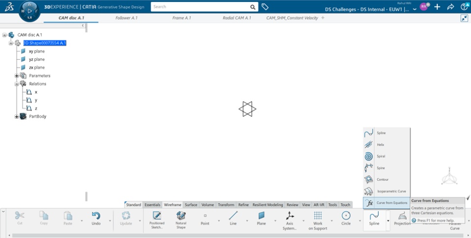

  • Open Generative Shape Design App
  • Go to Wireframe section of the Action bar
  • Open the flyout menu of the Spline command and select Curve from Equations
    • Note: If the cure is not visible, then activate Action Bar > View > View Modes > Wires
  • Select corresponding laws for X, Y & Z as input.
  • Switch to Part Design App
  • Create a Positioned Sketch in a plane parallel to the plane of the curve
  • Project the curve in the sketch using Project 3D Elements and draw a line to create a close the profile.
  • Go to Model section of the Action bar
  • Select the Pad command and create a pad of appropriate thickness.
  • Go to Transform section of the Action bar
  • Select Mirror command and mirror about the flat surface.
  • Create a circular Pocket or Pad, at the centre of the base circle to attach it with the frame.

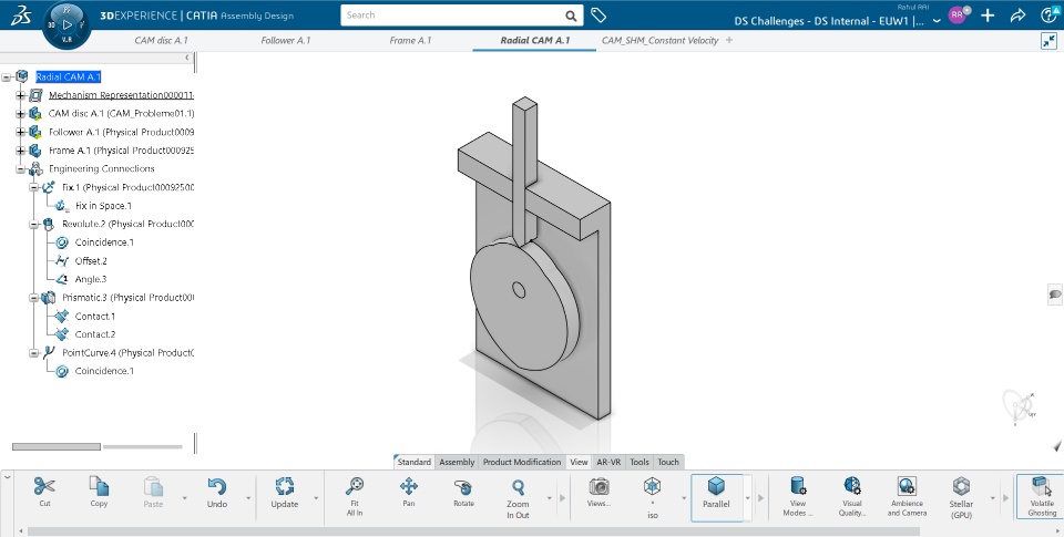

Create Assembly
  • Create a Physical Product
  • Insert the Cam Disc, Follower & Frame, and orient them properly
  • Apply Fix Constraint to the frame
  • Create a Revolute joint between frame and the cam disc
  • Create a Prismatic joint between follower and the frame
  • Create a Point and curve joint between contact point of the follower and the profile sketch of the cam disc

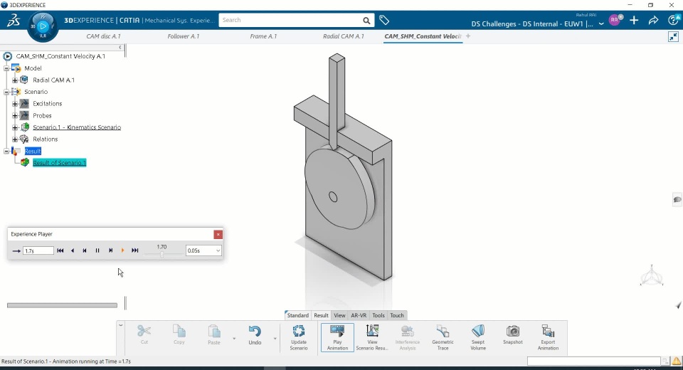

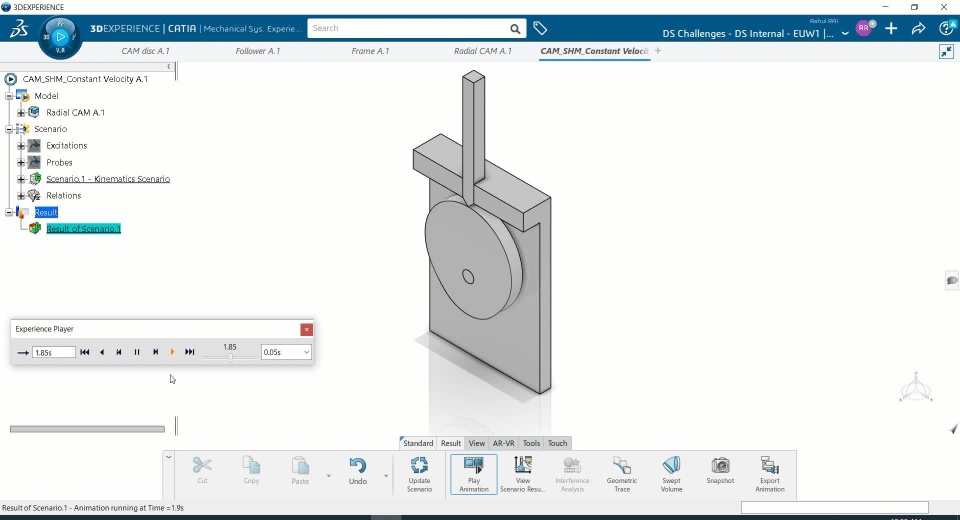

Simulation and Analysis
  • Open Mechanical Systems Design App
  • Go to Mechanical Systems Design section of the Action bar
  • Create a mechanism using Mechanism representation command
    • Test the motion using Mechanism Player
  • Open Mechanical Systems Experience App

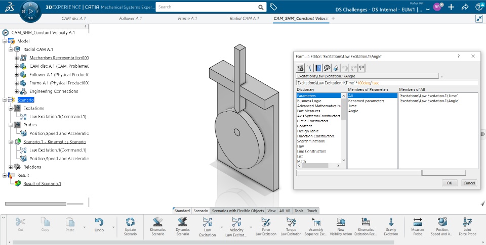

    • Create a Simulation Object
  • Go to Scenario section of the Action bar
  • Create a Law Excitation
    • Select the revolute command of the mechanism as Support
    • Angle Formula: Angle = `Excitations\\Law Excitation.1\\Time` *100deg/1sec
  • Add a Position, Speed and Acceleration Probe at the contact point of the follower and the cam disc.
  • Create a Kinematics Scenario with
    • Excitation:
      • Law Excitation
    • Probe:
      • Position, Speed and Acceleration
    • Parameters:
      • Start Time = 0s
      • End Time = 3.6s
      • Step Time = 0.05s.
  • Select Compute and Generate Results
  • Select View Scenario Results
  • Select appropriate data and switch to Plot tab to view the graphs.

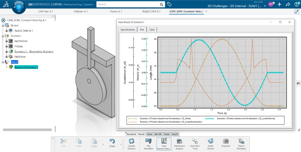

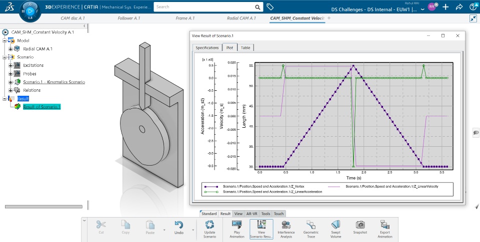

Simple Harmonic Follower Motion
Constant Speed Follower Motion
Downloadable 3DXML
Preview
Simple Harmonic Motion (SHM)
Constant Velocity Motion
