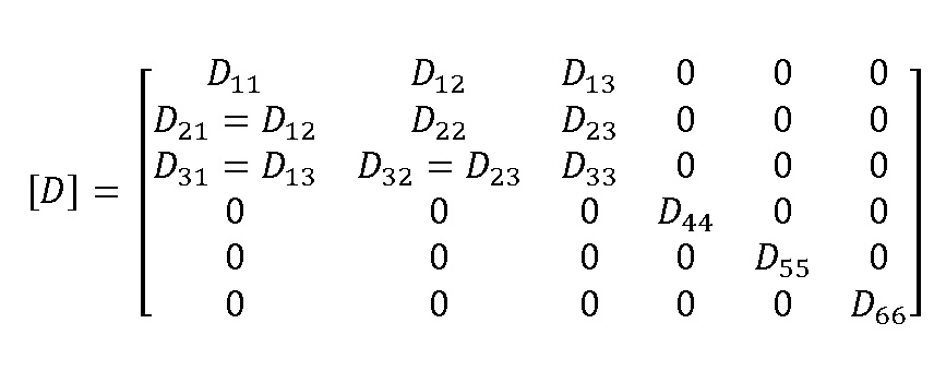

➡️There are various types of materials. A monoclinic material requires 13 different elastic constants to fully define this relationship. A simpler case is an orthotropic material. These materials have specific symmetrical properties and can be described using nine elastic constants. When the axes of this symmetry align with the x, y, and z axes, the Stiffness matrix of the material can be written in a specific form:

Material Properties: When using either orthotropic or anisotropic models, you need to define the relevant elastic constants for the material.  For orthotropic materials, this typically involves nine constants. For fully anisotropic materials, it can be as many as 21 constants.
