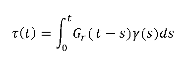

For small Strains
  is applied to the material. The response is the shear stress . The viscoelastic material model defines as:
is the time dependent “shear relaxation modulus” that characterizes the material’s response. This constitutive behavior can be illustrated by considering a relaxation test in which strain is suddenly applied to a specimen and the held constant for a long time.
