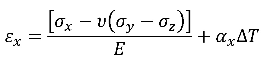

👉This fundamental principle, known as Hooke's Law or a material's "constitutive relation," describes this relationship.  For instance, in an isotropic material (same properties in all directions) with initial thermal strain, the relationship between the change in length along one direction (normal strain) and the various stress components can be expressed as:
Where, is the strain along x-axis; are stress vectors, E is the material’s elastic modulus (the slope of a strain–stress diagram), υ denotes the material’s Poisson ratio (the ratio of ), is the thermal coefficient of the material. is the temperature increase from the stress-free state.

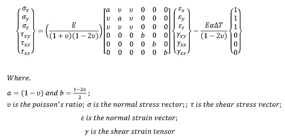

For an isotropic solid, matrix form of Hooke’s Law is:
