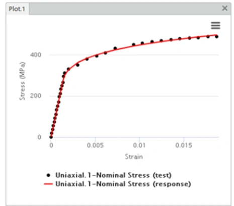

The Calibrations run using ABAQUS material models:
  • ABAQUS possesses powerful capabilities to model advanced non-linear material models.
  • These material models can be evaluated quickly without running a full finite element analysis. (FEA).
  • Material models are generally represented by equations.

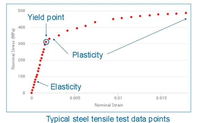

    Uniaxial Monotonic Tension Test
    A monotonic tension test is completed using a specimen designed to enforce uniaxial conditions at the center.
  • The tensile force is gradually applied and elongation is measured (from which strain is calculated)
  • Data points are recorded in terms of stress and strain and can be used to fit a mathematical model to the data.
  • Quantities such as UTS and percent reduction in area (RA) can be calculated
  • For steel at room temperature, the response is typically elastic until some yield point
  • A loss of stiffness happens after the yield point, indicating that plasticity contributes to the nominal strain
  • Any unloading after significant plasticity could lead to permanent deformation.

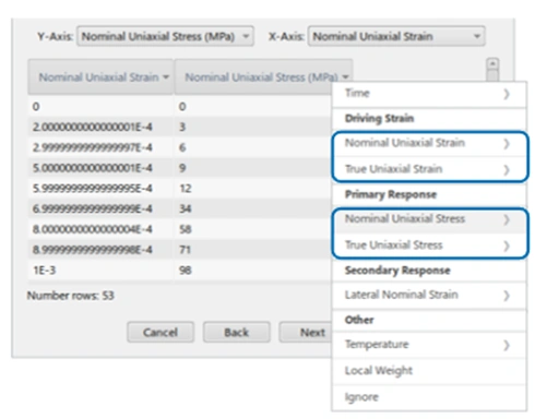

    Stress and Strain measures
  • One usually imports nominal stress-strain data because this is how the data are typically measured.
  • The material Calibration app will automatically apply all of the unit conversions necessary while executing the calibration.
  • In the app, test and response data are plotted in nominal stress and strain measures, regardless of the imported Measures.
  • Exported/saved materials are always stored in the measure by the solver.
    • For instance, true stress And true strain are used to define a tabular plasticity model.
