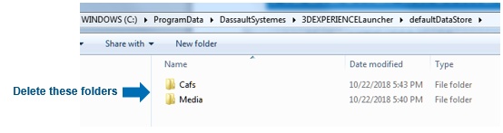

The first cache is where the files from the 3DEXPERIENCE Launcher reside. While these files do not typically generate errors when using 3DEXPERIENCE, they can become quite large. As these files are most typically located on the same drive as the Windows installation, they can cause some very significant IT issues. The cached files are located in
C:\\ProgramData\\DassaultSystemes\\3DEXPERIENCELauncher\\defaultDataStore
To clear these files, you should
  1. Ensure that 3DEXPERIENCE is closed.
  2. Open Windows Explorer and navigate to C:\\ProgramData\\DassaultSystemes\\3DEXPERIENCELauncher\\defaultDataStore
  3. Delete the Cafs and Media folders (see below).

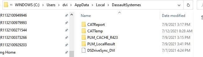

The other cached files can cause a number of severe errors when using 3DEXPERIENCE. These can include errors associated with CAD and simulation apps as well as issues saving and importing data.
To clear this cache:
  2. Open Windows Explorer and navigate to C:\\Users\\username\\AppData\\Local\\DassaultSystemes
  3. Delete all the folders in this location (see below).

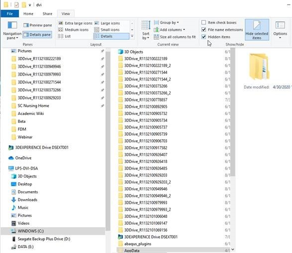

Also note, the AppData folder may be hidden. To make it visible, click on the View tab of Windows Explorer and toggle on Hidden Items (see below).
