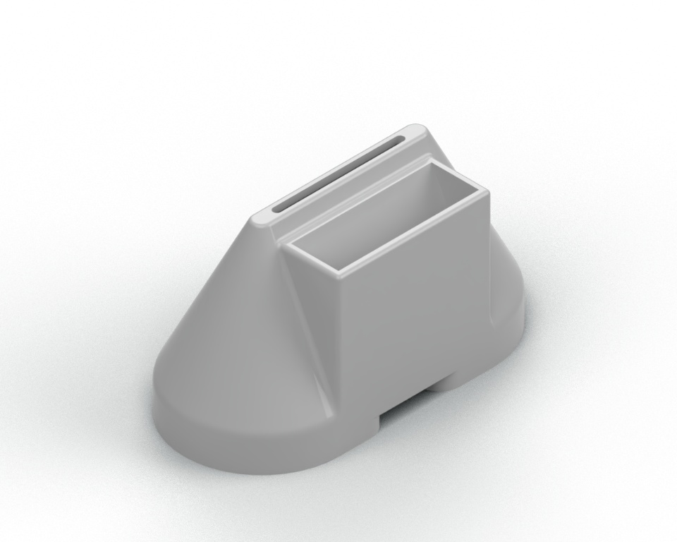

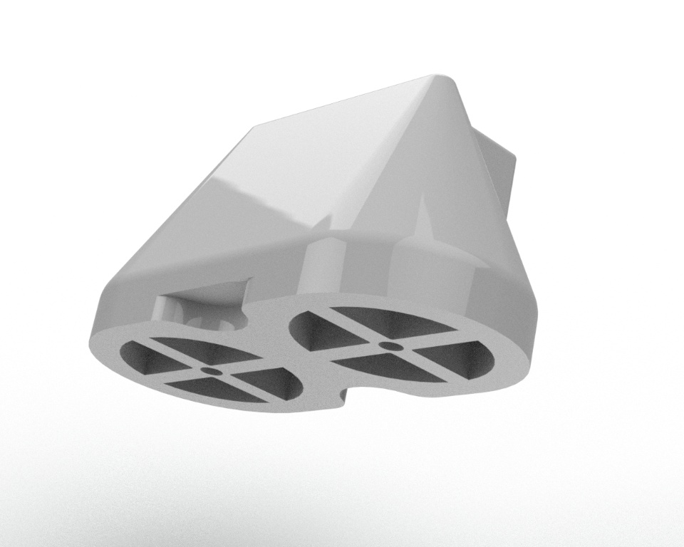

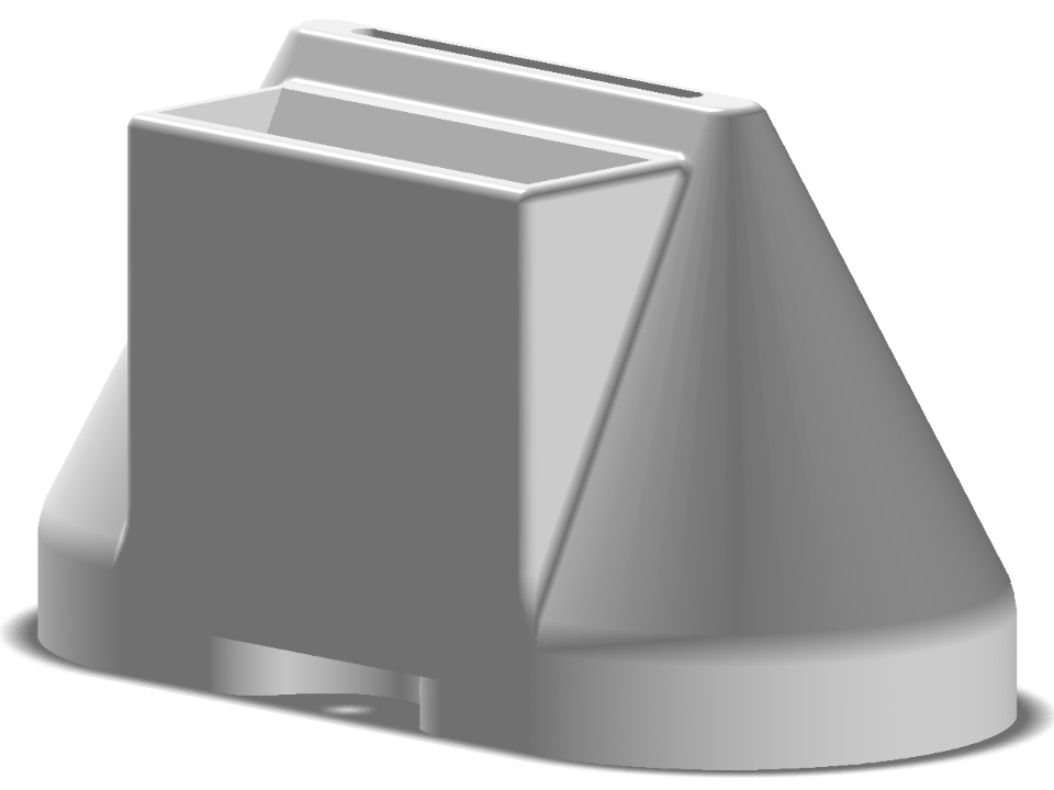

Hello, I actually decided on this idea after a certain period of time. I found 2 brushless motors being thrown in the trash and brought them home. I had 2 drone propellers in my house. After I renewed the wiring of the motor, I noticed that they were working really well. Already when I installed the propellers, I tested it with a thin battery of 1.5 V and it had a really refreshing effect, I immediately thought and a 3D Model appeared in my mind, I determined the measurements in some parts of this model (diameter of the motor, width of the propeller, etc.) with a pen and paper. . And I started to design the 3D visual in my mind. Then I did the flow analysis because I was wondering what the flow inside would look like. The flow rate was sufficient for me. There was a cooling of 5-6 degrees and this was quite enough for ADANA between 40 and 36 degrees. In the last process, I asked my teammate @TN for help with 3D Printer and he produced it for me. I was really happy when I saw it working after I assembled it. I picked up a model that I was thinking instantly, and it was a really great feeling. In this project I made using 3DEXPERIENCE, I used xDesign as 3D modeling, it is a great tool for this kind of modeling and it is improving day by day.

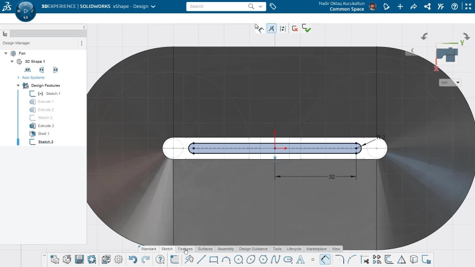

Design video
During the design, I made my design easily with xDesign's unique and user-friendly interface. The commands I used were cloud-based and it was very fast despite my poor internet quality. xDesign you are really cool.

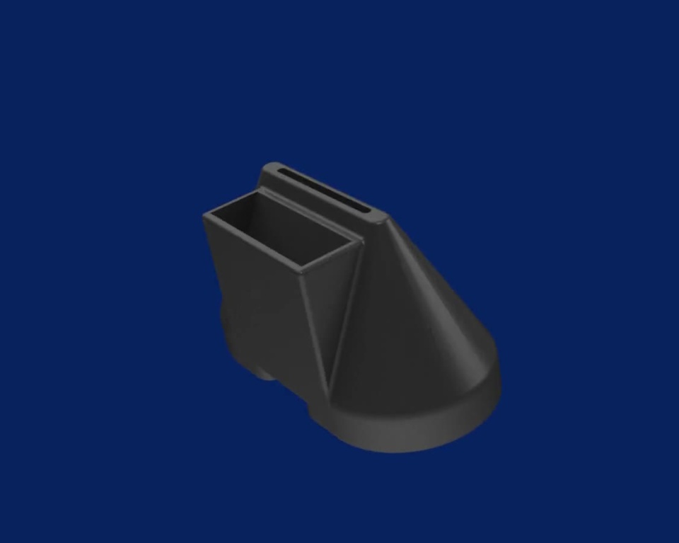

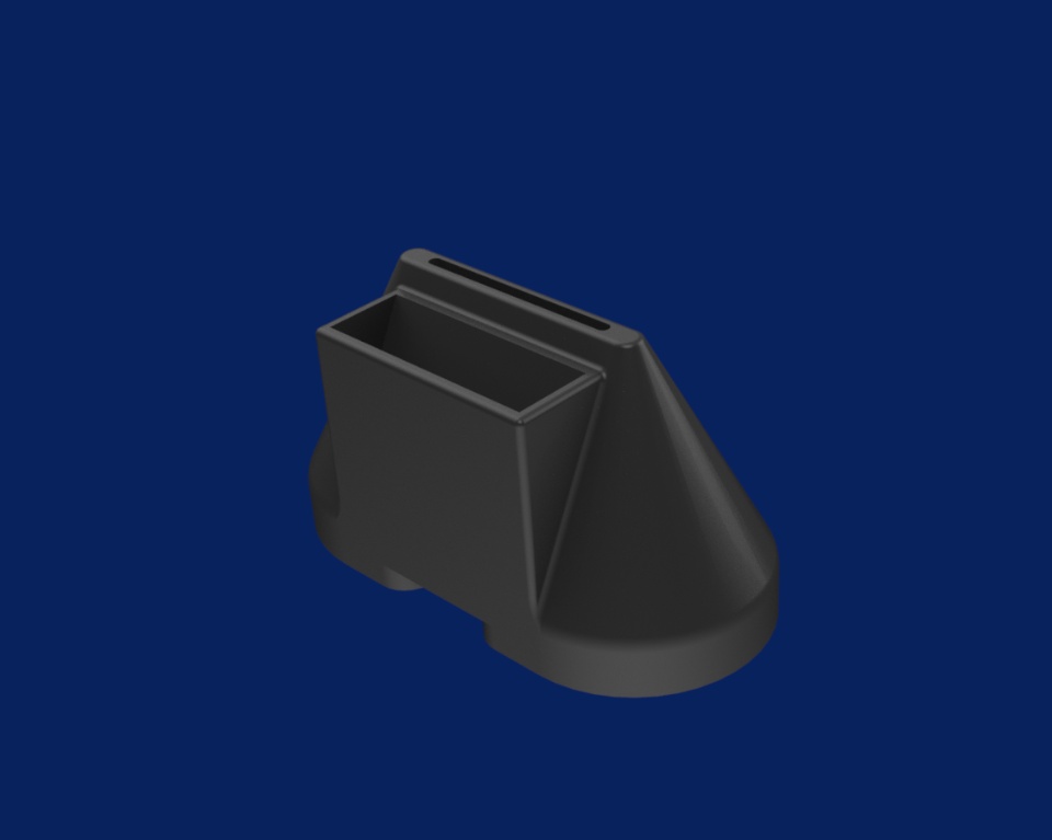

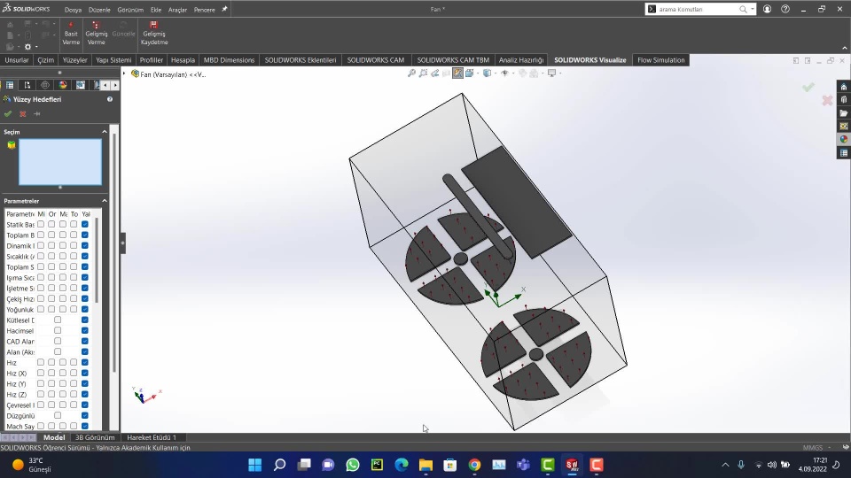

Analysis Video
I can't analyze professionally, it's been a few days since I found out. Here, the pressure, velocity and temperature values were sufficient for me. and I did it to see the inner flow.

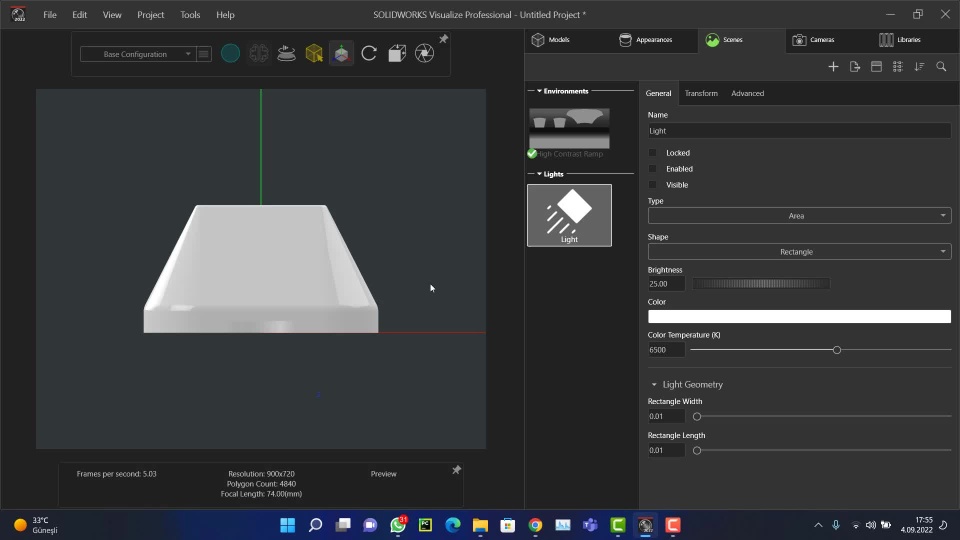

SOLIDWORKS Visualize video
Needless to say, as a render, you see, SOLIDWORKS Visualize is really practical and more practical than other rendering programs in terms of ease of use.
