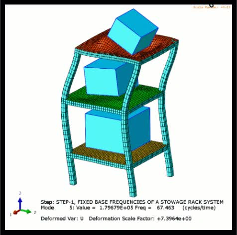

1. Natural Frequency Extraction (Eigenvalue Analysis)
  • Used to determine the natural frequencies and mode shapes of a structure.
  • Conducted using the FREQUENCY step in Abaqus.
  • Methods:
    • Lanczos (default, best for large models)
    • Subspace iteration (efficient for small models)
    • AMS (Automatic Multi-level Substructuring, for very large models)

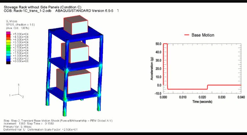

2. Mode-Based Dynamic Analyses
  • Utilizes eigenmodes extracted from frequency analysis to reduce computational effort.
  • Modal Transient Analysis (STEADY STATE DYNAMICS, TRANSIENT FREQ.)
    • Solves dynamic equations using mode superposition.
    • Suitable for systems where damping is proportional.
    • Computationally efficient compared to direct transient analysis.
  • Steady-State Dynamics
    • Used for harmonic loading (e.g., sinusoidal loads at different frequencies).
    • Employs frequency domain analysis.
  • Response Spectrum Analysis
    • Used for seismic or shock load evaluations.
    • Computes maximum response based on predefined response spectra.
