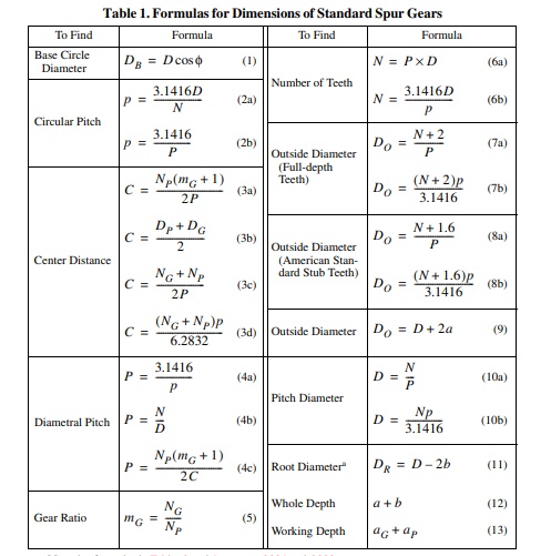

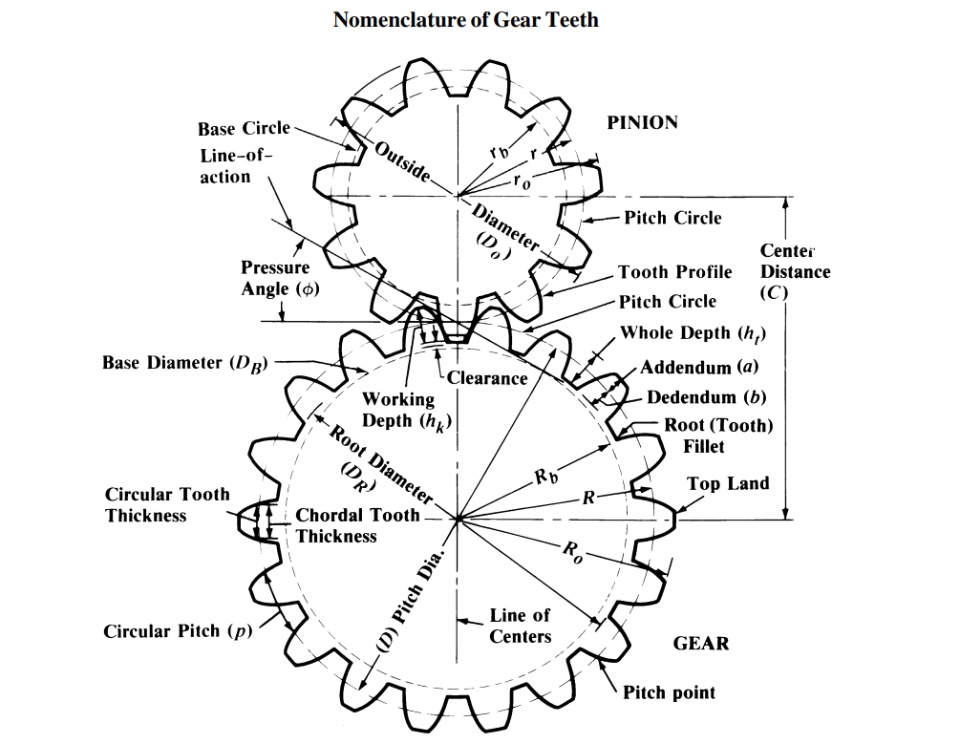

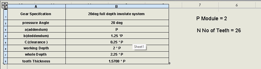

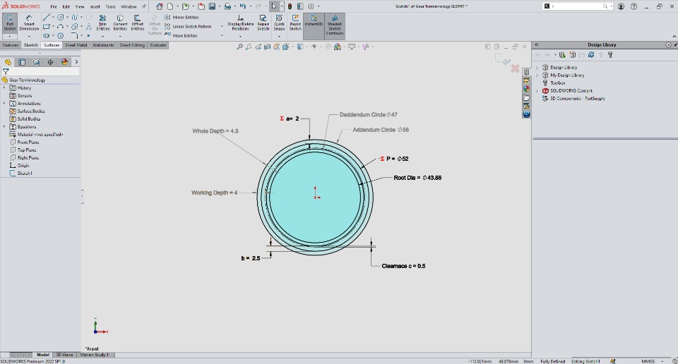

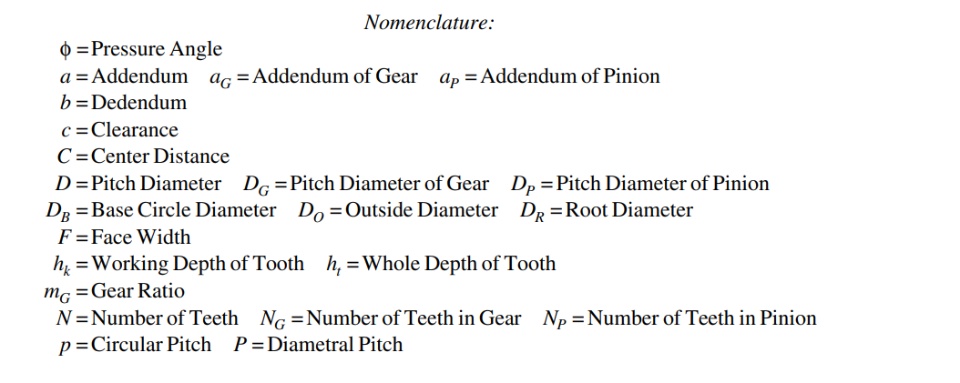

while designing an spur gear I have learned most of term specification , Terminology and formula for equation
for designing an gear its most important to understand about gear terminology and specification
if you know about module , no of teeth and pressure angle ,then you can easily find out an other specification and values of gear and tooth profile specification
