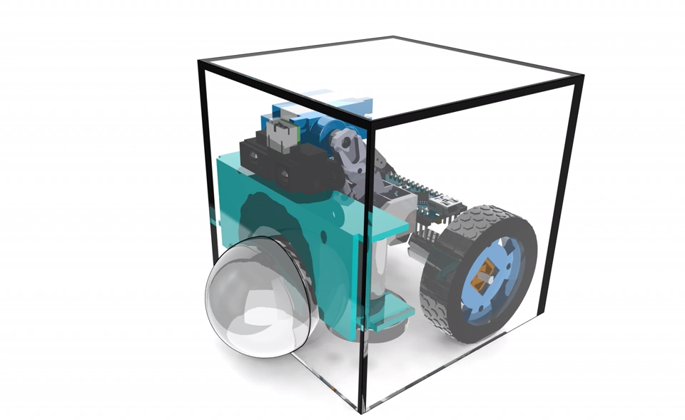

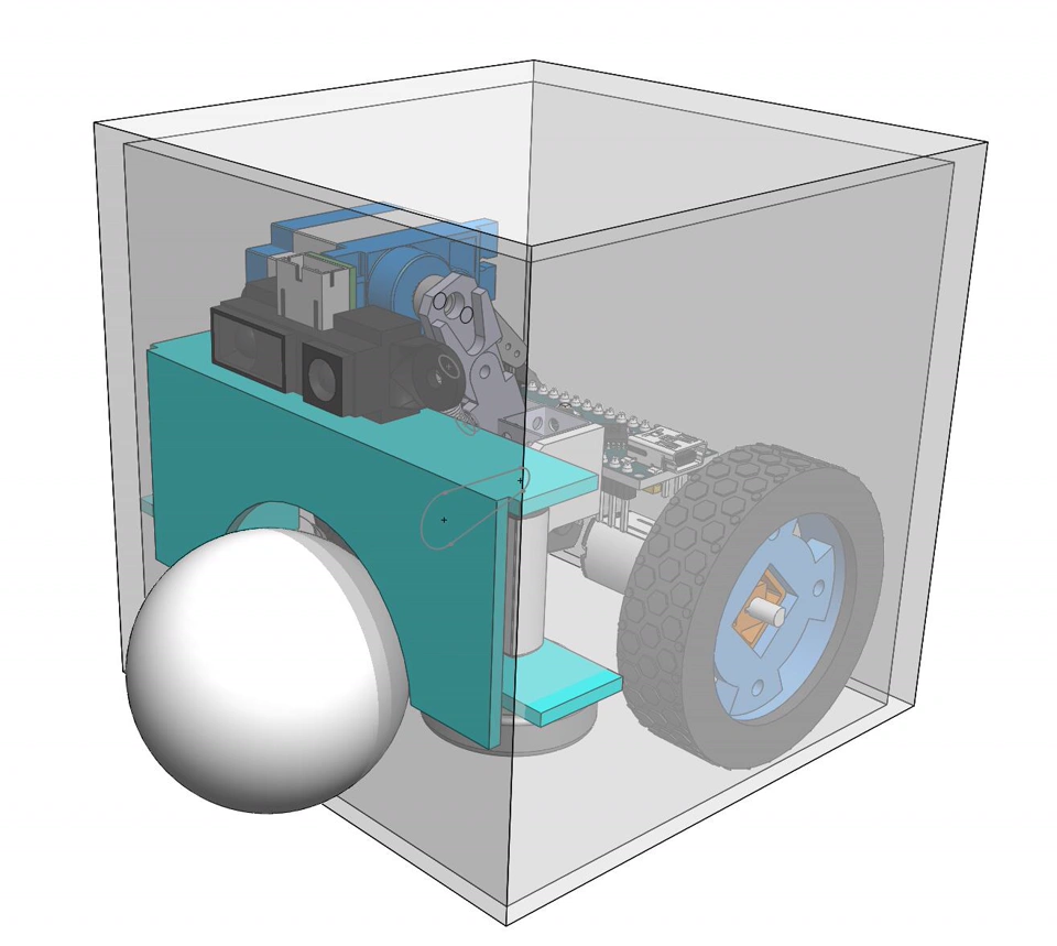

Engineering Behind the Smart Football Robot
Core Innovation: The Hybrid Launch System
The robot's defining feature is the combination of two independent mechanisms that work in concert to produce complex ball motion — something no single mechanism alone can achieve.

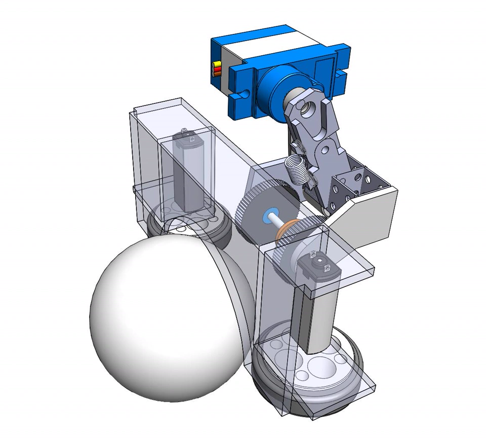

1. Differential Speed Launch Wheels (Horizontal Axis)
How it works
Two rubber-coated wheels are mounted side by side on a horizontal axis, both in contact with the ball simultaneously. Each wheel is driven by an independent DC motor, allowing them to spin at different angular velocities (ω).
The Physics — Magnus Effect
When the two wheels spin at different speeds (ωA ≠ ωB), they impart asymmetric rotational energy onto the ball. As the ball flies through the air, this spin interacts with the surrounding airflow:
  • Air on the faster-spinning side accelerates → lower pressure
  • Air on the slower side decelerates → higher pressure
  • This pressure differential generates a lateral aerodynamic force (Magnus Force):
F_Magnus = 4π² · ρ · r³ · ω · v
Where:
  • ρ = air density
  • r = ball radius
  • ω = spin rate
  • v = ball velocity
Shot types produced
ωA vs ωBEffect
ωA = ωBStraight shot, no curve
ωA > ωBBall curves left
ωA < ωBBall curves right
Both highTopspin — ball dips faster
Both reversedBackspin — ball floats longer

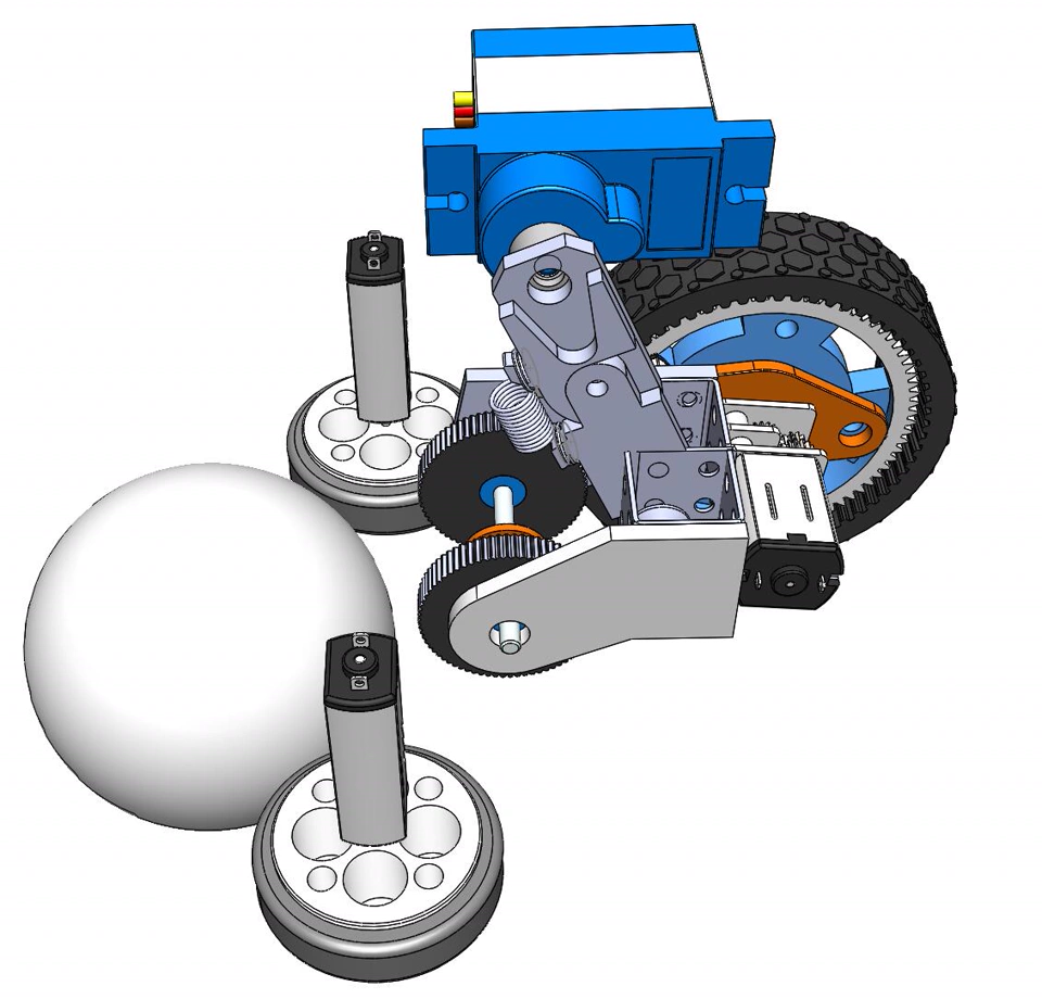

2. Vertical Servo Kicker (Spring-Loaded Arm)
How it works
A servo motor drives a crank-arm connected to a spring-loaded kicker. When actuated:
  1. The servo rotates, compressing the return spring
  2. On release, the spring energy drives the arm forward and upward
  3. The kicker strikes the ball with a vertical impulse component
The Physics
The launch angle θ is directly controlled by the servo rotation angle:
  • Low θ → ground pass or flat shot
  • High θ → lofted ball, crosses, chip shots
The kinetic energy stored in the spring follows:
E = ½ · k · x²
Where k is spring stiffness and x is compression distance — giving a consistent, repeatable kick force regardless of ball position variation.

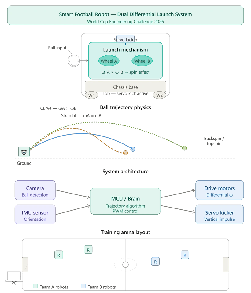

3. The Combined Effect — Why It's Powerful
When both systems activate simultaneously, the results multiply:
  • A lob with topspin → ball rises then dips sharply at the target
  • A curved lob → ball bends in the air while also rising
  • A low backspin shot → ball skids along the ground with deceptive float
These are the same shot types that make professional human players dangerous — now achievable autonomously by a robot.
