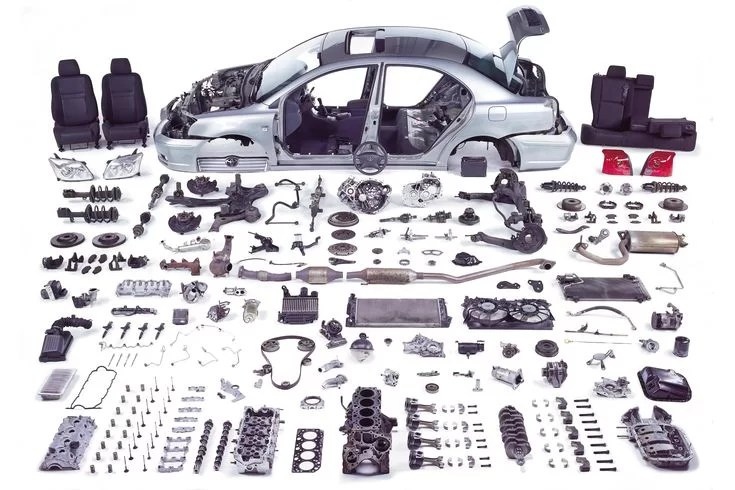

Here's an example of how the terms "product," "component," and "part" might be used in CATIA:
Product: In CATIA, a "product" generally refers to an entire assembly or system made up of multiple components. For example, if you were designing a car, the "product" might be the entire vehicle, including the chassis, engine, wheels, seats, and so on. In CATIA, you would typically create a new product file to house all of the components that make up the car.
Component: A "component" in CATIA refers to a sub-assembly or part that makes up part of the larger product. Continuing with the car example, some components might include the engine, transmission, suspension system, and so on. Each of these components would be designed as a separate file within the larger product file.
Part: In CATIA, a "part" typically refers to a single physical object that will be manufactured or produced. For example, a part might be a bolt, a gear, a bracket, or a body panel. Each part would typically be designed as a separate file within the component or product file.
