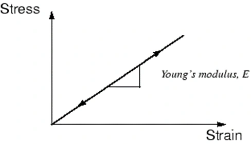

Many metals have approximate linear elastic behavior at low strain magnitudes, and the stiffness of the material, known as its Young's modulus or elastic modulus, is constant.
Figure 1. Stress-strain behavior for a linear elastic material, such as steel, at small strains.
