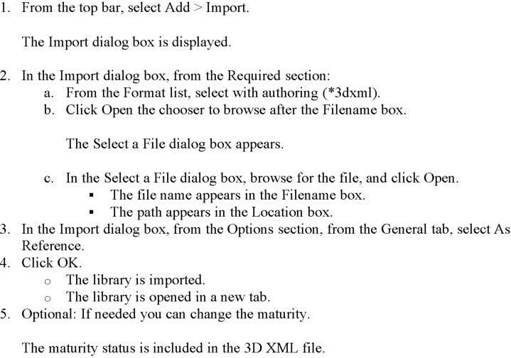

  • To update installed libraries, the process is identical.

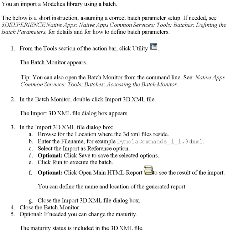

  • In a batch mode, do not forget to select the Import as Reference option. If you do not select this option, the imported libraries are duplicated.
  • Administrators should update the imported libraries every time a new version is installed. This ensures that users access the last version of these libraries.
 Import a Single Library with a Command

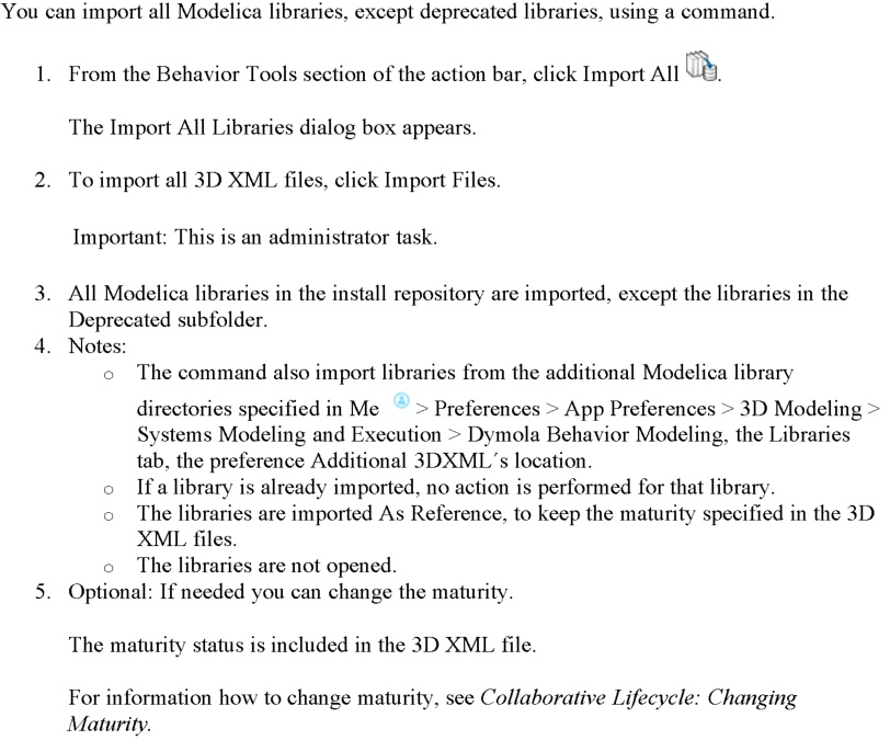

Import All Libraries with a Command
 Import with Batch
