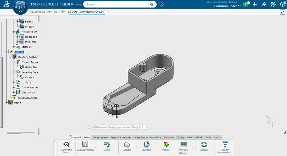

🔹 1. Prepare parameters in CATIA (3D Part Design)🔎​
Before starting the study, it’s essential to define your design parameters in CATIA Part Design.
These may include dimensions such as thickness, radii, lengths, or angles, which will later be used as design variables.
You also need to have an initial simulation configured in SIMULIA, which will serve as your reference setup.
🔹 2. Open the Parametric Design Study app​
Once your model and initial simulation are ready, open the Parametric Design Study app in SIMULIA.
From there, create a new Design Improvement Study, which lets you evaluate how your defined parameters influence your model’s performance.

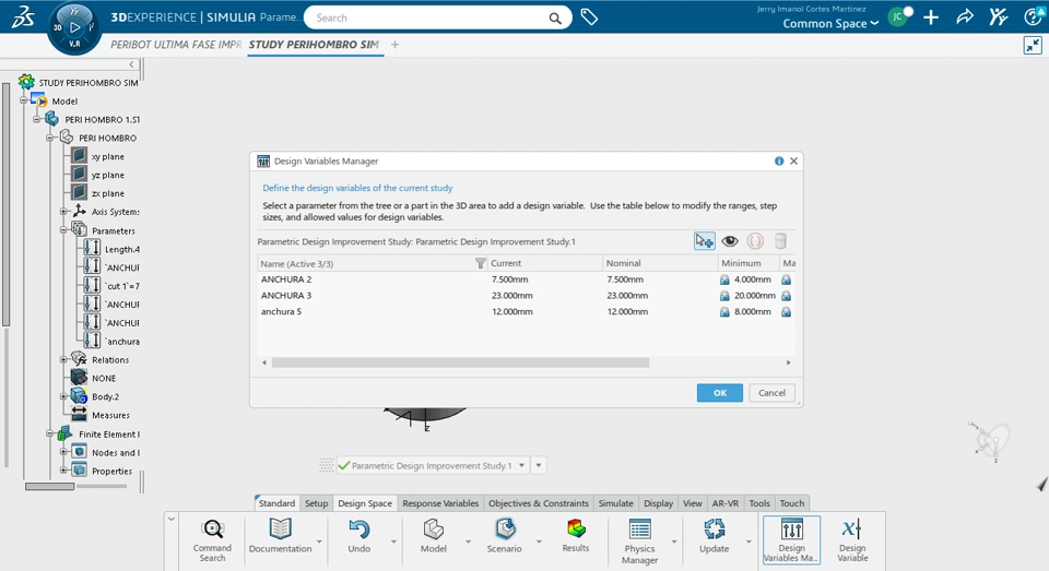

🔹 3. Define design variables​❗
In the Design Variables Manager, add the parameters you created in CATIA.
For each variable, define a Step Size, which is the increment used in the analysis.
In my case, I set a 1 mm step size for each iteration to evaluate small, precise dimensional changes in the elbow.

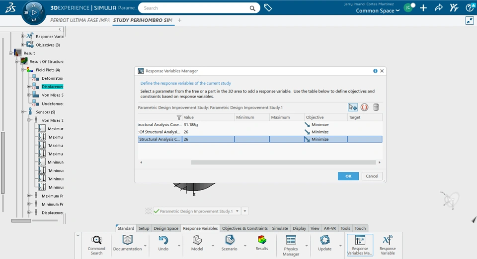

🔹 4. Set response variables
In the Response Variables Manager, select the performance objectives that you want to track throughout the study.
Based on my initial simulation, I selected:
  • Mass,
  • Von Mises stress,
  • Total displacement.
These outputs helped me identify the best trade-off between lightweight design, strength, and stiffness.

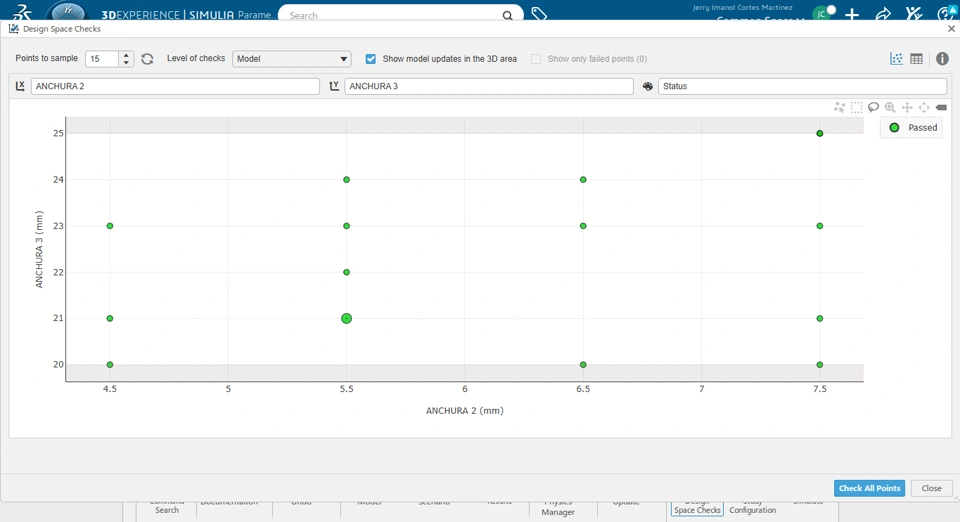

🔹 5. Verify the design space
Before running the study, it’s important to use the Design Space Check tool.
This feature validates whether each design point can generate a valid model, mesh, and scenario for the analysis.
I configured 15 design space checks, which provided enough data points to detect trends without overloading the computation.

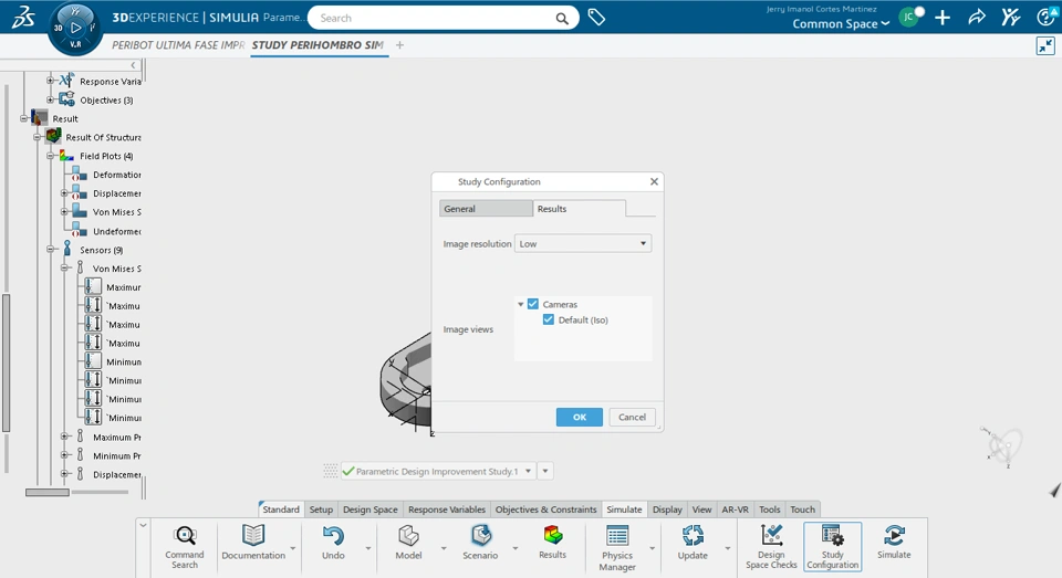

🔹 6. Configure the study and run the simulation
In the Study Configuration section, I set the Sample Mode to Guided and adjusted the image resolution to Low to speed up computation time.
Once everything was configured, I launched the simulation — the system automatically ran each iteration by varying the defined parameters.

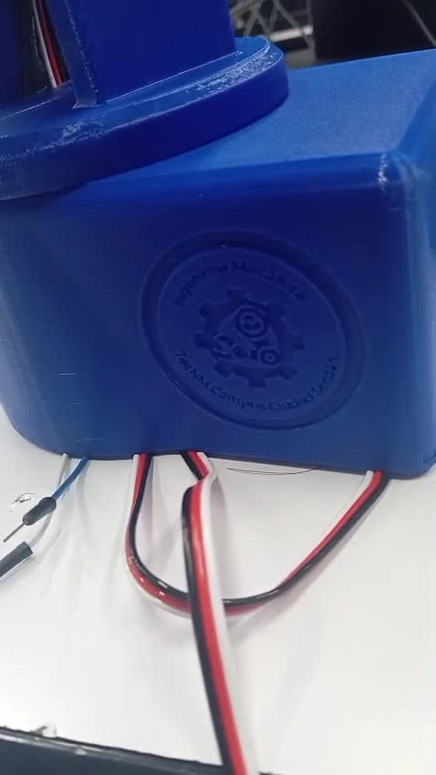

✅ Final Result✅
The final outcome was a functional, visually clean, and 3D-print-optimized elbow that demonstrates how a digital workflow — from parametric modeling in CATIA to advanced simulation in SIMULIA — can enhance both performance and sustainability in design.
