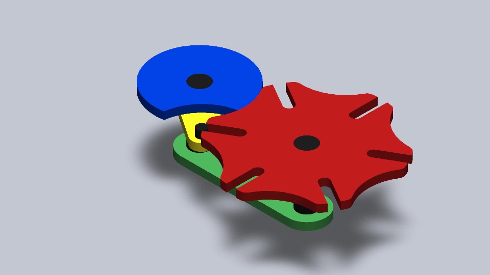

​​​​​​                             ​Animation of the Geneva Mechanism
Construction of the Mechanism
In Geneva drive, there are two wheels: the driving wheel and the driven wheel. The driving wheel has a pin and a little more than a semi-circular disc that is elevated. The driven wheel has 4, 6, or more slots in which the pin of the driving wheel passes and rotates the driven wheel to an angle depending upon the number of slots. If it has 4 slots, it will be rotated 90 degrees in one step, and if it has 6 slots, it will be rotated 60 degrees in one step. The circular elevated disc is used to lock the driven wheel after each step.

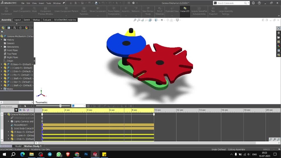

                Animation of the Mechanism using SOLIDWORKS Motion Analysis
