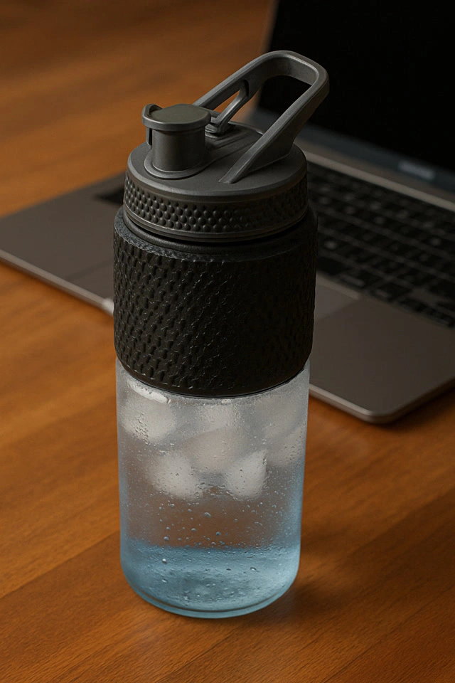

With proper prompts, ChatGPT also cranks out rich variations quickly, such as a bottle filled with icy water😉.

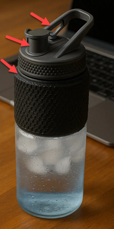

What about the ice water variation?
As shown below, it doesn't stay consistent with the prior AI image or the CAD design because it's a new probabilistic guess. For instance, now the middle glass segment is completely gone.

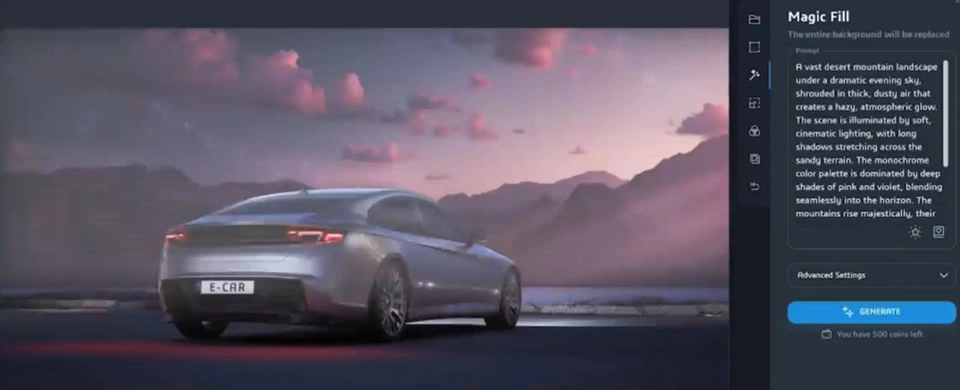

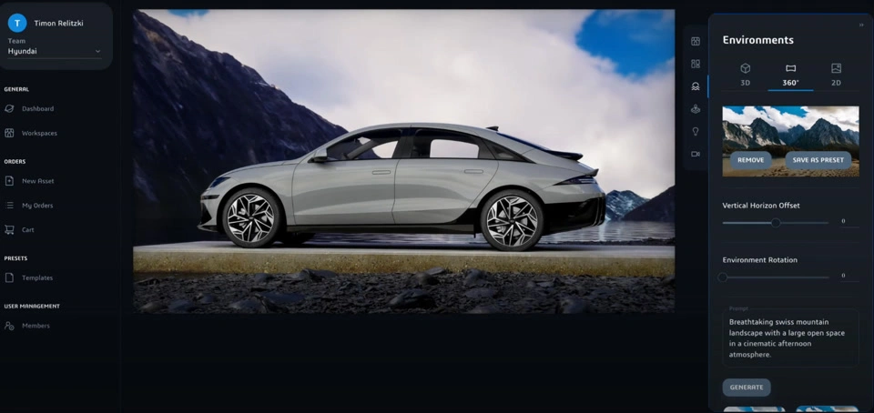

Another synergy between AI and 3D CAD has been implemented by 3DEXCITE as featured in this keynote at the NVIDIA conference.
Here the probabilistic AI creates beautiful 3D, 360, or 2D environments per the the panel prompts on the right, for the deterministic vehicle at the center. The environments can be inspirational, and less accurate, whereas the car (or any product) stays authentic.
Actually when I was asking whether it's ok to put some dirt on the tires to make it look more realistic, our team shared that OEMs are super strict on the car appearances, so the answer is NO. You get the point😉
