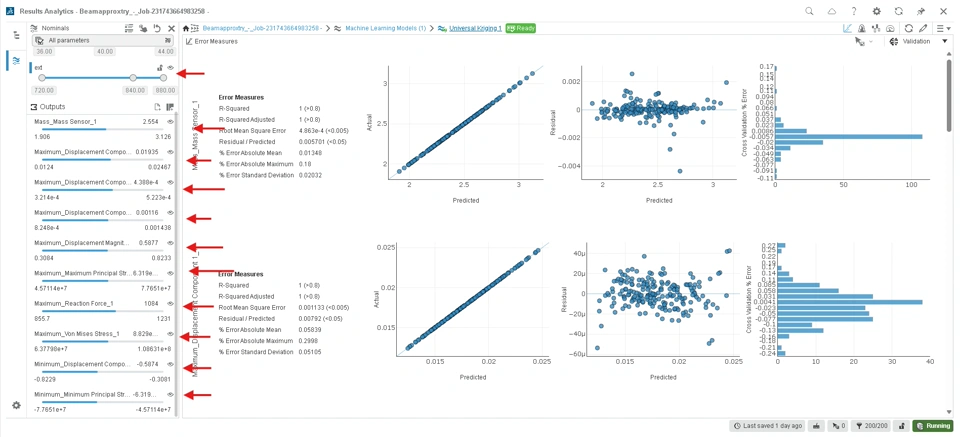

Parameter variations yield real-time outputs derived from the model's learned representations

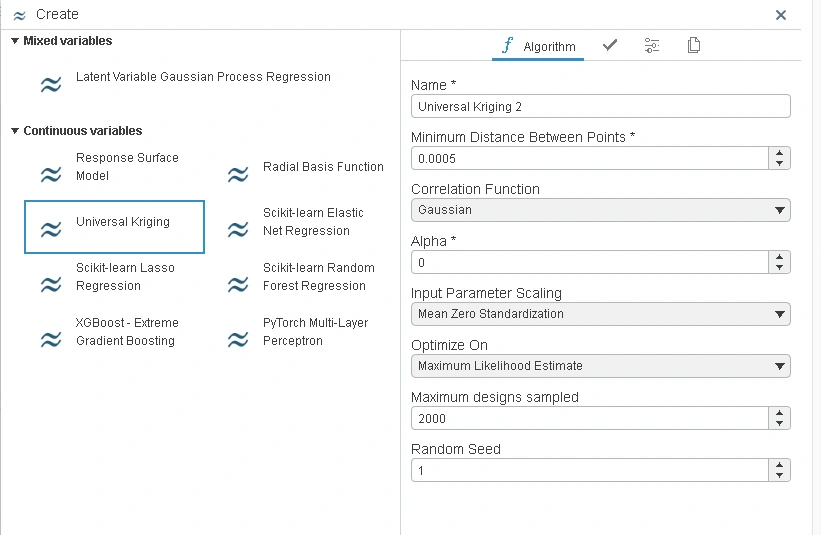

Universal Kriging
Kriging is a sophisticated statistical interpolation method. Think of it as an intelligent "connect-the-dots" that understands the spatial relationship between your data points to make highly accurate predictions, even with sparse data.
  • Best For:
    • Problems where the data is spatially correlated (i.e., points close to each other are expected to have similar results).
    • Creating a very accurate model from a small number of data points.
  • Pros ✅: Very flexible. It can be set up to pass exactly through your data points (exact interpolation) or to smooth out noise in the data (inexact interpolation).
  • Cons ❌: The model-building process can be very slow and computationally expensive, especially as the number of data points or inputs increases.
