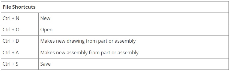

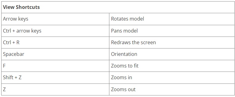

3)SOLIDWORKS Keyboard Shortcuts :
I love my smartphone and my tablet, but I still feel that I work faster on my desktop computer because of keyboard shortcuts. There are many different ways to bring up commands in SOLIDWORKS, but the use of keyboard shortcuts help me tremendously.
